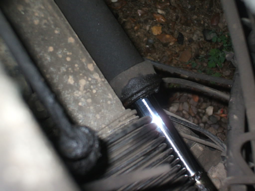

Hi - sorry I can't do digital on this computer. But as I said, the photo above is exactly right and what I have. I am now told that the pipe DOES go to the ram gaiter. As I wasn't looking for a gaiter takeoff I drove straight up the ramps just now and leapt underneath with a torch hoping to see something. Nuffink. It must be on the topside somewhere...Did a ten mile test run today and nothing popped off or leaked. Apparently this ram takeoff won't dribble much normally so this will have to wait until the weather improves (just had some lightning) - any ideas where on the gaiter the pipe goes?? i.e. left side or right side, there are two gaiters there, and on top, in front etc...? If I look at the engineless scrappy at the weekend it might give a clue.

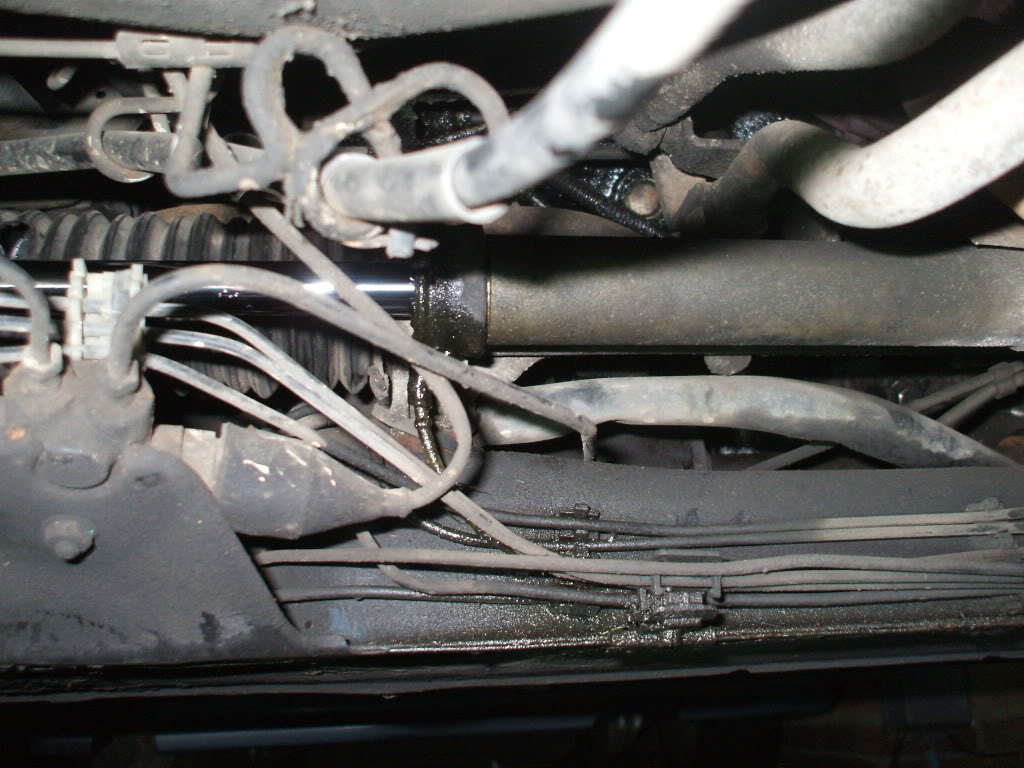

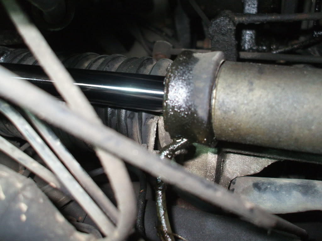

Hi Tim
Acouple of pictures of a steering ram taken from underneath on the n/s of the car,as you can see mine has a slight leak.

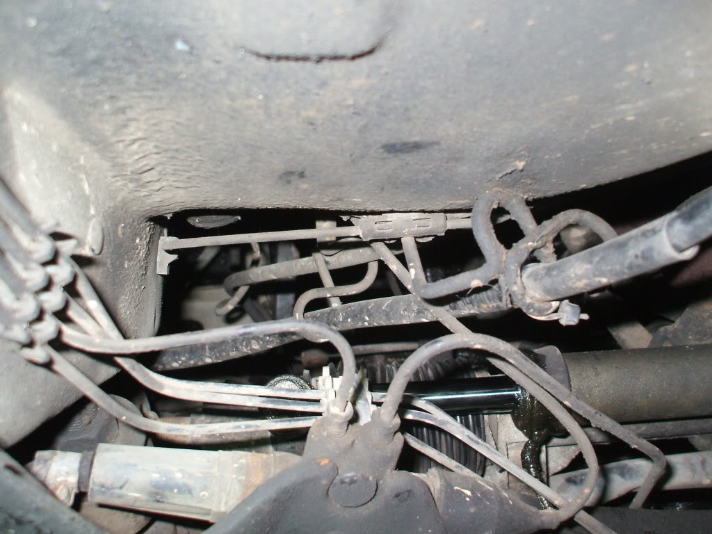

And one taken from above the gearbox
hope this helps.
