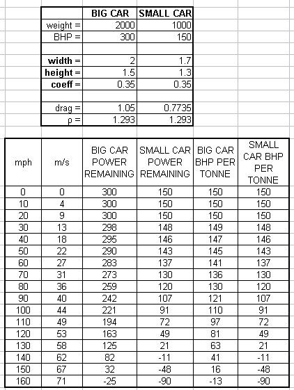

I remember seeing an acceleration curve of a Porsche in a magazine a loooong time ago (they'd put an accelerometer in the passenger seat) and from memory it looked something like this (speed is vertical and time is horizontal)
Here is what we both agree on though, which is that the heavier car is quicker once drag comes into effect (on a raceway on the moon, both cars keep accelerting side-by-side for ever until the raceway ends. or the fuel/air supply runs out)
On the earth, the power to overcome drag, is
Drag power P = ½ ? C A v³
where
? is the air density in kg/m³ = 1.293 at STP
C is the drag co-efficient (dimensionless)
A is the cross-sectional area in m²
v is the velocity in m/s
P is in Watts (kg m²/s³)
I just hacked this into a spreadsheet to demonstrate the effect that drag starts to have
EDIT: I just realised, on the moon, the big car still wins, because the wheels on the smaller (lighter) car will start to lose traction with the surface as it starts to lift off due to "centrifugal" force. Eventually the bigger (heavier) car will too, but it will be travelling faster and will be further ahead. F**k knows how they're going to stop :lol:

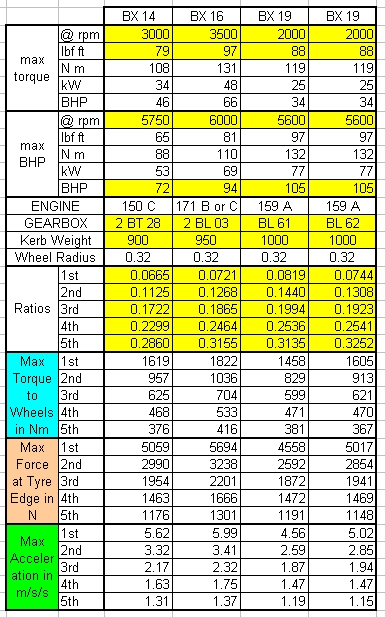

Here is how the gearing affects the acceleration.
All the figures in yellow are from the Book of Lies
From the max torques I've worked out the BHP at that rpm.
From the max BHP I've worked out the Torque at that rpm.
I used the Max Engine Torques in Nm along with the gear ratios to work out the Max Wheel Torqques. I've then used the wheel radius to work out the Force in N. From that I've given the peak acceleration.
Note however that the Book of Lies seems to have the wrong max Torques for the 1.9 engine.

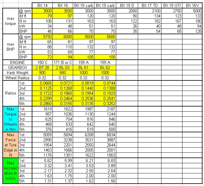

They have,
Petrol: 19TZS: 120 lb/ft@3000, 19GTi (8v): 123 ft/lbs @ 2750, 16v 133@5000
Diesel 19: 90@2000, Turbo diesel: 134@2100

/\ If you've got the gear ratios I'll do a complete table of the whole BX fleet

If I get all the gear ratios I can quickly complete the table, then I will be able to construct some approximate acceleration curves for each BX
