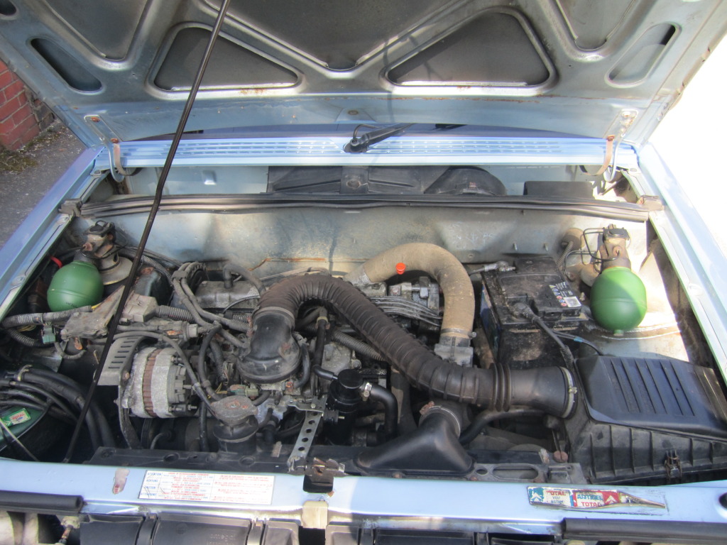

Ok, so here are some pictures under the bonnet and a couple of door sills where rust has started, I'd like a bit of advice on dealing with the rust, it seems very minimal at present but of course I know only too well how it can spread. There may also be some spots underneath but I haven't had a chance to look yet.

looks like the same thing I had , the origional bobbin that supports the oil filler thingy has given out and theyve bodged a repair, mines held up by speaker wire at the moment so your bodge is infinately better ,
Re: Vampire Diaries
Hi Jane , using the picture above the bobbin should fit into a threaded hole that is on a the inlet manifold ( its part of the casting and sticks out 90 degrees from the manifold )under the coil then the oil filler should be fitted to the bobbin using the moulded in bracket shown bottom right of this picture and a nut and washer used to secure it, it should not be fitted using u shaped pipe holder at the front as yours has been .

As an aside, why do the small engined petrols have this, but the big ones don't? My oil filler/separator looks the same as micks picture but it just bolted straight onto the inlet manifold.
Re: Vampire Diaries
dont know Vanny but its a pita, the rubber is bonded to a metal plate on the stud and thats where they come apart, As you know from mine the bloody thing never tightens up properly causing the filler/seperator to crush the pipe beneath it.
Jane, in looking at your second picture, I think someone has put a black cable tie through where the stud if the bobbin should fit.
I can't really see that clearly on my picture, I'll have a look tomorrow to see what I can see. I will mention it when I take it in on Wednesday and maybe something sturdier can be done.

just below the bend in the pipe leaving the filler cap on the left , looks like they have put a cable tie through the bracket on the inlet manifold and through the hole in the seperator/filler which is exactly where the proper bobbin should be
