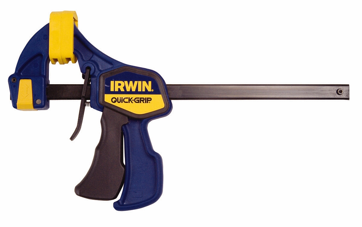

Hmmm, I might just have to do that. I've always just pushed the calipers back in with a set of Irwin Quick Grips;Geoffrey Gould wrote:Just needs someone with a caliper and camera and all will become clear, I hope.
