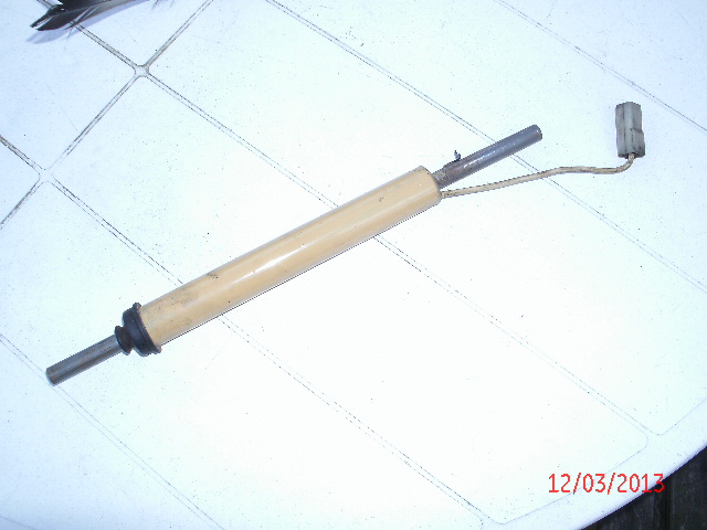

BX Badit wrote:
Neither have I seen the cigar ones you mention! Seen the ones down low on the back of the block, they often go porous too.
Here is the cigar shaped one, to date I have never been able to light if though.
The earth connection is missing.

Blimey, never seen that before!
