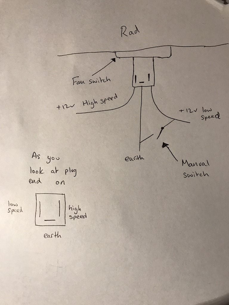

Right, fans work with the ignition on the second click!
What I found was:
1) Left connected to bottom of the U = both fans at slow speed = just as expected
2) Right connected to bottom of the U = N/S at full pelt = again as expected
3) Both connected to bottom of the U = O/S running really fast but only on its own, not both fans so this doesn't seem right with what I've read elsewhere
So it seems that I have a potentially dead rad fan switch as when the car over heated bringing both orange and red temp lights as well as the stop light I don't remember hearing the fans running at any speed. Having just had them running there is no way you could miss the noise so some lubing maybe in order.
So if I want a manual over-ride switch for say, just both fans at low speed, could I just connect a switch between the +12v on the left hand side of the U and the earth at the bottom of the U ?
Excuse my bad drawing and hand writing...
- Posts: 2029
- x 116
Re: cooling fans
I think you have got it right. What seems not to be working correctly is when both connectors are earthed at the same time you do not have the LH fan working at high speed as well. Your results do not make too much sense (on paper) as you can get both fans working at high speed but not together.
Are you sure you are earthing both sides simultaneously and getting only the RH fan ?
The rad connections behind the front grille are prone to corrosion so they are worth checking.
You can test your rad switch in a heated pan of water with a thermometer and electric meter to verify or otherwise its functioning. Its probably just as easy to just put another switch in though. Very little water escapes if you take the switch out from a full but unpressurised system.
As an aside my TD almost never has its fans running and I reckon that the TD rad is a bit over specified for the job.
If you really want an overide switch the what you suggest is correct but its arguably better to have a manual override to put the fans on at high speed, i.e. a two pole switch earthing both sides simultaneously. The fitted switching system is more than adeaquate IMO and I have never felt the need with a temp gauge fitted to have a manual switch as it always just works as it should and the gauge will tell you when the fans should be running and you can certainly hear and feel them at high speed. So vigilance here will pay off. Bear in mind that head gaskets always eem to fail anyway.

TizzyD
- Posts: 537
- Location: Bedfordshire
- x 10
Re: cooling fans
Thanks for the reply Jaba.
I'm sure I'm only getting both fans running simultaneously at low speed when I bridge the left terminal to ground. No other combination bring both fans on together but I'll check this again tomorrow to confirm.
Could it be possible that a relay has failed thus meaning that when both left and right terminals are grounded for high speed, it's not throwing the connection to bring on the second fan (N/S) but the circuit allows for it (N/S fan) to operate on its own when the right terminal is grounded ?
As for the manual switch, what I might do is extend on your idea and have a three way rocker switch so that position A (up) is low speed, position B (middle) is off and position C (down) is high speed. This would give me free reign over which fan speed I choose to manually over-ride too.
Would changing the fan switch run the risk of introducing air into the cooling system which would then need to be bled again ?

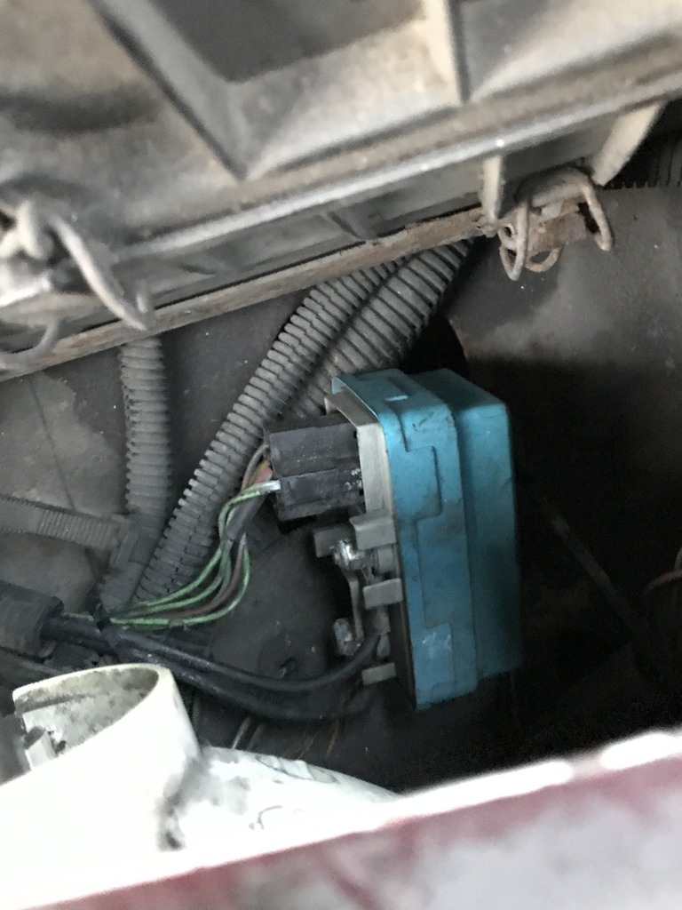

Also, does anyone know what this is behind the N/S headlight ?
Will look into fitting a new fan switch and I might go for one with a lower temperature setting to bring on low and high speeds sooner so it doesn't have chance to overheat.

Glad you have confirmed the high speed running.
That pic is of the glowplug preheat timer. It is usually protected by a sort of plastic bag.
