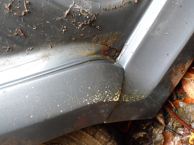

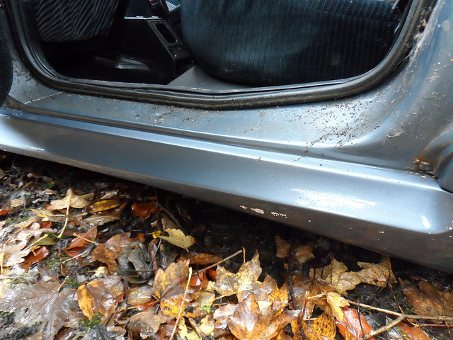

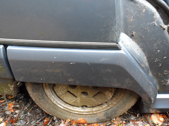

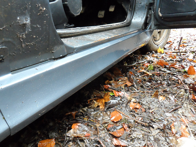

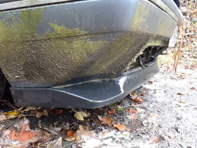

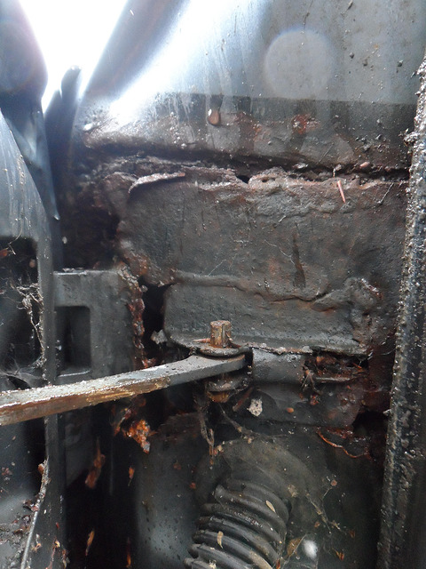

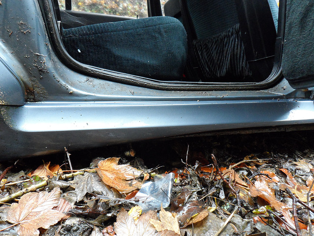

Any chance of some pictures of the rust ? What are the inner wings, washer bottles and rear door shuts like ? If you can get it running she might pump up...

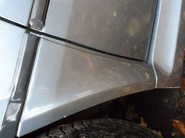

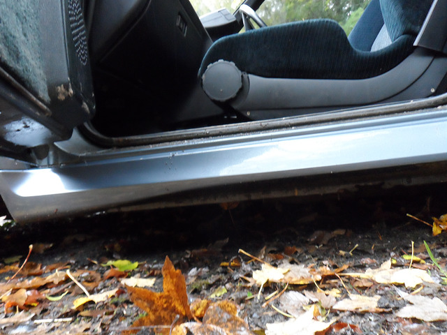

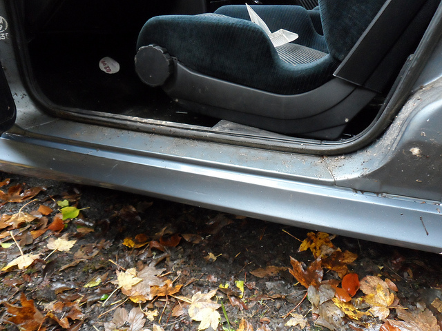

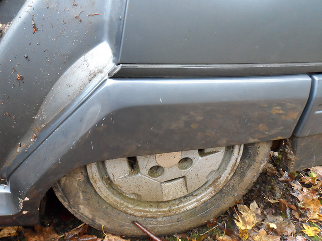

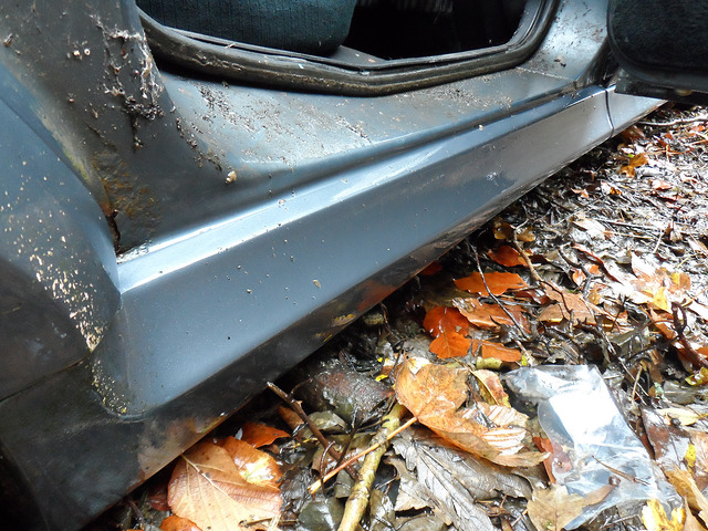

Every picture tells a story!

Not nice that

I reckon £400-£600, if you can show the shell isn't fecked in the usual places. The A-pillar looks bad, though it's not as hard to sort out as the rear subframe mounts, for example.16valver wrote:ok guys, as i'm getting so much grief. (not off you guys before any jumps to conclusions.)

Places to check for rust:
In the boot, especially in the shelf area on the inner side wall (driver's side).
Rear subframe front mounts - lift up back seat, remove plastic trim either side, peel back parcel tape, peer into oval holes looking at the two bolts/nuts. If it's really crusty in there, you have a bad day. This continues underneath into the rear jacking points and along the sills.
Pull the washer bottles out of the front scuttle tray and check underneath. Crud builds up and rot begins. If it's really bad you'll be able to see the wheel and the dashboard at the same time.
Inner wings under the bottle, both sides.
A-Pillars - if there's no bubbling either side or along the bottom edge of the windscreen, that's a good sign. The lower A-pilalrs may still need work, but it won't be horrific. If it's rusted either side of the screen then it will also be shot down below, and it could well be horrific!
If you have a car that's gone in all those places, it's either the grey ph2 16v I have here, or close to it. Dead, in other words. But If the subframe mounts are ok, and the A-pillars are managable, the shell might well live to fight another day.
