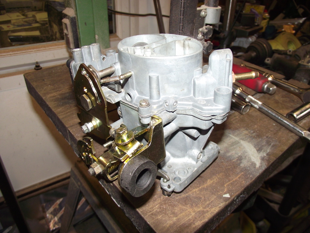

Carb will be coming off this week and going off for a strip and rebuild.

Be aware of the left hand thread (nut) holding the autochoke lever stuff. The nut should have a small groove around the middle of the hex outers. Otherwise fairly straight forward. AFAIK the early Haynes (brown cover 'til 87) has more section views of the carb than the later (shitty paper) blue one which covers to 94.....

New coil fitted, the problem persists, carbs off and ready to be rebuilt.
