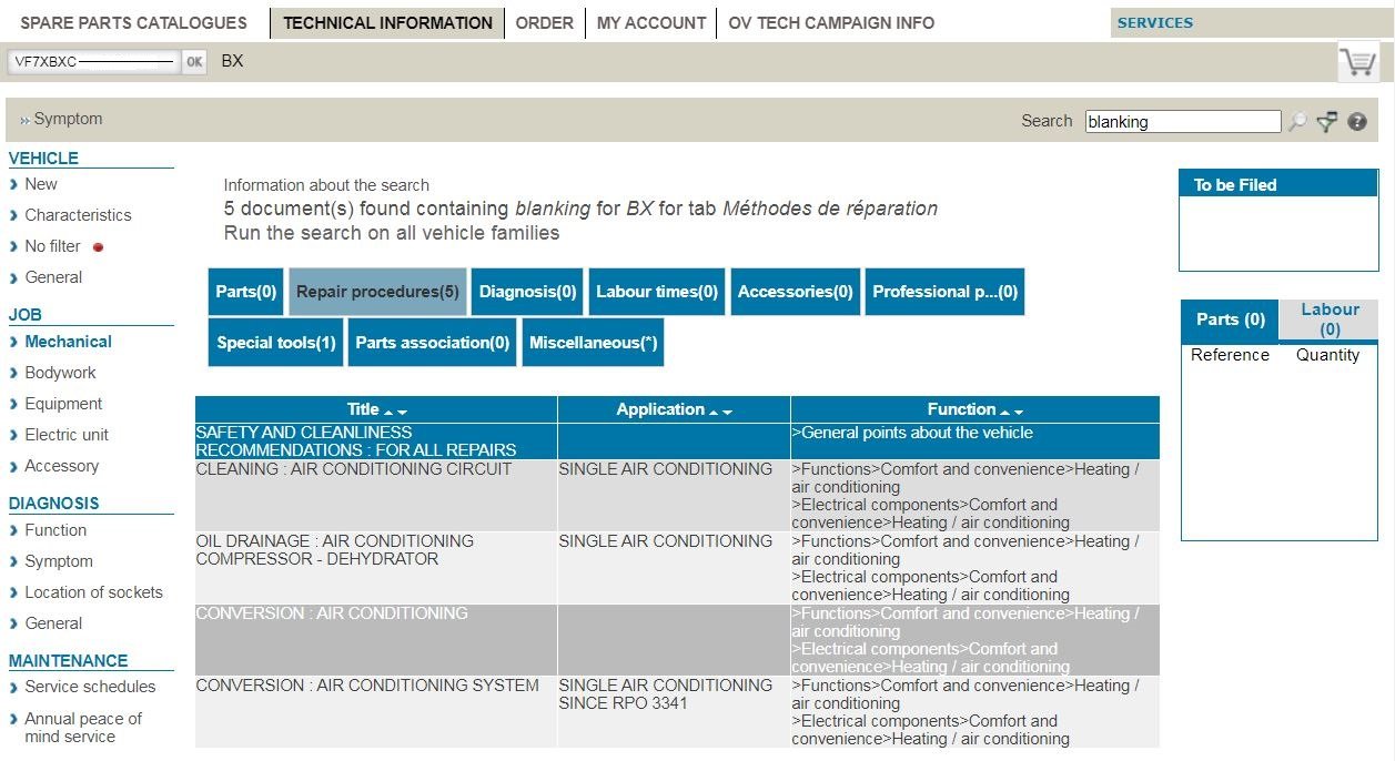

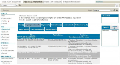

Conversion from R12 to R134a — Citroen documents
While browsing servicebox Parts for something quite unrelated, I found these four Service Documents.
They are detailed conversion instructions for converting from R12 to R134a — for AX, BX and CX.
By simply going into BX parts (not repair procedures, which I don't have a subscription for), and doing a Search for "blanking" (which is what I was looking for), you get this:
?click to enlarge .
The last four items are on-screen PDFs (which can be printed or saved), are are:
1 - Cleaning - air conditioning circuit
2 - Oil drainage - air conditioning compressor and dehydrator
3 - Conversion of air conditioning (up to RPO 3341)
4 - Conversion of air conditioning, single A/C, for RPO 3341?
The full documents are available to ServiceBox subscribers, via the page above.
EDIT
Don't get excited over this. There was/is obviously a bug in the SB system that intermittently allows some access to documentation, even when a subscription doesn't cover that. Most of the time, the site works normally.
?click to enlarge .

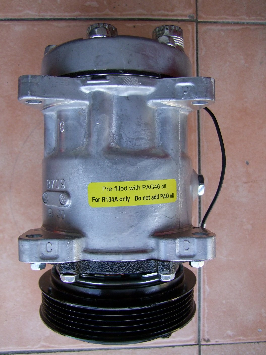

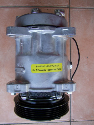

Sanden SD-709 compressor — PAO and PAG oils
Having just completed (July 2021) the conversion from R12 to R134a on the BX's factory fitment here, I thought I'd add a couple of bits of information to the very helpful guide above. It relates to the use of PAO68 oil in the system.
As well as the dryer, pressostat and O-rings (and eventually the expansion valve as well), the compressor needed to be replaced, as the original one had a significant leak. I went for a Nissens 89171 (from Mister Auto), which is actually a Sanden SD-709, spec'd for R134a. Sanden was the OE fitment on the BX, and it appears that most (all?) of the aftermarket replacements for the BX are Sanden, just re-badged:
. Sanden produce an excellent Service pdf for the compressors – see below.
The new compressor arrived with a clear warning that it was pre-filled with standard PAG46 oil, and that PAO oil should not be added:
Behr-Hella (Mahle) in their AC Compressor Oil pdf (below) make it clear that PAO and PAG oils are not completely miscible, and will separate out when left.
Even though the advice is to remove previous (PAG) oil from the system before switching to PAO, this is unlikely to be totally successful, and so a certain amount of mixing will happen.
Sanden are obviously not happy with significant mixing of the two oils, hence the yellow label, and the instruction in their Service document to use PAG46 oil.
I thought it worthwhile pointing this out.

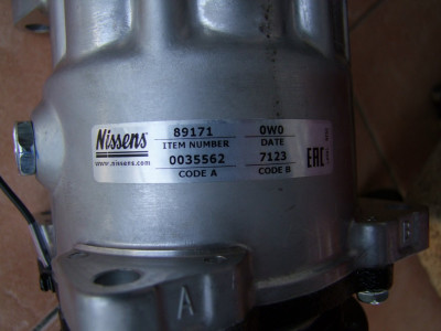

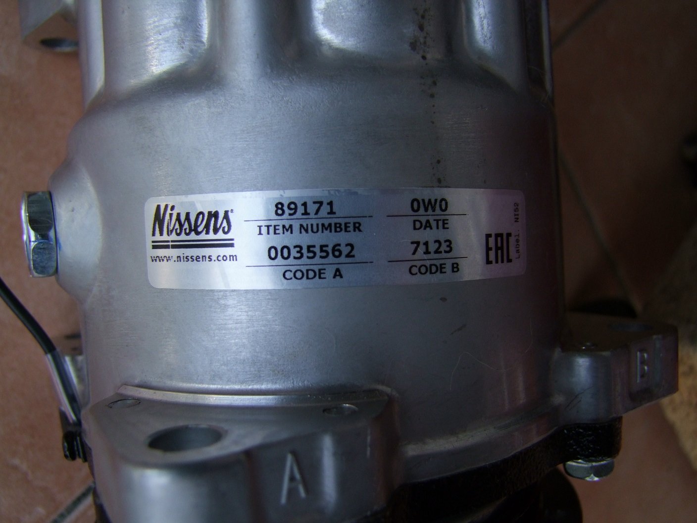

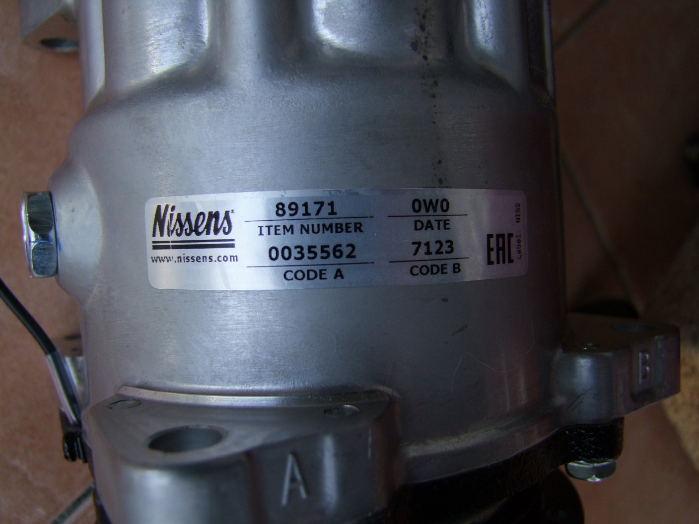

This information is very useful. I couldn't find anything specific for the BX when I had mine filled up last week, so I went off a generic chart, which stated that it would need 606g of R134 when replacing 800g of R12.
I'll have to post the details of the compressor that I've used on here, as I too had to replace it. Only I used one that was for a Lamborghini Diablo. It bolted straight on the car & the only thing that I had to alter was the plug to power the clutch.

The refrigerant conversion documents (for AX/BX/CX) are available on FCF, in the Members' Area > Resources > Mechanic's booklets table. Donors to FCF have access to this area. There are BX Mechanic's workshop (Private Cars) booklets available there too. Downloadable and printable PDFs.
Using R134a requires its own TXV*, and it's possible many conversions (d.i.y. and trade) didn't include changing it. I originally intended to leave it alone here, but was obliged to replace it. Possible that the system cools less well with the incorrect valve.
* Replacement TXVs are labelled as either R12 or R134a, although Citroen's conversion document does not list it in the items that should be changed.
