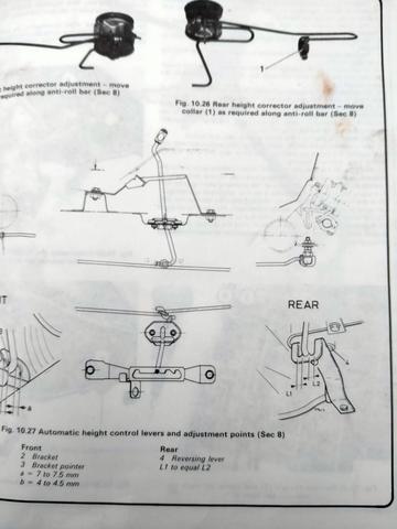

Does anyone have a clear picture of where the rear height corrector rod goes through the pivot arm, my Haynes has been ruined by leaky roof.

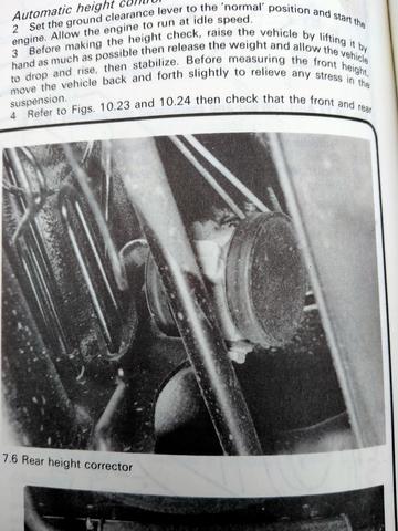

Is this of any use. My manual gas been had by mice but this page was OKrutter123 wrote: Fri Oct 07, 2022 6:27 pm Does anyone have a clear picture of where the rear height corrector rod goes through the pivot arm, my Haynes has been ruined by leaky roof.

Mmm... As I thought something is amiss.
It appears in the bottom right pic headed REAR, where the height control rod enters the pivot it has 3 notches where the rod sits L1 and L2 in the pic, mine appears to be completely flat (worn away) along this edge so the rod is sitting "forward" permanently in position L2, hence this would throw the height out of sync?
I'm gonna remove the pivot and see if I can build it up with a bit of weld and file some new notches into it see if it makes a difference

I think it is meant to be flat. What you have to do is to adjust the slider on the rod so that the rod is centred in the opening when the car is at normal height. As yours is not at normal height it is impossible to adjust correctly. Have you marked up the roll bar clamp yet and tried to adjust it to get the correct height.

The rod is flat on my car & on the parts car, so I think that they're supposed to be flat. Maybe the early mk1 cars had the notches, but not the rest? When the hydraulics are working correctly, and the car is in normal ride height, then the rod just sits in the middle anyway, even without any notches. I first saw it on mine when it was in a 4 post ramp.
