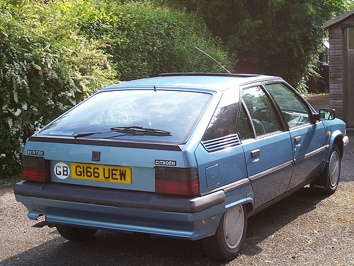

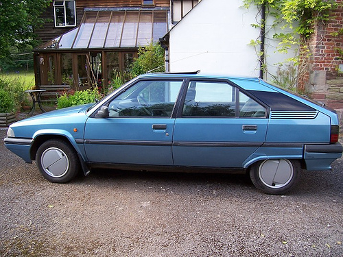

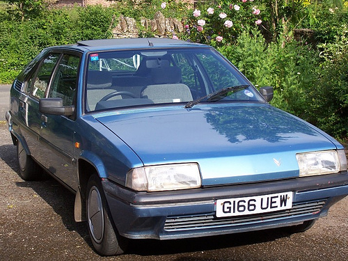

Oh yes - I took some pictures. Still in pretty good shape after 18 years I reckon - although the paintwork and trim do need touching up in a few places. Don't know if this is the right place to post them - let me know if it isn't!
