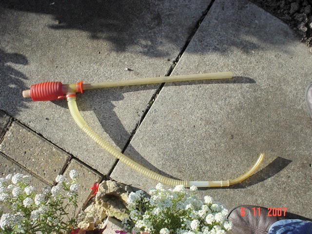

You require a self priming pump. Pic below is type I use, low cost at markets etc.
The reason for keeping the rear of the car up, is to allow the debris to flow under the fuel sender location, so it then becomes visible.
Note: Do not remove the sender if you have a full or near full tank of fuel, as fuel will run out when you undo the sender retaining ring..
Good luck
Hello Brian, thankyou for your reply. Now I understand about the tank angle as mentioned. Will look for a similar type of pump. I was going to drain the tank completely first but I suppose this might prevent the sludge from floating into sight through the sender opening. By the way, I've got a similar pair of slippers ( as visable in your photo) that my friend brought from Morocco and very comfortable they are! Cheers
