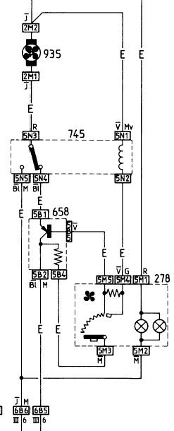

Well, I managed to look at my blower motor problem today. I must admit I was pretty conviced in was the relay at first due to the lack of it's click. But the other day the slower speeds seemed to get slower and it eventually stopped working completely. So I started thinking it must be something else so I started with the control panel today. It turned out to be that there was no earth connection on terminal 3 of the control panel when there should have been, the contact between the connector and the pcb was okay, so I guess a break must have developed somewhere in the wire.
I also noticed that the circuit diagram in the haynes manual is not quite correct; it has terminal 1 & 2 for the control panel illuminiation with 12v on pin 2 and earth on pin 1. On mine at least these were in fact the other way round and pin 2 is earth. As it happened though this was quite convienient for me as it meant the other earch on that panel was right next to the one (pin 3) with the dodge wire.
So I put a blob of solder between pins 2 & 3 so they both could share the same earth wire and it is all working again now. I assume this shouldn't cause a problem as the main current for the blower motor doesn't pass through the panel so the current is pretty low (less than 200 ma according to the multimeter) and they both just go to earth,;
not sure why there are two wires really.
Thanks everyone for the help
Rob
Rob
