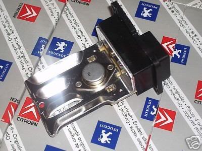

A week's motoring, 600 more miles on the clock, and all seems well. The dashlights turned-out to be a faulty dimmer switch, so the spares box sorted that, haven't got around to getting a fan resistor yet and haven't got a spare, which is nuisance as they're fairly expensive.

Is this the "resistor" you're referring to --- It's on eBay for £16,
http://cgi.ebay.co.uk/CITREON-BX-HEATER ... dZViewItem
Be forewarned that this might not be exactly what you have on your TZD as there appears to be some variation in the type and location of components and at least two versions of the circuit in use. See,
http://bxclub.co.uk/forum/viewtopic.php?t=7555
From various reports it seems that there is a very good chance that it's simply a bad connection somewhere --- so it should be worth locating the various connectors and cleaning them with WD40 (including the connector to the resistor or power module).

Yes Ellevie, that was the right type of resistor, when I took mine out I found that the exposed part of the PCB was completely corroded. So I now have a clear screen and toasted feet.
