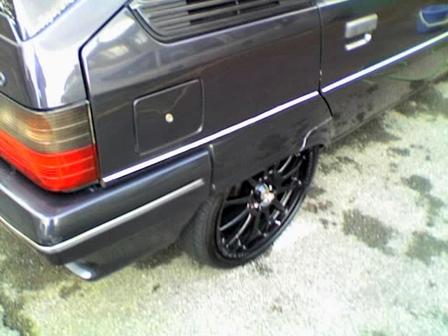

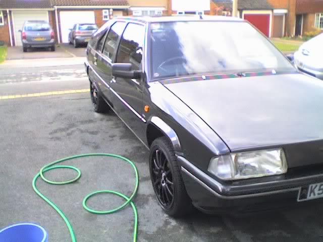

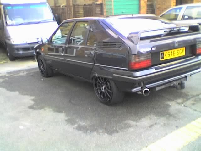

i had 205/40/17's on my bx they were from a ford i had to use spacers to get the right et. but had no problems, but like what kitch said it makes the ride harder the bx crashes into potholes enough on 65/14's imagine a 40 profile would be like........exactly :shock:
heres a few photo's of mine before i changed to 205/309 gti speedlines 195/50/15's and there just right.8)

Did the 17"s foul the arches?

the only fouling i suffered was the hand brake cables going to the callipers but abit of bending of the holders and sorted!
as for the rear arches no problems as such, but it is tight and if you have dodgey rear arm bearings they'll rub the inner arch and getting the wheels on and off requires the car to be jacked quite high to make enough room to get the wheels between the arch lip and brake disc.
