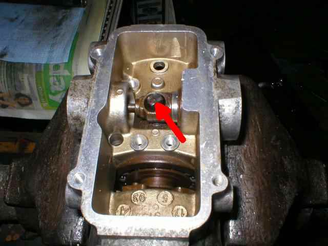

The main problem that stopped the pump was that the fuel metering pin (attached to the end of the governor) had seized in the stop position and took a bit of shifting. Apart from being mucky and having slightly noisy bearings, the rest of the pump is OK and will clean up and live to pump diesel again.
I have reason to believe the car stood about for a long time (around a year) and the muck you see is the result of the diesel decomposing to something horrible during that period. The bio-diesel was a red herring.

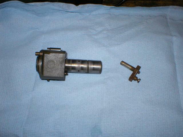

As is well known, these pumps die very quickly if run on veg. The reason is the distributor rotor shown in the picture below seizes in its sleeve due to lack of lubrication. The clearances are very close and only thin diesel can get in there to lubricate. Thicker veg just cannot penetrate and as a consequence, the rotor heats and welds to the sleeve. You can, if you look carefully, just make out some scuffing on the rotor and this looks like the start of what happens when lubrication runs short. The small device on the right of the picture is the seized metering pin; the cause of all the problems in this pump.

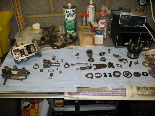

And here is a picture of the pump all in bits on the bench...

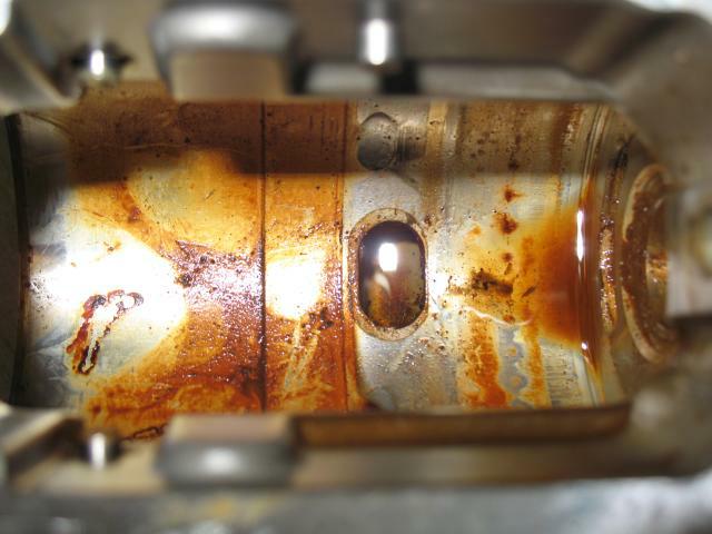

Further investigation into the pump pictured above shows there is corrosion present, particularly on things that were originally plated steel, like the governor plate. The plating has significantly discoloured and the bearings are quite rusty, as are the unplated steel bits. Therefore, the contamination is of a different nature to that in the Bosch pump I spoke of earlier. In that one, the contamination cleaned off relatively easily to leave shiny metal, even on unplated steel; in the Lucas, there is real rust :o Good diesel will never do that as every other pump I've opened that have run on diesel have shone like new inside.
I have to conclude therefore that the bio-diesel was not such a red herring. It might have contained sufficient moisture to leave a considerable amount in the pump or perhaps it was not fully reacted and both meth and caustic soda got in and did the damage.
Makes one think twice about the wisdom of running on anything but diesel.
Bearings are a bit tricky to replace Jonathan. The Lucas is a bit tricky to pull to bits, a little harder than the Bosch, and a special tool is needed to extract the cam ring peg as shown in the picture below. It's generally very tight and hard to get purchase.
It's a circular shape with two flats ground on it and is very tight. You can pull the pump apart without removing the cam ring but you cannot get to the governor or the main bearings..
The picture shows some of the contamination still present in the pump body, especially evident in the region of the governor. That is rust :twisted:
