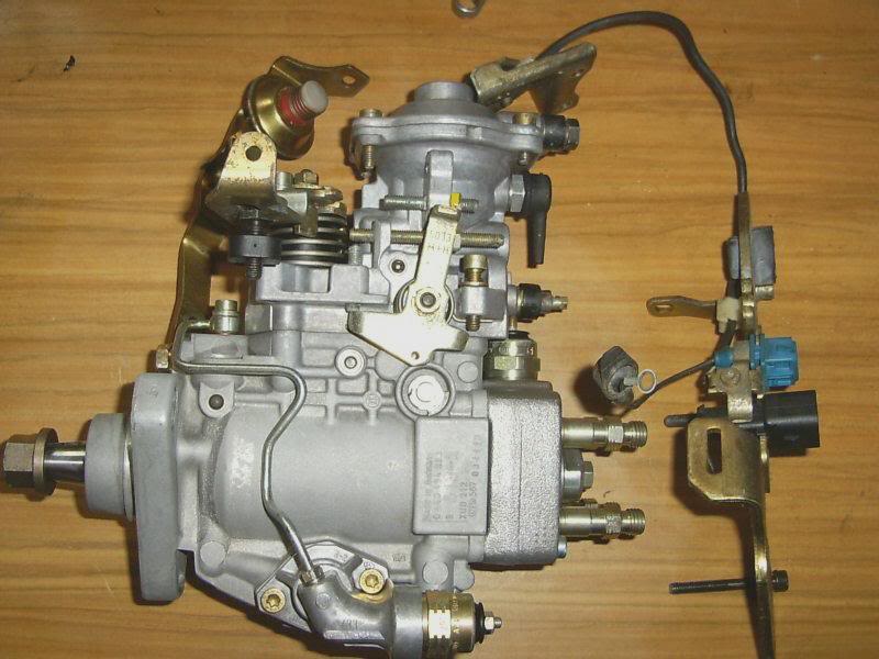

Right I've been a good boy this year so no reason why Santa shouldn't deliver this:
Preferably not by Parcel Force as I would like it to arrive in the above condition :wink:

So did Santa bring you one Ed?
Now, the one in the picture is one for a Turbo engine as it has the LDA (UFO) on top. More than likely it's for a 1.9 Turbo
These will work on the 1.7 NA engine but as a guess they'll overfuel a bit in standard set-up and it may be better to tweak it down slightly.
Better if you can get a pukka non-turbo Bosch. They look much the same but don't have an LDA.
This is a non-turbo one...
Jim

Absolutely. The top image is from a 1.9TD engine. Although it would work on a non-turbo engine, it seems a bit of a waste of a turbo pump.
Likewise, it will work on a 1.7TD, with the fuelling wound in a touch. The "genuine article" 1.7TD injection pump (with the extra waxstat unit on the front) is a more robust pump though, and allows you to manually adjust the injection timing too (rather than relying on the electric advance unit on the pictured pump)

Err ummm, didn't mention it but mine is a 1.7 TD :wink:. That pic and others, plus interesting veggie lubrication issues to be found here

ed4ferrets wrote:Err ummm, didn't mention it but mine is a 1.7 TD :wink:.
In that case Ed, the one shown in your original picture will be fine with the fuelling wound back just a tad :D
