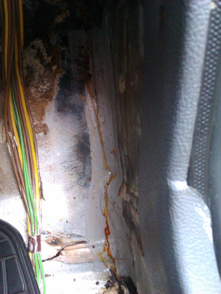

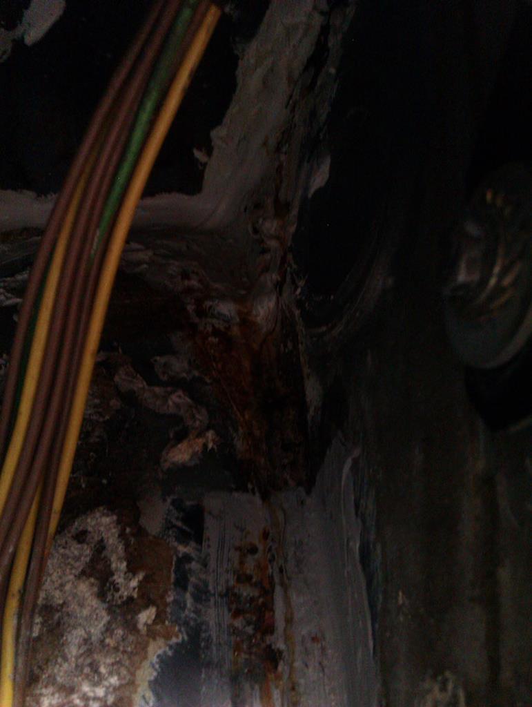

Someone has been here before trying to cure this water leak, both sides, and honestly it's a tricky one to unpick without removing the dashboard. I'm pretty sure the leak is directly related to the previous windscreen surround repairs and the A pillar door hinge repair since it's coming from that sort of area. The difficulty is figuring how the water is getting into the area it's leaking out of into the car. I know it's all sealed up from the outside on the inner wing because I did all that, and there's no obvious ingress from the door hinge repair either. The windscreen, so far as I can tell when I removed various trims, isn't letting water in or suffering from rot either. The only place I could find anything was behind the washer bottle in the scuttle area. There was some loose sealant in this area that I dug out and daubed fresh on when things dried out and this drastically reduced how much water was getting in so I suspect that's the right sort of area. It's not 100% sealed yet, when the weather is better I want to really dig into this area and eliminate any holes and rot that might still be hiding, it's probably a fairly small repair that's required along with a lot of time to dismantle everything to get to it, so probably not a fun job.

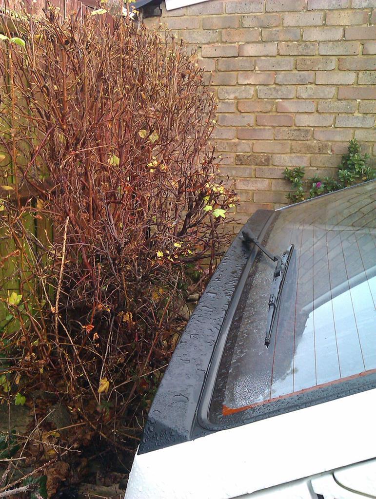

On the plus side, since adding drain holes to the rear reflector panel the boot is staying properly dry now and the rear screen hasn't fogged up excessively so I'm cautiously optimistic I've sorted that out. The other job today was clearing some rubble from the end of the parking area in part to get the car back a bit further and test for Princess space, and in part to show just how tight the garage is here. You can literally get the BX (or the Princess, they're about the same size) in the garage and nothing else, which is honestly a bit disappointing.

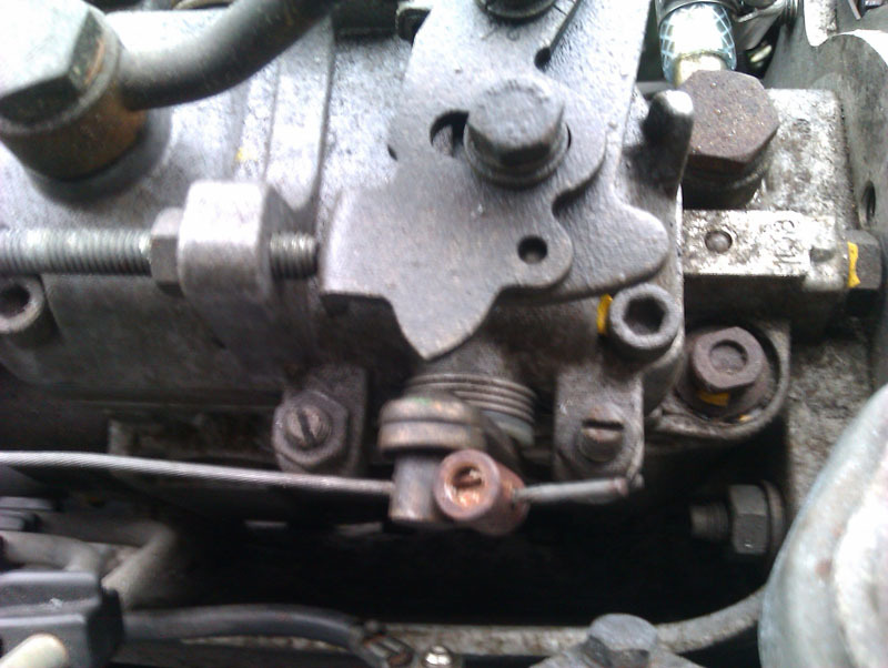

Today, it was raining. The good news is that means the BX was, as usual, much easier to start and it highlighted that the sealing I had done behind the washer bottle had improved water ingress issues quite a lot. I also learned that the driver's door only drains out of the front drain hole once you open the door and while it does drain very fast since the drainholes are all nice and clear, it does seem a bit weird that it won't drain when the door is shut. And no, that isn't how the water is getting into the driver's footwell, I did double-check. So, the thing to do before starting the car was to disconnect what I understand to be the cold start cable. There wasn't any slack in the cable before doing this, nor when I reconnected it.
Now, the car did start slightly easier than on a dry cold day, but no easier than usual than on a wet day, so the results of this were inconclusive. There didn't appear to be any external bits to adjust at the pump end of the cable so I assume the adjustment would be done on the arm on the back of the housing at the other end of the cable. The two adjustment screws are very stuck, but there is a little movement in the arm anyway, which I assume is as it should be, I didn't fiddle about with it for fear of making it worse and due to not having much time spare to faff with this today.

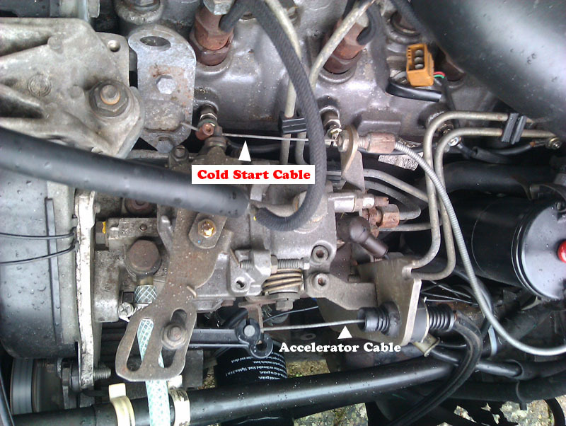

Here's a wider shot of where that cable above actually runs. I took both pictures from opposite sides of the engine for extra confusion. The accelerator cable doesn't have excessive slack, nor is it excessively tight, and it moves freely. I can't see anything obviously amiss so I imagine the fault I'm looking for that's causing the cold start problems is a hidden part.
Typically for a rainy day, the car started perfectly happily throughout my errands and ran perfectly fine. The very first attempt to start the car with the cold start cable disconnected did fail where normally it would succeed on a rainy day like this, the second start was reluctant, but did go eventually from a sluggish chug to normal running within a few seconds. I'm not sure if any of the above information helps clarify the problem, or just muddies the waters further.
Hopefully I've actually understood what I'm looking at properly. If not, I'm happy to be put right so I can get a better understanding of what's going on, I'm not brilliant with engine stuff.
