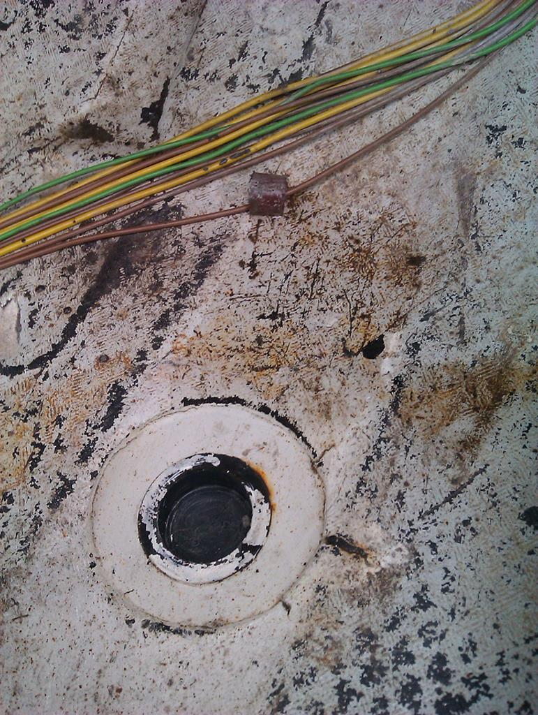

Today, it's cold enough to be a stubborn start, and dry enough too, so before doing anything I lifted the rear seat base to get to the two plastic grommets that allow access to the stuff in the tank.
The only thing in here that shouldn't be was spider webs and spiders casts. No signs of any damage, leaks, or anything untoward. They're both done up really tightly and while I did have a go at undoing them, it felt a bit futile, they didn't really want to budge at all. Just in case I gave them a knock the other way to ensure they were as tight as could be and then left well alone. The hoses look healthy with no signs of perishing or pinholes, nothing was showing up to the eye, ear, or nose with the car running and my gut feeling was that this was a dead end for fault finding.

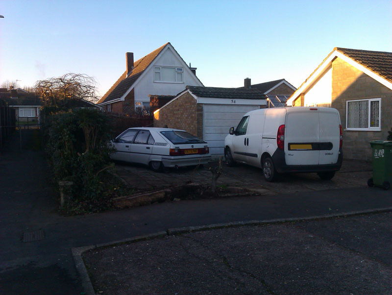

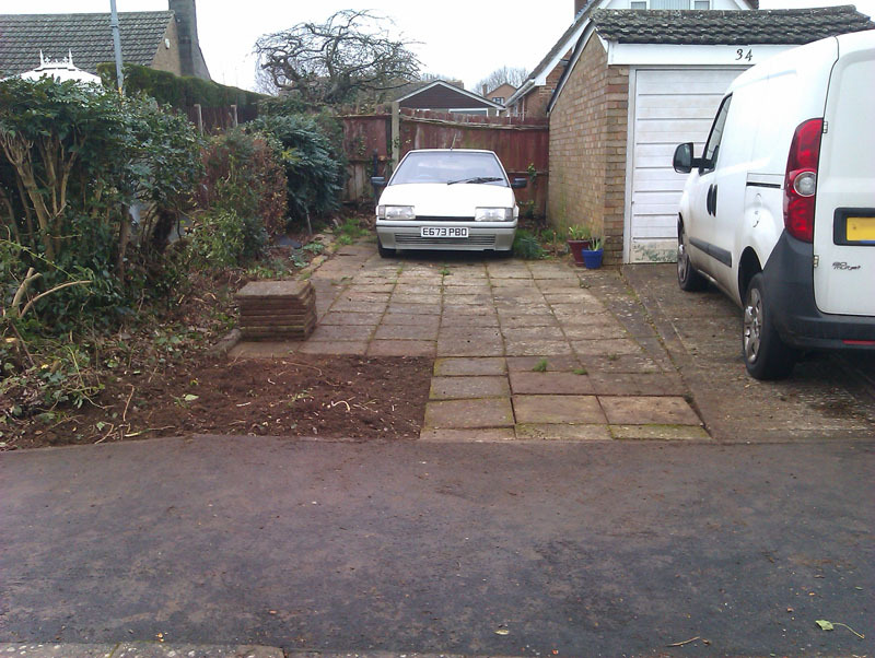

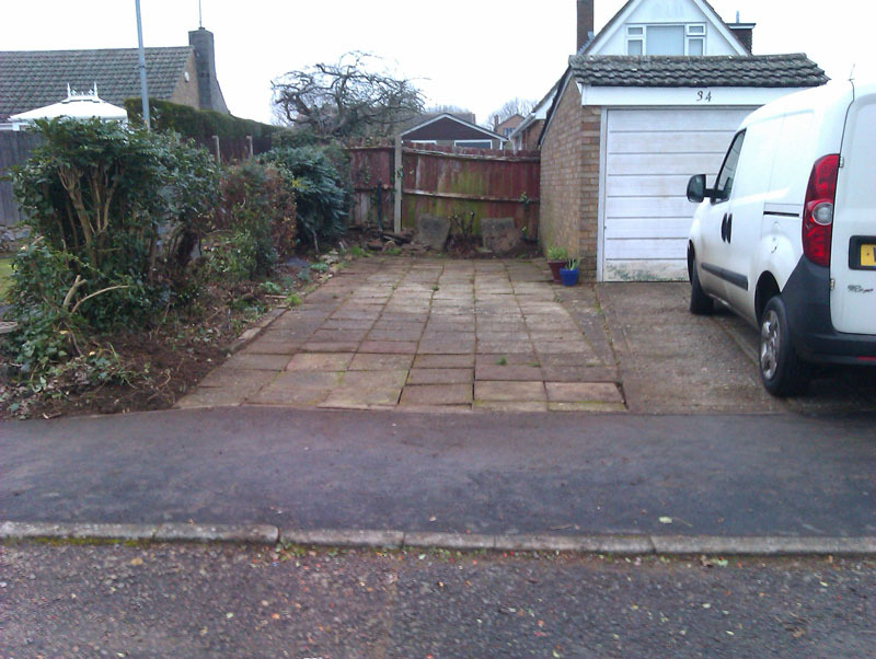

One of the jobs at the new house to make it easier to park up the cars, is to sort out the driveway. Originally, it was just a single-width concrete strip, at some point a previous owner expanded this to make a hard standing of paving slabs next to the garage. Now, since there's a full width dropped curb and potentially a double-width driveway, it seemed daft not to make use of it. The only problem is, a mixed hedge had been planted in the way which meant it was a little awkward to get both vehicles in and out.
With some effort, we got most of the hedge out in one day, and some of the concrete footings for the original wall was still buried in the ground, in the way. First day of labour proved promising.
We were left with a couple of stumps to remove but could already see access was going to be much improved. It's good for our neighbour to the left of the shot too since her driveway is really difficult to get in and out of, by removing the hedge and trimming everything back it's a lot easier for her to see when getting in and out of her drive.
Today, we got the last of the stumps pulled, the concrete footings smashed up and removed, and started laying slabs that we don't need from the back garden. The advantage of using the slabs from the back garden is that they match the existing driveway perfectly, by the time we're done it won't look like we've done anything at all, which is perfect. Plenty of space for 2 cars when this front bit is finished and we'll be gaining a little more when we replace the muddy strips that pass for flower beds along the side of the garage and fence. Another 9 slabs to lay at the front, and 17 for the back, with about 40 slabs on the back garden to make use of means we've got plenty of materials for this. For the car port we're looking at extending the roof joists on the garage out for the roof frame since the end of the joists are visible from outside the garage due to the way the garage is built. You can buy pre-made car port kits, but it looks to be cheaper to get the raw materials in higher quality and custom build so that's probably the way we'll go.

We got the driveway finished and I have to say, it's lots better to be able to use the access properly now.
In addition, whatever was making the BX difficult to start now isn't. It's been good as gold the past few days with the exception of the low coolant light coming on due to the slightly dodgy connection at the plug. I'm not sure if the coolant level sensor plug should have one of those metal hairpin things on it, but mine doesn't, which I suspect is why it doesn't always make the best connection.

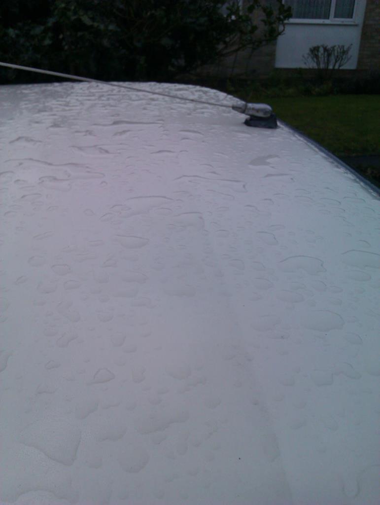

I have been giving the BX a few doses of Captain Tolley's Creeping Crack Cure. The last few times it's rained I'd been having a look at what parts of the car were staying dry, rather than wet, in an effort to find the root cause of the water ingress. This led me to the assumption the leak must be either the windscreen surround or the roof gutter seam on the driver's side.
Having found out the roof gutters are bonded on and something of a nightmare to remove, I wanted to avoid that job. So, an application of CTCCC was duly applied and the roof gutter and a good portion of the driver's side of the windscreen seal slurped up a decent quantity. Then I just had to wait for it to rain, which it did, and I was rewarded with a car that while not bone dry inside, had certainly allowed much less water in than previously. usually, that black floor grommet is full of water, this time it had collected just in front of it in a much more managable quantity.
Since then, I've run some more CTCCC along the gutter which is no longer accepting any (probably means there was a leak there, now plugged) and then a couple of applications along the entire top edge of the windscreen surround. What was interesting was watching the successive applications disappearing in less and less places, presumeably as it was filling up little tiny holes that have been letting water in.
Now I just have to wait for it to rain enough to see if the leak reappears. I've tried using a hosepipe to simulate rain to show up the leak and for whatever reason this never actually works, the car seems to have to sit in the rain for several hours before it lets any water in so that must mean it's a fairly tiny leak, wherever it is.

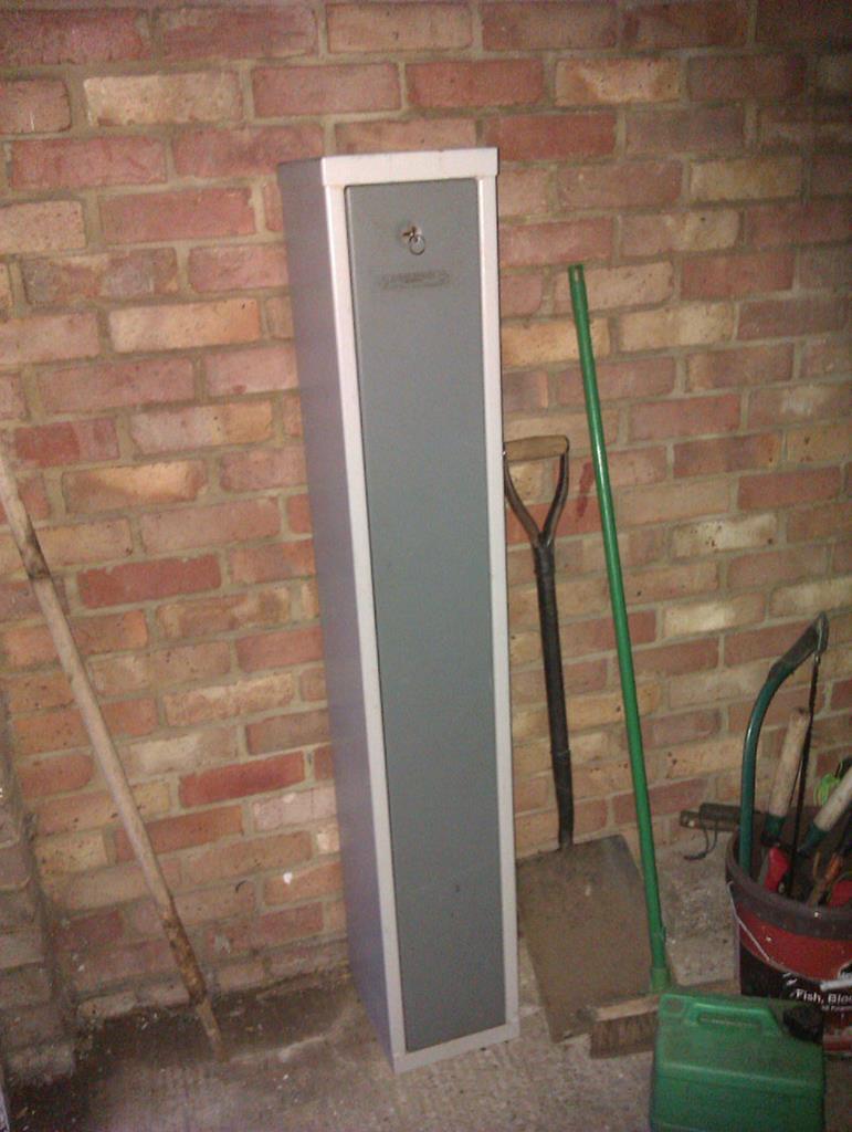

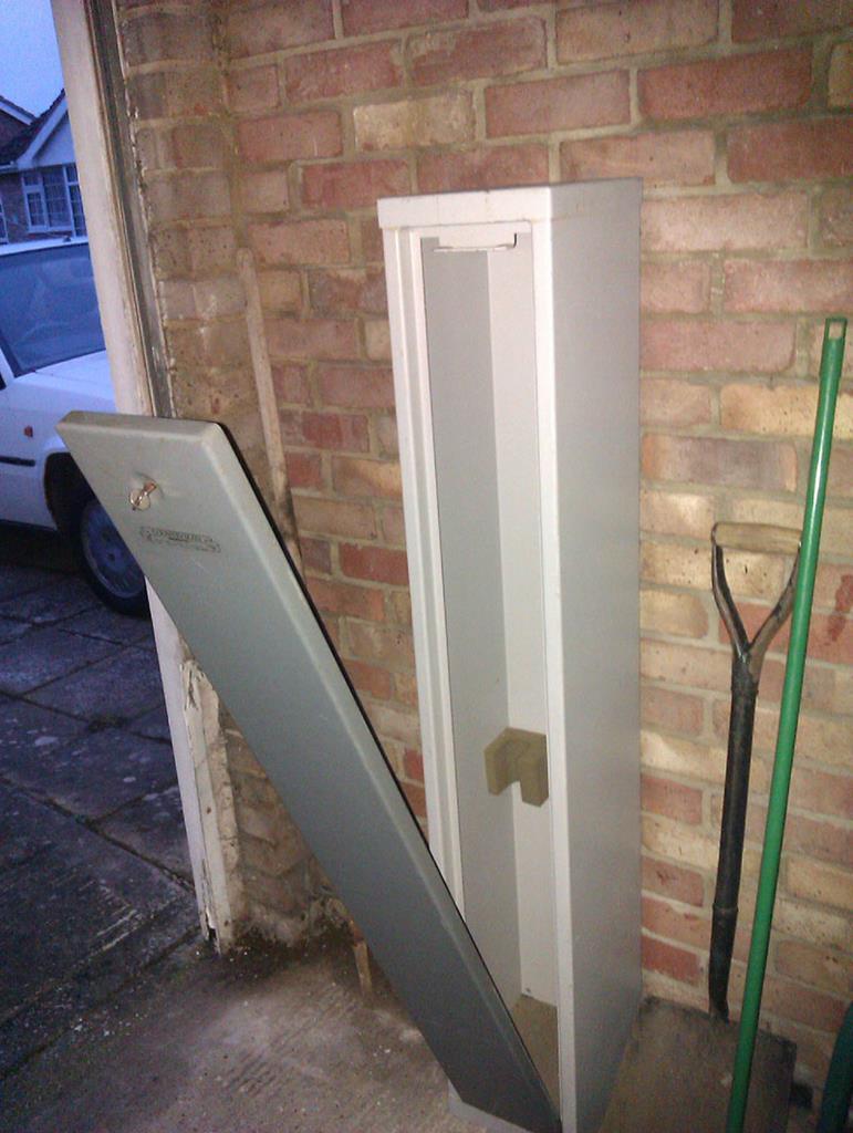

In other news, BX has been on donkey duty today hauling furniture and Stuff to the new house when I spotted a skinny locker propped up against a garden wall. After a couple of door knocks, I learned it was put out for scrap, so duly scooped it up as potential garage storage since it's a nice solid thing. It was only after getting it home and showing pictures to a couple of friends that I learned it's a gun locker, which explains the weird bottom-hinged door. I'm planning to use it to store metal bar stock and garden canes and other skinny bits of useful stuff. I daresay I did alright for free on this one, it even still has the key.

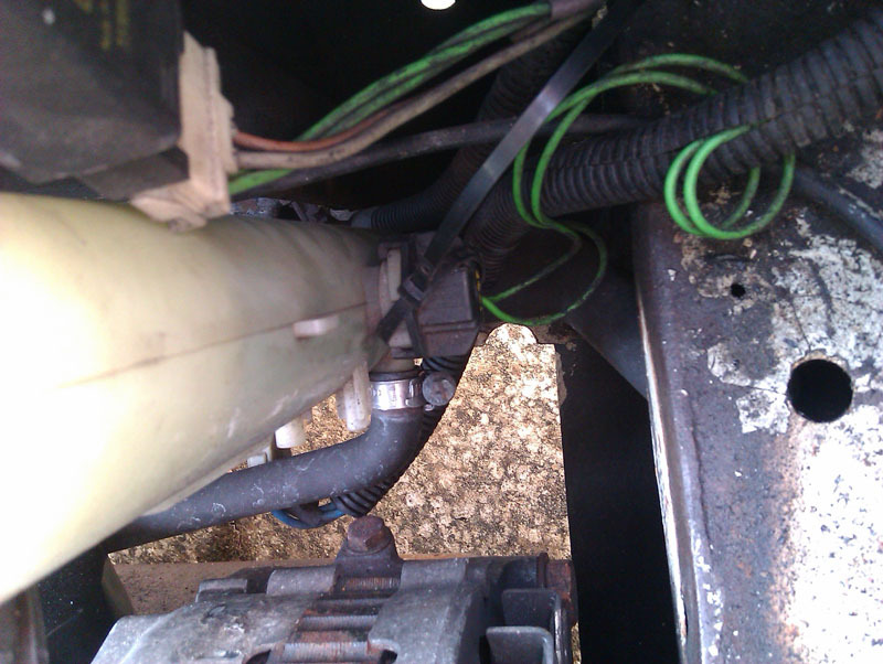

I opted for the logical (amazing, I know) approach of using a cable tie and we'll see how we get on with that. If it still throws the light on erroneously I guess another round of vigorous cleaning is in order followed by another attempt to squish the connector for a tighter fit.

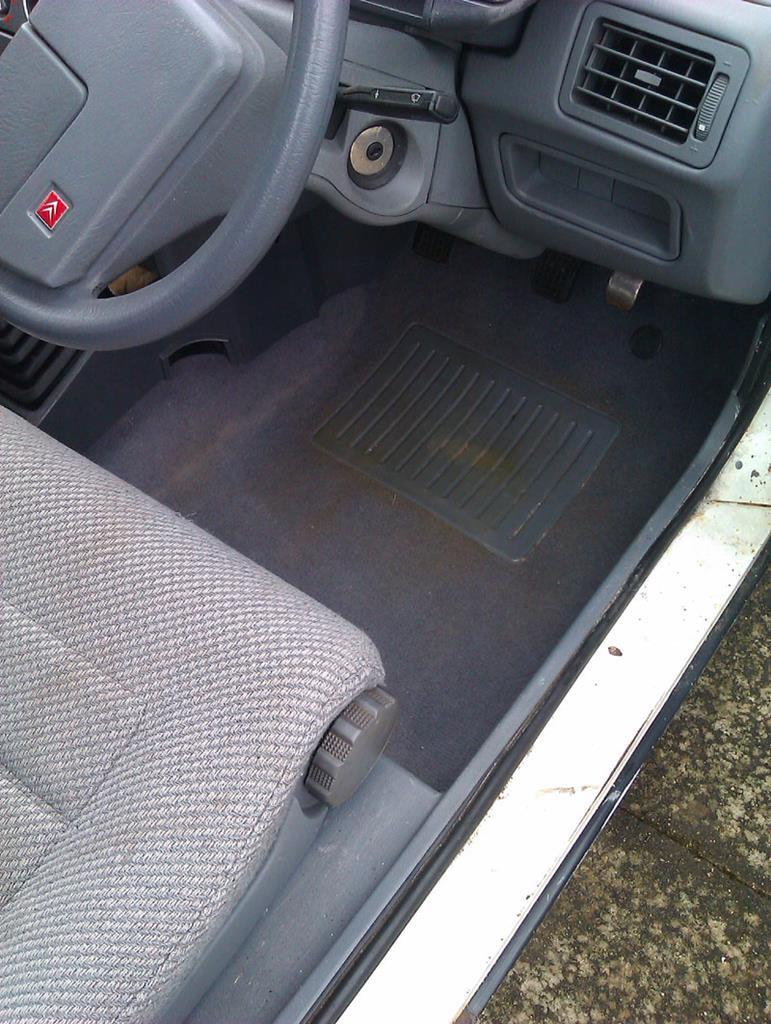

In other news, after a couple of days of dry weather we had some rain. Normally not a momentous thing in and of itself.
In this instance it is, because finally, after trying to track down where the water was getting in, it appears to not be any more. The footwell was bone dry, not even a dribble from the little spot where it had been seen coming in before. Looks like the final leak was somewhere on the windscreen surround and that the CTCCC stuff has done its work. In celebration, I refitted the carpet.

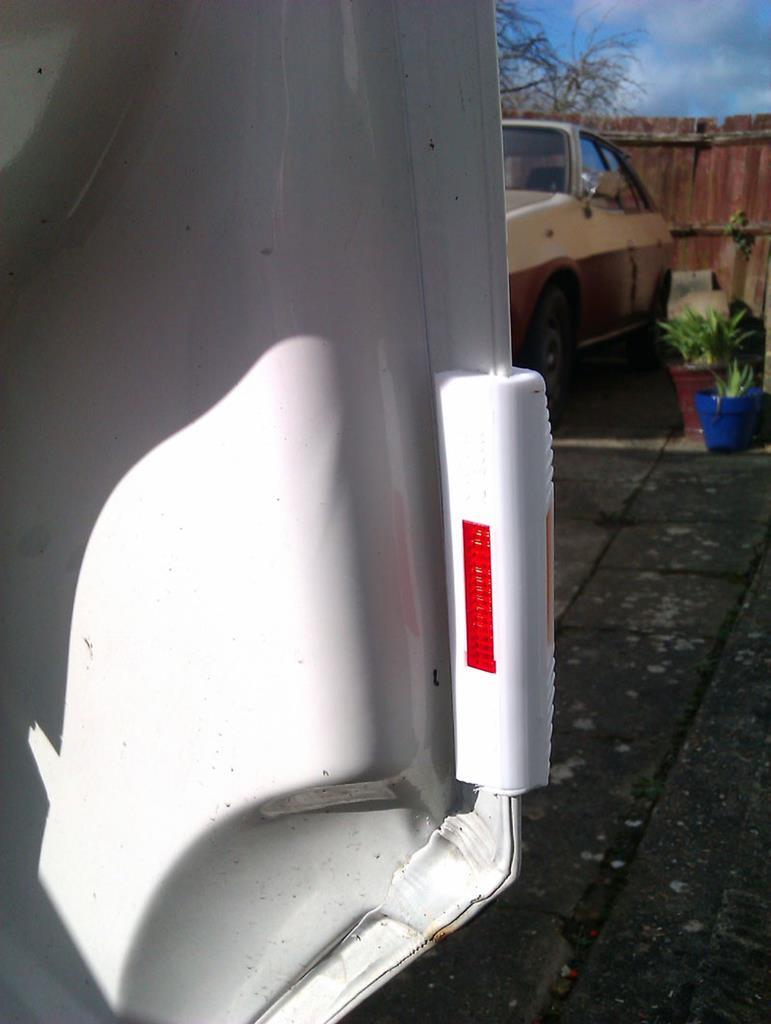

It's Dad accessory time!
There is a good reason for these, I've found a few places I park have low walls and I've been dinking the edge of the doors because the wall doesn't line up with the paltry bump protector on the door. Now, I'm aware that I could get a modern 'invisible' edge protector but why would I when I can get period ones? Chopped them in half so one pair does all four doors and so they actually fit the door, which is totally okay since this was also a period thing to do.
I can now fling my doors open with gay abandon!
