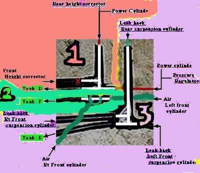

Which makes it all the more important for people like us can pool minds, resources and expertise to come up with alternatives. There are 3 sub-assemblies combined by Citroen into one part (1,3 below - lhm return groups, one vent line -2 below) . Each should be capable of replacement individually. I

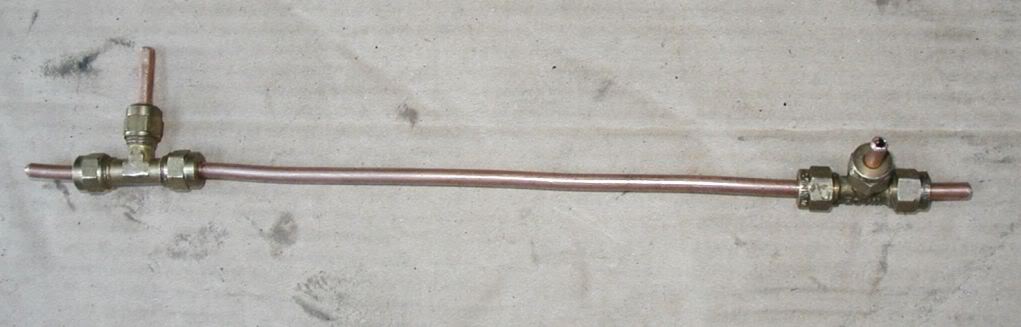

've replaced sub-sections a couple of times with homebrew plumbing with help from someone who likes their metal gas-plumbing fittings, displacing it a little rearward and tie-wrapping to avoid clashes with the rack boot (second pic).
The push-fit, articulated (Boxwolf's problem) and bent-back links on the octopus are known weak points that've been tackled in different ways or improved-on in various ways by people doing repairs. That said, I'm not sure I've yet replaced the sub-assembly (1 above) that's failed on Boxwolf's car, which has the potential highest-flow parts. I still think there are possibilities and refinements here, though. Anders, for example had a mod for adding a section of return pipe from a rear height corrector to beef up the vulnerable bent-over pipe from the front height corrector. I seem to recall using wash-wipe hose as a link here myself.
The next time someone embarks on a ground-up strip-out and rebuild of a BX (the only way to be really sure of a good bodyshell) then that would be a perfect time to attack the problem. Alternatively, the next bx-clubber's engine-swap?
