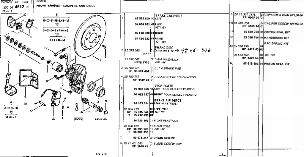

Time for some kind of pic/diagram methinks.
Can you just confirm from the diagram below which part of the caliper assembly you're talking about, and exactly what you did beforehand.

Thanks for the diagram, but that only seems to show half of the caliper. It is one of the caliper sliders (a?) that was sticking when I last took the caliper off. The gaiters are a bit split on both sides of it which may be why it has started sticking up.

I suspect the outer half of the caliper isn't pictured as it's just one lump of metal that doesn't do a great deal except brace and contain the pads - and it's therefore irrelevant to the problem. There's a lot to fit into this diagram.
There's a slider and boots in the diag, labelled "A" unless I'm very much mistaken, which forms part of assembly #4 in the list on the right - "Repair kit de Colonettes". If Citroen still do it that's what you need, I think.
However That kit will be useless though if the caliper body where the sliders locate is at fault through corrosion or damage. In that case it's time for a new/recon/secondhand caliper - I'd be looking for one anyway as a backup.
I wonder, and hope for your sake, whether bits of the disintegrating slider boots could be the cause of some of your problem. I wouldn't count on it though.
