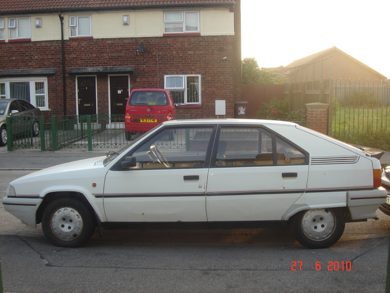

It's here! My 1987 19TRS Auto.

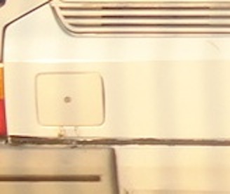

Just remove the rear lights, there is an hole which is oblong shaped from memory. Sitting behind this somewhere, it may not be in view is a tube. Best way i've found of getting hold of the tube to lever it through the stupid shaped hole, is to get a screwdriver which has a circular shank (not a square one, as that'll increase the potential damage to the tube), grease the hole to allow the tube to be pulled through easier. Be firm but careful when bending the tube through the hole, what you don't want to do is break the tube. Once its through, either be brave & suck really hard

I had some rust bubbles on the nearside rear quarter and I had pretty much ignored them because they didn't seem to get any worse over the 4 years I've owned the car.
Lately I've been fettling... fitting the new front bumper with the foglights and re-spraying bumpers front and rear. Using the airline scarifier on the rust was too brutal and punched the holes right through.
What I found - and this might be the case with yours too - is that the rust holes extended quite close to the square hole that the rear bumper slots into - I was glad to have found that in time to fix it without having to replace the panel.
I wire brushed the inside of the wing with a rotary on an extension drive and covered with Kurust before fitting aluminium mesh on the inside with Isopon followed by Waxoyl spray - then filled from the outside etc. Not a perfect solution but better than letting it rust further.

Thanks Brian. Brother and I are going to give the car a good going over for rust hopefully at the start of next week. The rotten wing will be replaced, as it is not worth saving. On first inspection the car looks in excellent shape rust-wise, so I'm actually pretty pleased so far, despite the holeelectrokid wrote:Looks good - all the best with getting all together.

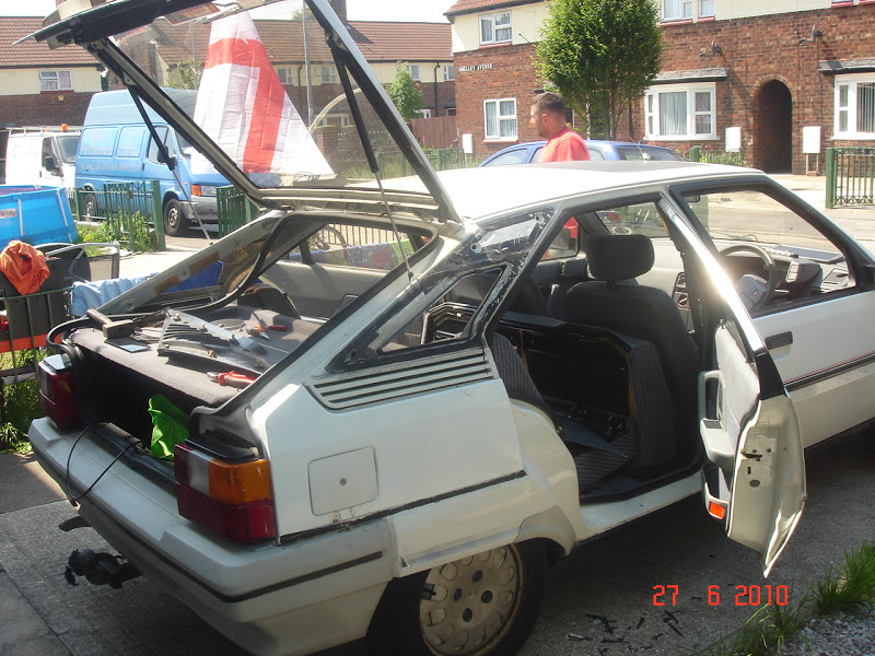

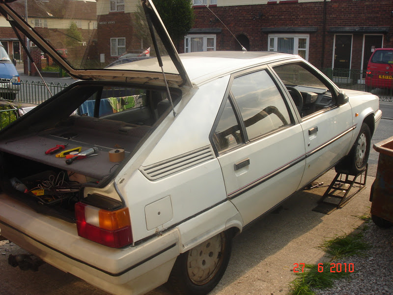

Well I have been a busy boy. Now that pretty much everything's finished on the XM, I've been doing some more on the BX:
Ignition barrel
This has been removed, and using the barrel kindly donated by Peter Dykes, I've replaced the broken return spring. The job wasn't overly fiddly, and the switch is now working as it should for the first time in a long time apparently...
Rear wiper arm
The arm I got from RxBx is spot on, and currently has a used blade donated by PD. It all works fine, but will be painted and fitted with a new blade prior to the MOT, as will the front, which is completely useless.
Interior
As I'd removed all the plastic bits in order to remove the ignition switch and wiring, I used the opportunity to clean everything in the bath with hot water, washing-up liquid, and some Cif-lemon-type stuff. I did the whole centre console, and cleaned out a huge amount of detritus from underneath it, and the sides of the seats. The remainder of the dash and the door cards got a similar treatment, and the interior looks and smells much better as a result, as do the window switches, the very faded ones having been replaced with 3 very good ones again donated by PD.
Exterior
SWMBO was a great help in going over the whole car with some of the Cif-lemon-stuff and a cloth, and the car is MILES better looking as a result. There's a few little areas of rust that need sorting out, but everything is amazingly good given the age, except for that rear wing, which will be getting replaced in the next couple of weeks. The rear lights kindly donated by Tim are installed now, and other than the rusted wing it's really beginning to look like someone owns it

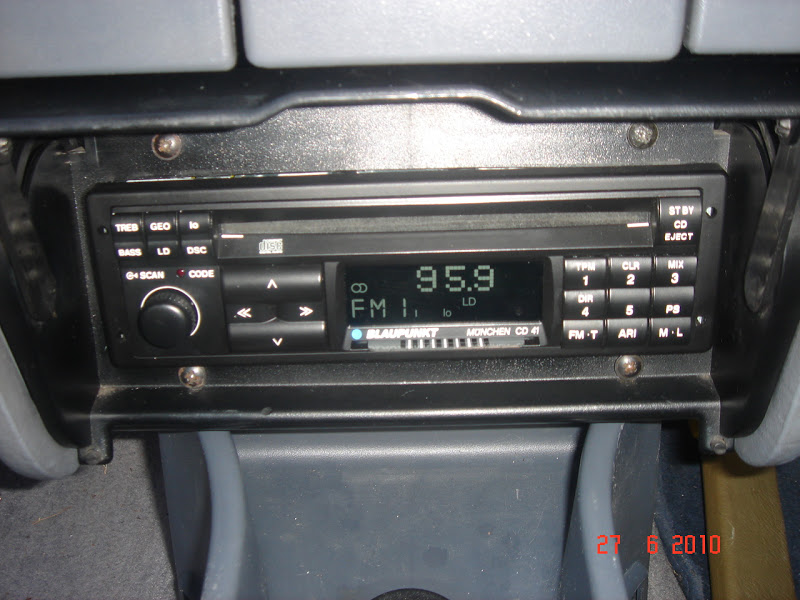

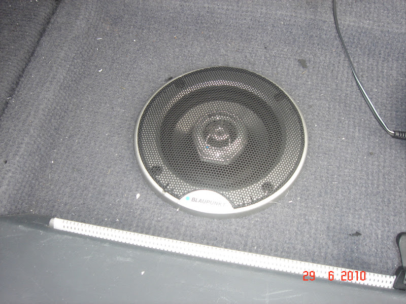

Stereo & speakers
I've found some nice Blaupunkt 5" dual-concentric speakers I've had kicking around for a while (I originally bought them for my Niva!), and the parcel shelf is already marked out for cutting as soon as brother remembers to bring his jigsaw. The rather nasty wiring that was there for the stereo had the switched live wire for the stereo connected to permanent live, which had the effect of flattening the battery over a few days. I found this out the hard way, and was understandably annoyed. The radio has been removed as a result, and I'll grab the connectors and some wire next time I'm in the scrappies.
Talking of the battery - I want to throttle whoever it was who thought that it was a good idea to take a feed ( I've not investigated what for yet...) from the +ve terminal using a GREEN wire! As I didn't take the battery out, this fooled me into connecting the battery the wrong way round for a few seconds, until the happily smoking alternator pointed out my mistake! Thankfully no harm seems to have been done (alternator seems to be working ok, as does everything else), but....AARRGGHH!!!
The wire should only EVER be red IMHO, especially considering that car is (almost always) -ve ground. Using a green wire for +ve is just asking for trouble. Sure, it is perfectly safe if you're the only one who works on the car - you know what it's for, but for someone unfamiliar with the vehicle, and who didn't take the battery out.... Anyway, rant over, and thankfully no harm done.

Stereo & speakers

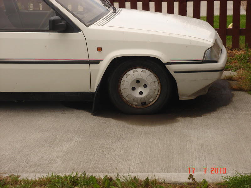

I did this yesterday - don't forget that the middle pin on the connector needs to be grounded as per discussions on that thread. There's actually a small track which would be connecting pin 3 to the track to the left if it wasn't for a small hole that has been drilled through it - my suggestion is to solder a small bridge across the hole to make the connection just in case that tiny track was designed to be a fuse.Next jobs
heater circuit modification
The behind-the-dash wiring is fun istn't it - someone had shares in a green-wire-companyfrom the +ve terminal using a GREEN wire!
The one at the front ? I recently fitted the GTi bumper I've had kicking around for 3 years - took the spoiler off (staples ? ? ! !) to respray and never re-fitted it. It looks ok but the front end does look a bit 'taller' or 'more square' - I would guess it would look 'flatter', perhaps a bit more 'racey' with it fitted. The angle of attack of the the front air dam has slight effects on handling and fuel consumtion - facing forwards (with the spoiler) will create more vacuum under the car - slightly better high speed cornering but slightly detrimental to fuel consumption - facing backwards (without the spoiler) has the opposite effect. The BX handles very well anyway of courseI'm thinking about removing the spoiler.
rayfenwick
- Posts: 1718
- Joined: Sat Mar 27, 2010 9:16 am
- Location: Kingston upon Hull
That sounds a sensible precaution, and I'll do the same.electrokid wrote:my suggestion is to solder a small bridge across the hole to make the connection just in case that tiny track was designed to be a fuse.
I don't mind it so much in such a situation, but a green wire coming from a battery terminal? That doesn't immediately make me think +ve... Ok, so I'll never make that mistake again, but even so it's damn annoying..electrokid wrote:The behind-the-dash wiring is fun istn't it - someone had shares in a green-wire-company
No, the big rubber one at the back, like the blue one in this photo of Roverman's (which I hope he won't mind me using here...) which illustrates the 3 types of rear spoiler (are there more?)electrokid wrote:The one at the front ?
The blue one has the same rubber spoiler as mine, the white one next to it has the integrated spoiler (which is hidden by the big rubber one), and the 2 furthest away have the GTi/babywalker/pram handle etc spoiler.
I like the neatness and purity of shape of the integrated spoiler, and this is what tempts me to remove it...

Rear wing
As you may recall, this was severely rusted. A replacement panel is the obvious answer, but as this is a rolling restoration that will eventually need a full respray, and as the current budget is tight, Graham suggested that I let him have a go at repairing the damage as at least the car can be MOT'd and driven around for the time being. So I agreed:
Before:
After:
It looks really good. The rubber strip is missing and the adhesive makes it look much tattier in that photo than it does in real life. It'll do for now, that's for sure
Tailgate Glass
The tailgate glass was held in by only a strip of adhesive on the right-hand side about 8 inches long - it's quite amazing that it didn't fly off when my brother was hurtling down the motorway from Richard's and slam straight into the gorgeous silver Aston Martin DB9 that was behind him for quite a few minutes - try explaining that one on the insurance form!
It didn't take long to remove it, clean everything up and then Tiger Seal it back in. It's now nice and solid <vicar!> and appears to be watertight.
C-Post Panels
Originally my car had the plastic windows in the C posts, but the drivers-side one was all but hanging off, and was an obvious source of water ingression. Similarly to the tailgate glass, there was only a small patch of adhesive at the top corner, so I reasoned that something like a cheesewire-saw would do the job nicely. I didn't have one of those, however. I had Stanley blades, a flexible snap-blade craft knife, and a guitar string <insert G-string joke here>.
Work began ok, and progress was slow, but steady. I was just telling Graham how precious these plastic windows are because most of them are now crazed badly, whereas these were lovely and clear and undamaged when.... it snapped in two. The fscker laughed at me. I said some naughty words. I said more naughty words when Roverman just laughed at me when I asked if replacements were likely. Hmm. Solid C-posts it is then.
This is actually ok, as I much prefer the look of the car with the solid C posts, and that collection of lines and angles around that area always looks very Lamborghini Countach to me.
They also make the car (look) more secure, so it wasn't the disaster it could have been. A few emails later and a big box of bits (this time thankfully intact!) arrived from RxBx - thanks Richard! So, the work could begin.
First job was to carefully remove the passenger side plastic window in case someone needed it. That lasted all of about a minute before it decided to break like its brother. This was annoying, but speeded up the removal process, and after a bit of brute force and ignorance (we should adopt that as a stage name...) the panels were removed and ready to prep.
We started by removing all the old adhesive from the panels and the car - oh, and removals of large chunks of flesh and lots of blood too - no matter how much we warned each other to take care with the craft knife, we both ended up cutting ourselves - Graham sliced the tip of his index finger, and I managed a spectacular cut through the top of my left thumb and all the way down the entire nail near the edge. It bled. A lot. So, more naughty words, lots of cold water, dried with a towel, bound together with electrical tape and carried on working. When I got home I superglued it together (otherwise the cut nail would catch on everything) and it has healed so well you almost can't see it now.
Anyway, aside the DIY surgery, the job went well. Add a bit of prep, rust treatment, primer and white spray Graham had in his shed, attach the new interior trim panels et voila:
Of course it's not the right colour, but it's close enough to stop it looking too tatty, and when the rest of the bodywork is done G will get a can or 2 of the proper colour made up at our local suppliers, which will do until it's ready for a respray once replacement passenger-side doors have been sourced.

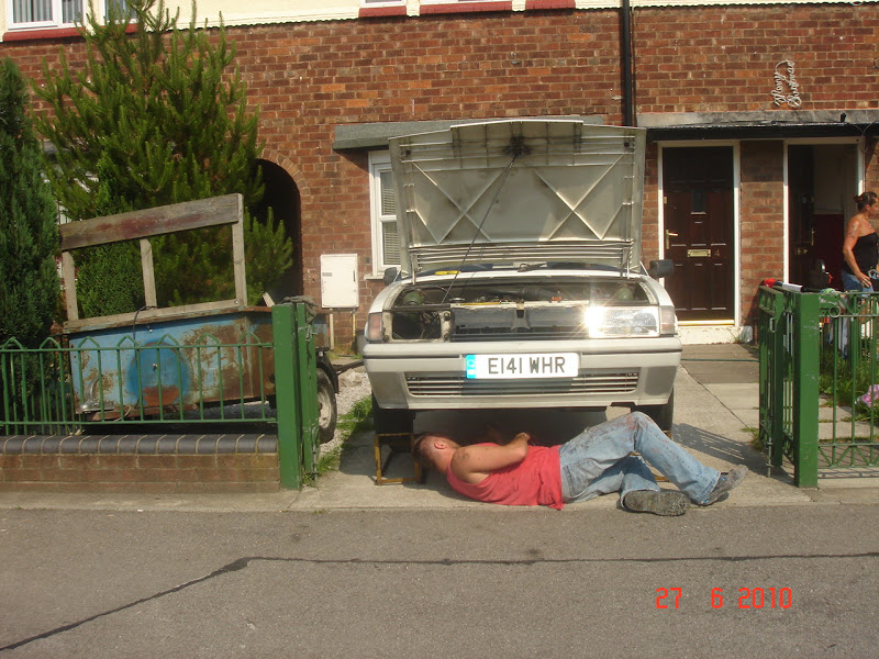

LMH Leak
When I collected the car from Richard there was no sign of any hydraulic problems - no warning lights, car rose smoothly and quickly, and no green stuff underneath when we moved it. Same goes for the drive home - no sign of any trouble. I promised my long-suffering neighbour that it wouldn't cover her drive in any of that nasty green stuff like my CX did when that was parked there. I can only assume the BX overheard this, and took it as some kind of challenge
Sure enough, next morning there was a big wet patch under the engine bay. "I think it's water" I hopefully said. Nope. LHM. No sign of anything shooting out when the engine's running, and a too-slow-to-see drip when it's switched off, so it couldn't be anything high pressure. At first I hoped it was perhaps spilled LHM washing down with the rain from somewhere underbonnet, but it wasn't. A thorough investigation was called for - time to call in the Stig, err, Graham.
After some prodding he's tracked the leak down to a split in the octopus. If anyone has any photos that would help (or if they can point me towards the ones I may have missed on here) and/or tips then I'd be really grateful.

ISO Harness For Stereo
First job was the installation of an ISO harness so the replacement stereo would not only plug in, but be fully connected in terms of ignition sensing (no accidentally leaving the stereo on to flatten the battery), dash illumination sensing (so the buttons light/display dims for night use) and all the speaker connections - including the new rear speakers. This didn't take long, and thanks to Mat Fenwick pointing out that both the illumination and ignition are ready for tapping at the LCD dash clock everything works and the wiring is simple.
Head Unit
Having the wiring there won't do any good unless there's something decent plugged into it. I wanted something that sounded good, but a modern "space invaders" head unit would look tacky and out of place. I've been a fan of Blaupunkt for a long time, and as the original head unit was most likely a Blaupunkt this was the way I wanted to go - indeed my CX has the top Blaupunkt system from 79-80, and my XM has the top Blaupunkt system from 1997-8 (as they're both top models - a Prestige and Exclusive respectively).
Of course in 1987 it would have been a cassette based unit, but I wanted CD. Blaupunkt did have CD players back then, but they were rare and hellishly expensive (and still are!), and the CD had to be loaded into a "cartridge" first. I decided to look a few years later, and picked up an early 1990's unit with original box, manual, connectors and 2 keycards on eBay for £10. With its inverse green and black LCD like the dash clock it fits in well aesthetically, and could almost have been there forever:
The CD doesn't read discs (something for me to play around with when I have time and the right mood) but the radio sounds great, and my ipod will play fine through an FM transmitter. This is what I'd use anyway, and having the CD working is really only for completeness.
I might change it later if something I like better comes along. The only reason being that it doesn't have RDS (though that was around before CDs..) and it is quite handy (traffic announcements, automatically switching to a stronger signal while you're travelling etc). That said I can live without it no problems.

My car didn't come with either rear speakers or dash tweeters originally. I'm going to fit the dash tweeters from my XM when I replace the XM ones, which I'll be doing when I do all the wiring for the Blaupunkt stereo and satnav system - complete with amplifier, (subtle) subwoofer etc. - think quality rather than boom boom chav noises, but I had some barely used Blaupunkt speakers that I'd bought for the Niva that I sold on, and I found I had these left over. A bit of careful measuring and marking, and Graham's jigsaw-ing and they're nicely installed on the parcel shelf.
They're a little modern looking perhaps, but don't stick out like a sore thumb. All that remained was running cables nicely and neatly (which gave me the opportunity to remove and clean all the centre console) and the job is done. The overall sound in the car is much better than before, and once the tweeters are in the dash I reckon it'll be great. As I said before, the fronts are a bit weedy, but I'll not be in any rush as it's just me being picky.

Tailgate Glass
C-Post Panels

LMH Leak
Head Unit
