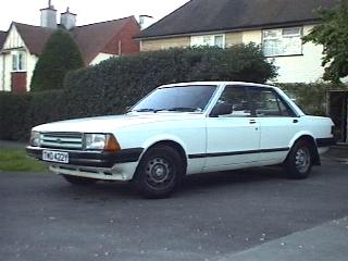

Wow- thanks for that Mat. I should, of course, say er... that this is and example of the size of car that can be made very fuel efficient by the careful use of a Weber carb
does that sound close to topic ?
I could only find a small pic of it on this computer
however, as I was wandering through the archives I found this article I wrote / modification I designed and built in 2005 - spotlamp switching controller which may have some usable ideas.

Nice car ...! I have a soft spot for the big Fords - so, by way of balance I loathe the smaller ones.
That model Granny was about the best they made (IMHO). Buckets of character.
The Mk1 was rather nice as well, with the Essex V6 engine, but the body rotted quicker than underpants on a tramp. Once my Mk1 Granny'd done the colander thing, I swapped its engine & 'box into a second-hand Mk2 Escort GT (some interesting bellhousing and propshaft welding went on there
). Big mistake. That V6 Escort was the best laxative I'd ever had - until that too rotted away within 18 months.
Nice to see a Granny still on the road in that condition - they're getting scarce now.

And handling - unequal parallelogram front and semi-trailing arm rear - phew - I need a few moments to myself after writing thatBuckets of character.
Sadly this one this one went to the great Cologne re-assembly plant in the sky due to terminal rust around the rear engine mount
There was something special about that saloon though - I'd be walking along doing some shopping or some such and I'd see a car and think 'hey that looks really great... oh - hang on that's my car'
