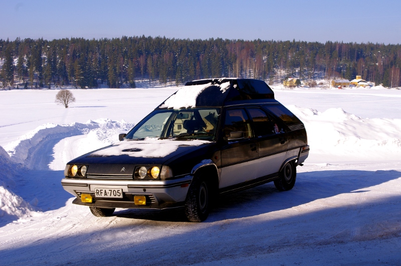

Well, it took us home from 250 km away, and prevented poisoning from the exhaust fumes (which somehow find their way to the front of the cabin after such a pipe break, apparently due to some extraordinary aerodynamics in the rear bumper area).

Yes this has been mentioned on here before, if the exhaust tail pipe isn't just the right length (too short or too long) it appears to get sucked into the cabin.rmattila wrote:Well, it took us home from 250 km away, and prevented poisoning from the exhaust fumes (which somehow find their way to the front of the cabin after such a pipe break, apparently due to some extraordinary aerodynamics in the rear bumper area).

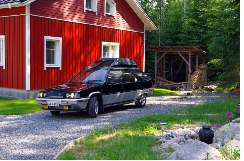

The first real spring day - finally warm enough to take the new family member for a short trip. CX spheres in front an DS spheres in the rear really make driving her a smooth experience.

The black Van was built from a "regular" red one by a well-reputed small Citroën oriented shop, and the new spheres were part of that package. I have a sphere filling equipment at home and refill the spheres once a year as part of the routine maintenance, using a slight overinflation (65 bar or so) to make the ride even better than with brand new spheres. Still it feels that the black one is the smoothest, so I guess the CX/DS combination has some effect.Defender110 wrote: I'm intriqued about the CX spheres on the front and DS spheres on the back. How much does that alter the ride. Did it just improve the ride because your old BX ones were worn out and did you just fit these because you hapened to have some or is it a recognised improvement that you deliberately made
For a long time, it was a Finnish MOT requirement to have headlight washers in automobiles. Some cars had the equipment when leaving the factory (Saab, Volvo etc.), and they had proper wipers. Other cars needed the equipment to be installed by the importer, and the simplest way was to fit spray nozzles in the front bumper. It was approved as fulfilling the requirement, even though it's clearly inferior to a real wiper arrangement. I'm not quite sure if the BX ones were installed by the importer or at some earlier stage of the chain.I notice the overiders on the front bumper of the red one, are these a Citroën fitment?
