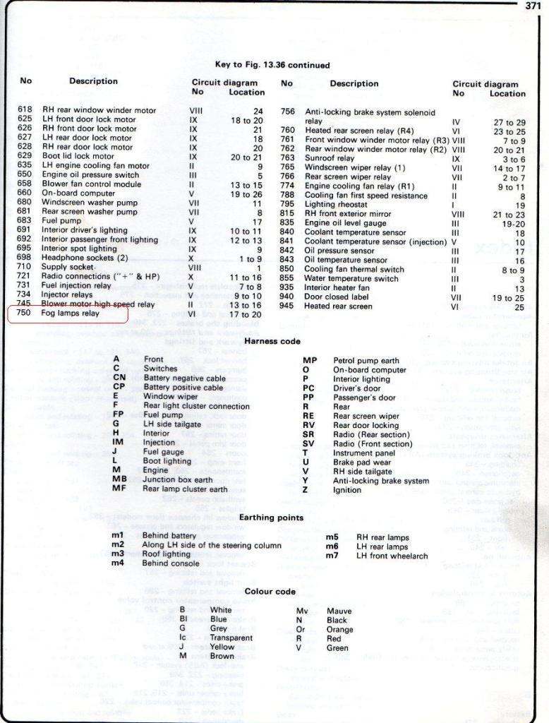

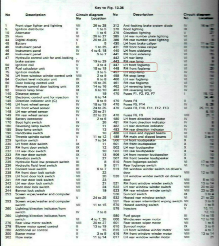

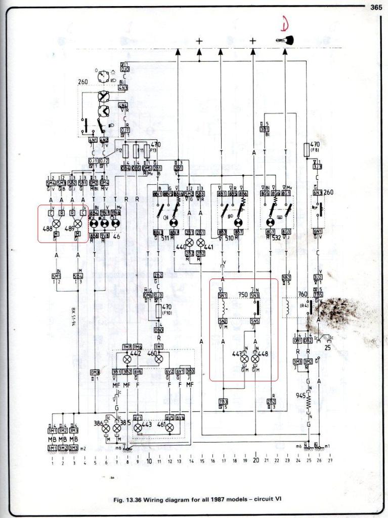

I had to check on the circuit diagrams in Haynes just to be 100% sure. The fog lamps have a relay, but not the headlamps.
Headlamps are 488/489 in the circuit, each lamp (main and dip) is shown as a circle with a cross, with two feeds, one for main, one for dip. No relay for headlamps (260 is the switch block on the end of the stalk)
Fog lamps are 447/448 in the circuit. Fog lamp relay is 750.
I've put red boxes round them, but the red is not very bold.
