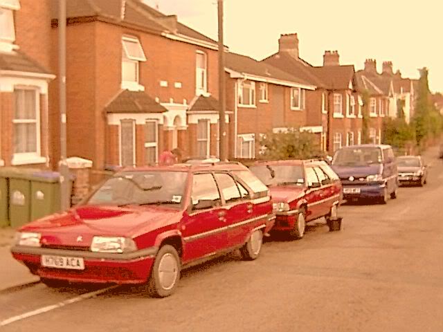

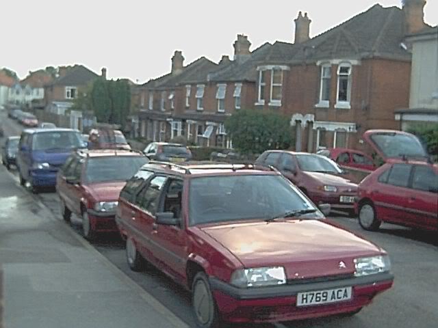

Update (8 days later) - After 24 hours, this is what a well t-cut red BX looks like next to its long-lost-cousin. T-cut by Sheppard, colour by Jamcam and Irfanview - colours not a true relection of the world but intended to show the degree of shine possible ......
toytown view (well, I did use a Jamcam)
and the dark side....
