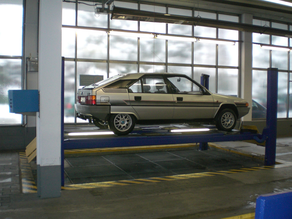

Well, today was TÜV day. Full of snow.
Bad news is that it failed, good news is that I'll be back there first thing tomorrow with everything sorted.
Failed on :1. Non working driver's window.
2. Both headlight adjusters broken and thus lights out of alignment.
3. I didn't have the TÜV certificate with me to go with the alloys to prove they're suitable for this car!! ( I don't know what you lot will think of them - they're BW Francor Champs c.1998 and are shod with winter tyres)
The inspector was very nice and knew BXs. He said it was a sound car - good mechanically : brakes, body, emissions, suspension etc .
I came back and took the headlights off the yellow one which now sits there 'eye-less' in the barn.
The electric window was a bit of a palavar. The things has two 'runners' that are bonded to the window glass with double sided tape! (??) One had come adrift. Luckily I had some heavy duty tape and now it works..
Here she is at the TÜV. I left the louvre at home!

That is an amazing picture Toddao!! What a motor that is! It looks like a brochure photograph (although no car manufacturer would have an ad piccy of one on a ramp!
) Truly stunning mate. For once, after market alloys that kinda suit as well - although speedlines really are FTW you understand!
Am liking that 'alot' mate!!!

Bloody nice looking ramp!
Inspection lights and everyfink! Me want!
Stunning photo dude, really stunning, nice wheels too, but as per El Bandito, Speedlines FTW!
I'm glad I dont live in Germany! they even check the windows?! How bizarre!

Thanks for that fellas. The photo was a fluke - it was just sat there looking like that and I pointed the camera at it.
The wheels are 14J and are suitable for 165/70s ( which is what I've got), 185s/195s. I originally got them for the 16v but they were lying around and I needed winter tyres on something.. they were made by the same people who made the 'Swift 2s' that I had on the yellow one.
Was a right headache by the TÜV today with them. They inspected them for half hour - though the condition is perfect- with a dental mirror looking from the outside inspecting every spoke! Then decided they weren't legal til I showed them that the 'papers' that came with the wheels definately showed they were suitable for the BX. An arguement followed which ended with them getting egg on their face when they realised they were wrong. I then had to pay €38 for the honour of them being 'legal' and thus get their model name printed on the car papers. What a farce! I should have fitted the winter tyres on the normal steelies and put the alloys on at home!
So, after that, they were nice as could be. Everything else was in order ( though the window goes up and down it's a bit wonky!), I get the papers. Then it's a ten minute drive to the next office to hang about for an hour, present a huge pile of certificates then finally get the number plates and two years road worthiness and pay aload more wonga!
The title of the post was 'TRD problems' - here ends the problems. For this week anyway!
( see The Gallery for the non-problematic news!)
Once again, thanks comrades for the support when it was looking like scrap metal!
