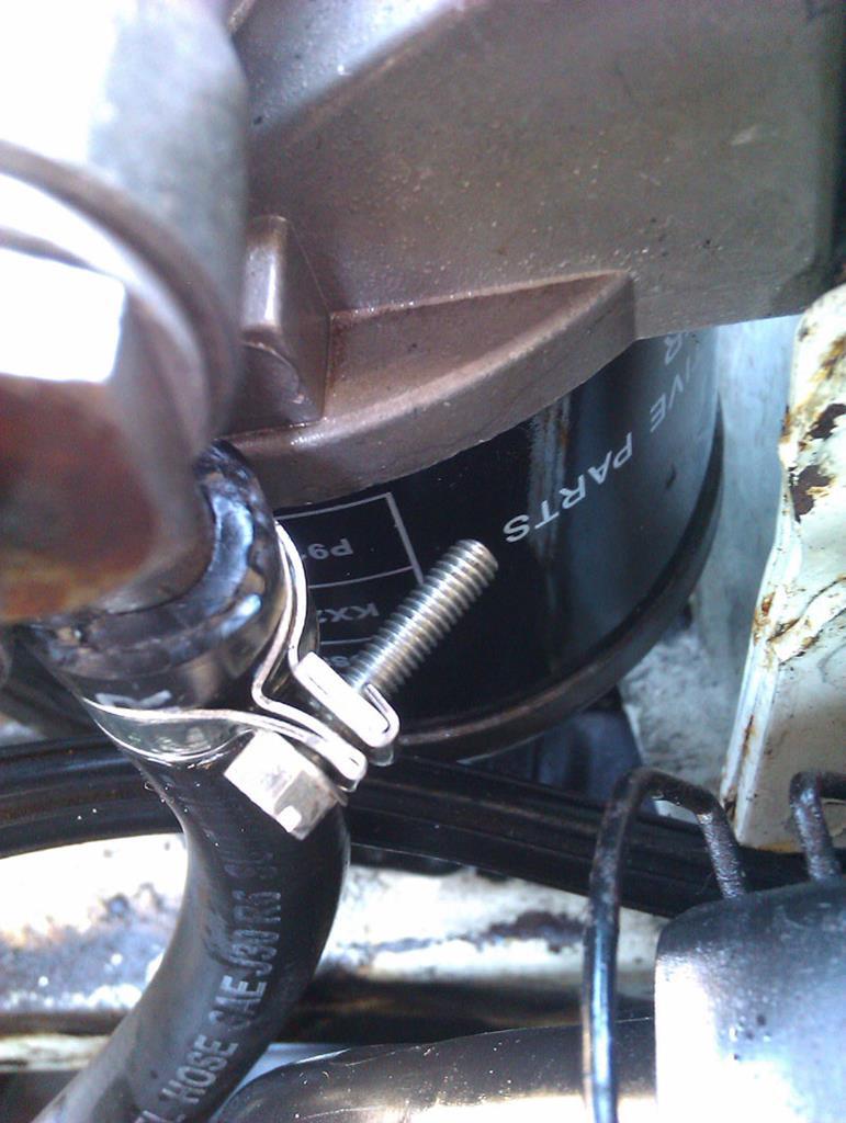

Spurred on by the success of that brake light install, I was delighted when the new fuel filter arrived today. I was very hopeful that I'd finally get to the bottom of this air leak that was making the car undriveable. Fitting the new filter gave me a eureka moment on the fuel pipe routing between injector pump and fuel filter housing so I finally resolved that. Everything is a bit snug, but nothing is kinked or chafing so that'll do me fine. The filter isn't on upside down, that's the only way up it goes, for some reason the print on it is upside down to usual. The new seals with the new filter fitted very well and, after bleeding the air out and priming the system, the car did eventually start and none of this leaked.

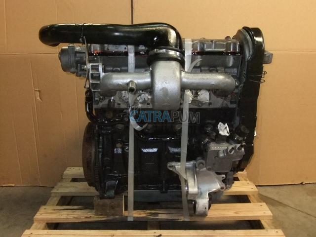

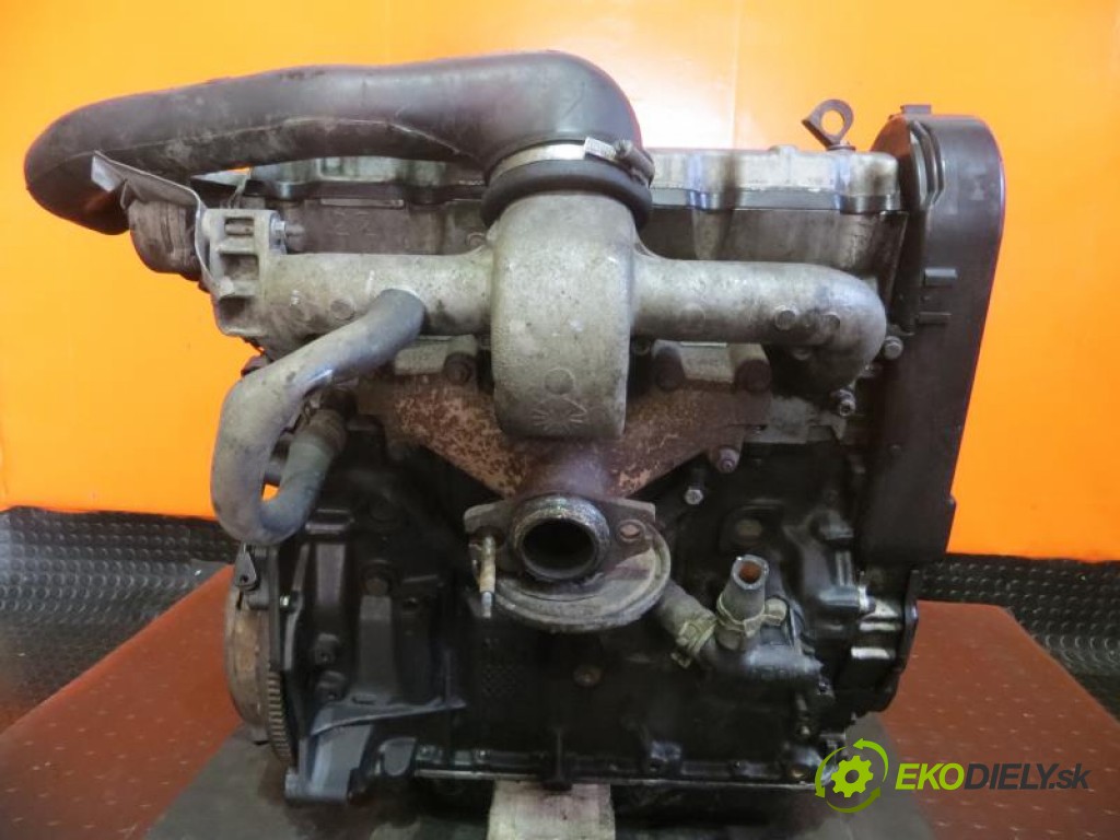

AIR LEAK NEWS
Having gone over the various tips and advice, I was all geared up to try and do this and then realised I can't for one reason: I have no idea what I'm looking at. After much searching through the manual, the forum, the internet, I can find nothing conclusive about what the fuel preheater looks like, where its located, or how I might bypass it. All I can find is people saying "simply bypass the preheater".
My best guess is that it's the silver square-ish box to the bottom right of this image.
But also that the one on my car isn't going to be that design because it's older, so it's more likely this black one in the same location.
The reason for me thinking it's that piece is that's the side of the engine the fuel lines run, and more people say it's "on the back of the engine" as the location than anything else. Some people have told me it's near the fuel tank, but that doesn't line up with anything I can find. Unless I'm being spectacularly blind, I can find no reference to this part at all in the Haynes manual, and a search online to try and find anyone stocking a replacement (so that I can at least see what the part looks like) has been equally fruitless.
So, how do I "simply bypass the preheater"? What does it look like? Where is it located? I've looked under the car and while I can see something that looks like it might be that thing, without knowing if it is that thing I don't want to go unplugging stuff until I know at least a little bit what I'm doing.
