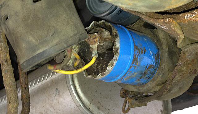

Not sure about that, it looks like the terminals on the pump itself are a bit shot. Photo isn't that great but you can see the general mess in that area:citsncycles wrote:Not an expert on fuel injection systems, but if the pump runs on pressure it may not run constantly anyway.
Would it be worth trying to clean up the rusty connection (or even replacing it) before bying a complete pump?

???Melchior wrote:While the engine was running I could hear and feel the pump running but it was NOT constant. Seemed to be randomly going on and off - more off than on.
Next step - new pump...
Then it sounds as if the pump is working normally as the rail is pressurised, it will be commanded to run more frequently by the ECU as higher fuel demand is assessed. I suggest you are chasing the symptom rather than the cause. The cause is likely to be gummed up injectors as mentioned before.
