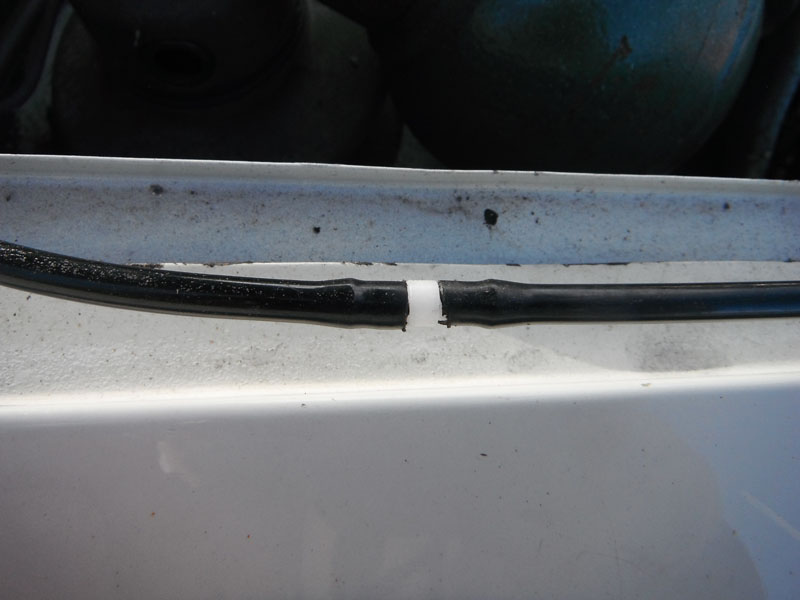

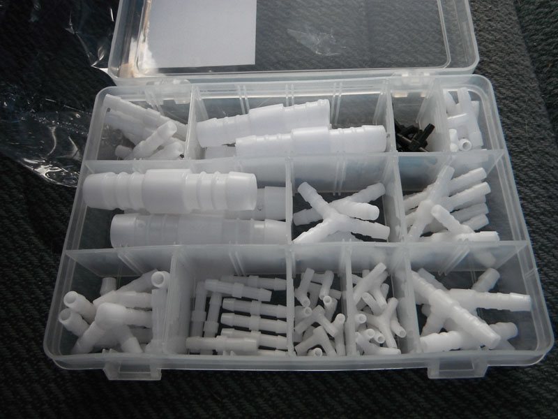

The other day I acquired a box of hose connectors. It was significantly cheaper per unit than ordering the one I needed separately and I'm sure they'll be useful in the future.
Reason being, I wanted to get that return line repaired. This was nice and straight forward. I just finished the cut I accidentally started with the angle grinder, using decent clippers this time, and then gently warmed the snipped ends of the plastic line before insert a double-ended barbed connector. A nice clean repair and is also quite effective. To help it seal, I wafted the heat gun over the whole thing afterwards so the pipe conformed closer to the shape of the connector.

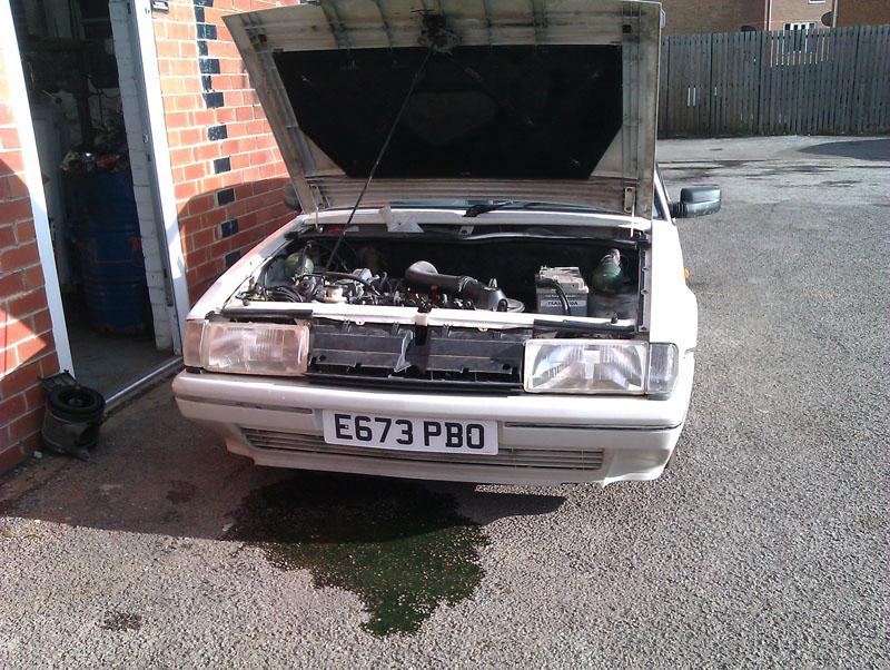

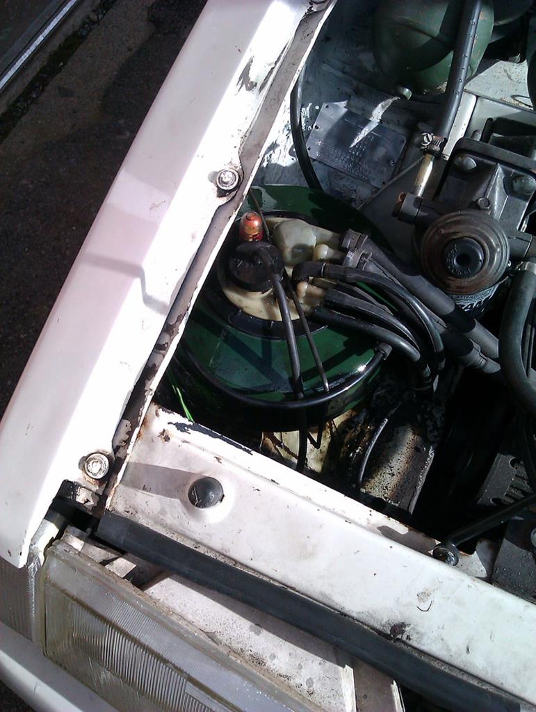

That was important to do so I could fill the car up with LHM. The bonnet is sorting itself out, slowly, and even though I've had a fiddle with what little alignment is available I've come to the conclusion it's definitely the bonnet itself at fault, not the surrounding bits and pieces. Shown here is after a few days in regular weather, I did notice at the end of today's efforts with some temperature in the engine, it had improved further. I'm hopeful a few hot engine cycles will persuade the panel back to a better alignment.

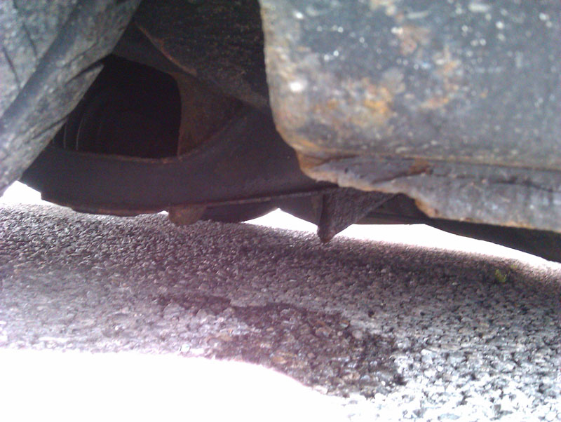

Mike had mentioned there was a patch of something under the BX, from his description it sounded like it could have been the side we'd fixed. Today, by chance, I ended up swinging by the unit so I could get a look. There is indeed a patch of something under the BX, and that something looks like LHM. It's not a big leak and it's dripping from the bottom of the trailing arm.
I didn't have time to have a look underneath and investigate further today. I'm wondering if it's the union for the new pipe that goes into the height corrector weeping a little and just needs tightening up a bit since that's in this sort of area. It could of course be something else, there's plenty of things that can leak. I'm not overly concerned because it's not a bad enough leak that it's constantly dripping or pouring out when the system is under pressure. I'll investigate over the weekend if the Princess jobs go smoothly and I have time.

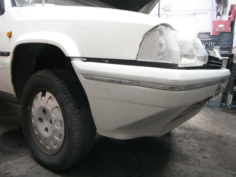

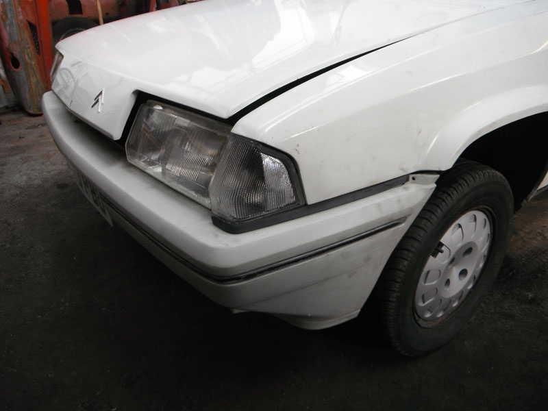

Right then, been a while since I updated here, things have been busy so there's not been a lot of BX fettling time available. I had a look at the windscreen seal to see what was needed today because, when I was inside the car, I noticed the passenger footwell was damp. Since I've no sunroof and as far as I'm aware the door seals and window seals are good, I assumed the heavy rain combined with the not-quite-sorted corners on the windscreen seal may have been the cause. A quick investigation revealed the windscreen trim seal hadn't actually stuck down for the most part and while the windscreen appears well bonded to the frame, water had got in under the rubber seal. I spent quite a bit of time cleaning out the sealant from the channel between the windscreen and the windscreen hole before rust treating everything so that anywhere I'd scratched through the paint and any residual surface rust was not going to be an issue. There was space inside the unit today so I could leave the BX indoors for the treatment to cure before applying fresh sealant and reapplying the rubber seal trim.
The leak at that back corner hadn't reappeared and indeed, the suspension is fine. So perhaps that was residual from some other problem. With the BX indoors I'll be able to see if it's leaking afresh when I next visit the car. Where last time the bumper absolutely refused to sit in place properly, this time it went in with merely moderate effort, on my own. Just as well really since Mike was busy fixing other cars today so it was good not to have to pull him off those jobs to help. I didn't have any washers or screws with big enough heads for the bottom bumper holes so I couldn't put those in at the moment. That said, with the side slots and top three screws fastened down the bumper is a very snug fit now (bonnet isn't fully shut in the first shot).

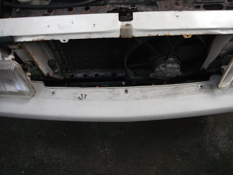

Also remembered to reinstall the grille.

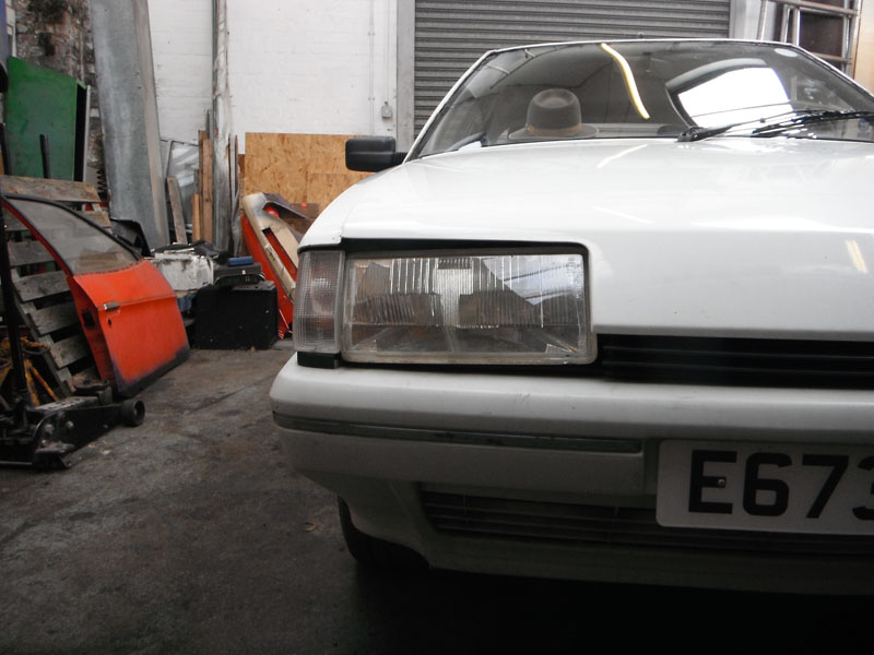

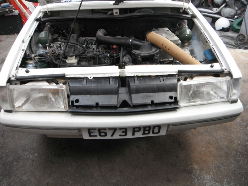

The bonnet has settled a little more, it's almost where it should be now. For some reason the headlight on this side is sitting wonky, if I got it straight then it popped off the bottom inner ball joint so I'm not sure what needs adjusting there to sort it out.

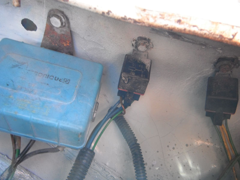

The electrics have come over all French. The rear drivers side light cluster won't work at all. I've cleaned the connectors, the bulb, the sockets, the earth points I could find, and nothing. This is very annoying because it was working perfectly fine. The front side repeater on the opposite side and the front sidelights on both sides have also decided to go on strike and have been similarly disinclined to cooperate. As a result, left the car like this because I couldn't really go any further.
There was just one last job I did which was to refit the back half of the exhaust which quietened the car down considerably. The glow plug relay gave no bother at all today, suspension is working lovely, brakes still nice, etc. Just to get to the bottom of the electrical gremlin really.
