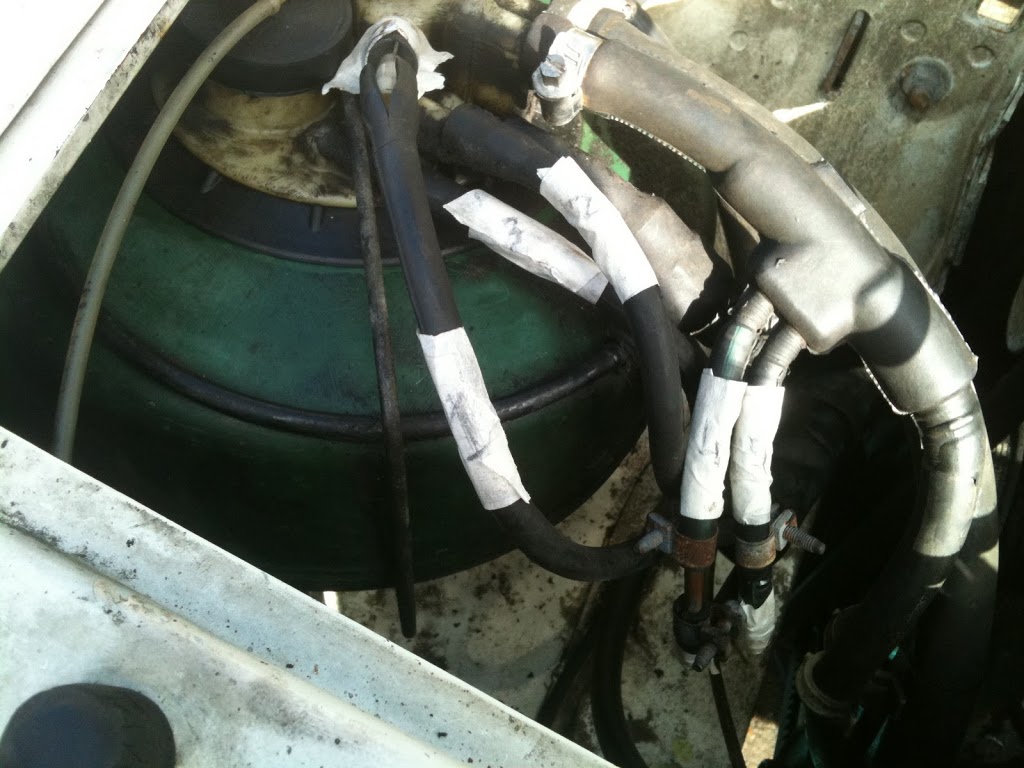

A long overdue update, now that work has started again on the BX.
Octopus. Octop!ss more like...seemingly from every damn joint on the thing.
All the low pressure pipes were cut and joined and bodged, and there was no choice but to get a new octopus, which I managed to get for a good price from Phil Chidlow. Now the weather was warming up, and the neighbour wanted her (somewhat greener and oilier than before) drive back, it was time to move the BX to my brother Graham's and begin.
So... remove old octopus, marking up the pipes to avoid confusion, and then fit the new one. Nice in theory. In practice however, it was, and continues to be, a complete pain.

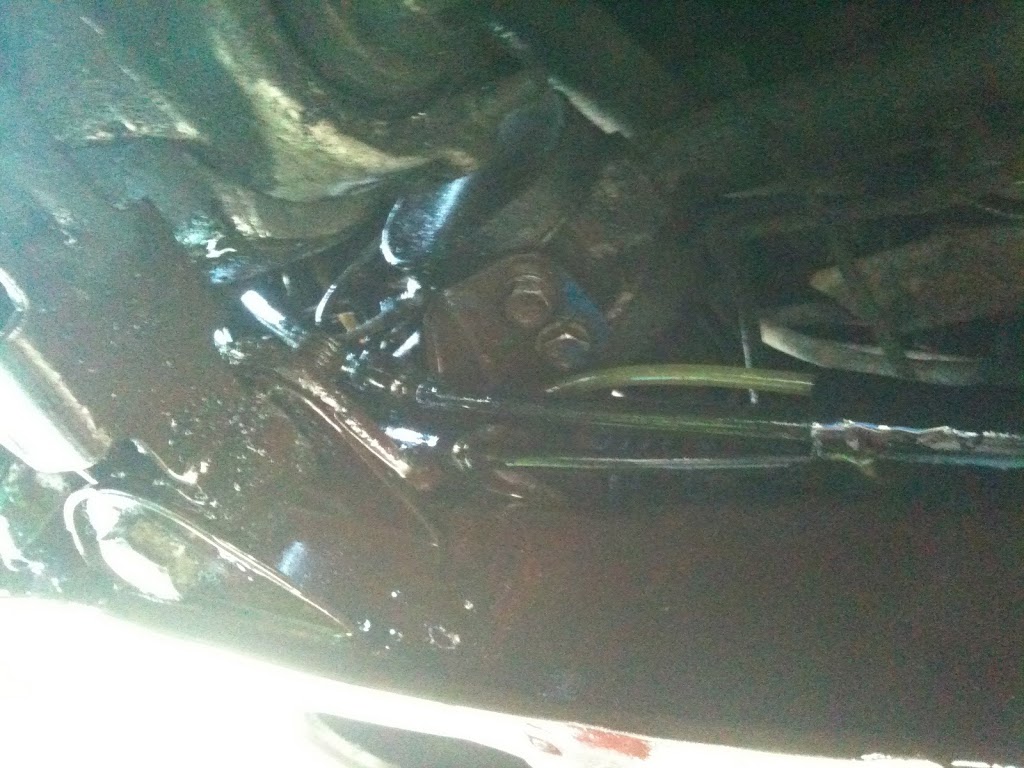

First problem is that the whole underneath of the front of the car was covered and I mean COVERED in old LHM, and what appears to be oil from a leaky sump gasket. Even going near it resulted in becoming absolutely blathered in this stuff.
Given that I had to put a litre of LHM in it to get it to my brothers (less than a minute away), and the splits in the octopus seemed to multiply as soon as it was touched, there was quite a lot of it around, and that Graham's skin and oil just DON'T get on at all (not to mention his hallway carpet...), you can imagine some of the things he was calling the car, and me for buying it...
Despite what people have said, it seemed there was no possible way of reaching the octopus "body" without removing the driveshaft (though it could well have been fitted in an odd location...), so lots of grumbling and swearing later, and the path was clear. The path to getting more covered in old oil that was filling every channel on the subframe, and clinging to pretty much everything else, that is...
Once the old octopus was detangled from everything and removed, it became clear that it had been completely shagged, and had lots of previous signs of repair, and some pipes didn't seem to be connected at all!
It also became clear that the careful marking up of pipes (didn't have coloured zip ties, so used masking tape labels) had all wiped clean/fell off. Oh poo.
After extensive googling, I managed to find some pictures of what goes where, but the accompanying text was in Japanese that displays as Unicode gibberish (not that I understand Japanese anyway..) so it wasn't as helpful as it might have been...
So, after some struggling, Graham managed to connect it up, though we had the fun of pipes not being long enough, pipes that simply don't fit where they are supposed to go, and a fair bit of bodging on our part also. If it wasn't for the fact that there is only one octopus for every BX, we'd have been convinced this was the wrong one. Could my car be so different? What was going on?
In fact, what IS going on? Every time Graham thinks he's sorted a leaky union, another one appears. When the offside of the car was sorted, the leak simply moved to the nearside. More swearing from Graham, and more sarky comments from his Ford and Vauxhall loving mate from 4 doors down...
So... is it possible that 2 pipes are incorrectly connected together, rather than returning to the tank? This would (to me) explain the leaks and occasional blown off pipes, but then so would the state of some of the pipes, and unless I'm getting it completely wrong, all the octopus does is return the surplus and "leaked past" LHM to the tank. I can't see how it is possible to connect 2 things up to cause the scenario I've described, though as I've said before, I'm not much good at this side of things, and Graham's never worked on one before.
The biggest problem is that the pipes as they were were already clearly in a mess, and it's difficult for us to know if everything is in the right place or not. Everything seems to work ok (as I suppose it would, as we've not touched the high pressure supply side of things...) but we still get leaks from places.
So if anyone has any advice, I'd be more than happy to receive it. I don't want to give up with this car, I want to give it the treatment it deserves. Unfortunately, there's been some very tempting sorted cars for little money recently, and my eyes have strayed a bit.....

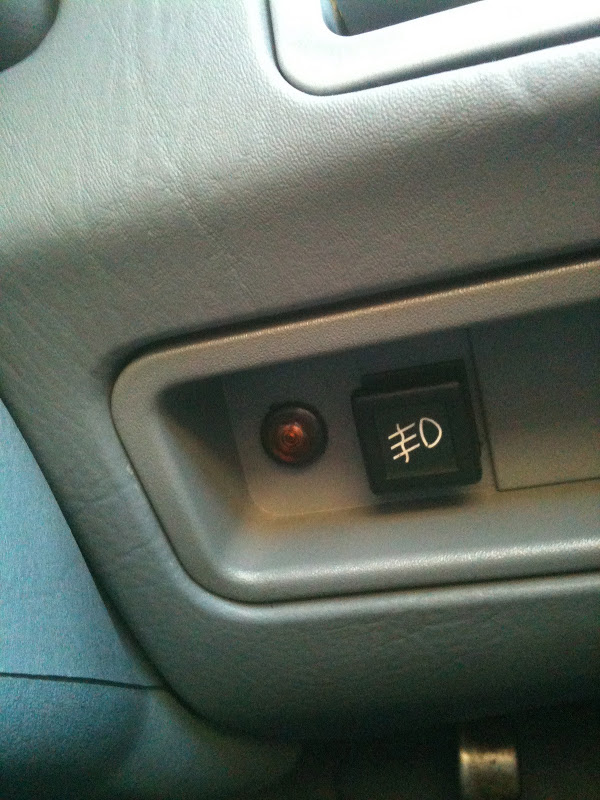

Finally, whilst looking at how I'm going to wire in the front fog lights, I noticed this round yellow light, which I'd always thought was the tell-tale light for the front fogs, had a bulb-holder and wires already.
I noticed the bulb was loose, and not in the fitting. I reconnected it, and found it flashes briefly once when the indicator is first applied (left or right), but nothing else makes it light. Does anyone have any ideas what it might be? I thought alarm, but I can't see one anywhere...
