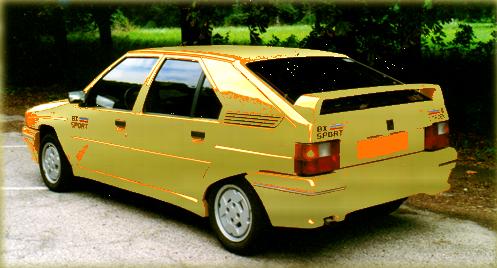

the estate being a bit more slab sided though,
Yes you're right - different bodyshells seem to suit certain colours better than others - perhaps I should fiddle about with some blue screen stuff to see what it would look like.

Like this... only with more time spent / attention to detail etc :-)
