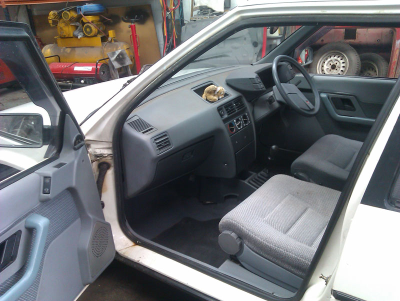

I gave the interior a much needed vacuum, wiped down the vinyl, cleaned the glass... it needs a proper deep clean at home but at least now it smells nicer in there and isn't covered in dust and workshop grime.

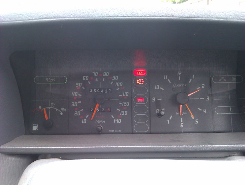

The other thing it did, on a long uphill slog, was put the STOP light on and the low coolant light. Quite alarming after so many uneventful miles so we pulled over onto the hard shoulder to investigate. Loads of coolant, nothing too hot, and a wiggle of the coolant sensor/temp plug resulted in the lights both going out until after the MoT (phew!). Problem here is just a corroded connection. The lights were on most of the way home, intermittently going out, and the glowplug light kept flickering too. Both are down to slightly crusty connections since a very quick sandpaper of them at the unit managed to get all the lights that shouldn't be lit to go out again. I need to get some switch cleaner and sort this out properly.
There's few things more alarming than that angry STOP sign when you're bumbling down the motorway. The other issue on the way back was a very sharp corner catching me out and the Michelins doing their usual trick of trying to understeer me off the road. I don't really get the raving for Michelins, whenever I've driven a car on them they give absolutely no warning that you're past their limit. I will concede the tyres are quite old and the roads were wet, but I was well under the speed limit so it shouldn't have happened at all. Just as well new tyres all round are a job for as soon as I can get it booked in locally. That was really the only drama for the entire day. Drive out and back was otherwise uneventful and it really is a pleasant car to drive, I could easily rack up many miles in it. Now its home I can get on with a proper deep clean once the wheather improves somewhat and I've a schedule of maintenance to work through.

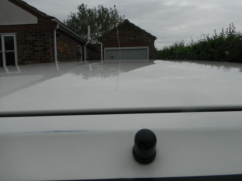

Downtime today coincided with a pleasantly overcast day which meant it was ideal for doing claybar work. Anyone that's tried to clean a white car outside will know how annoying it is to do if it's a sunny day, overcast is far better.

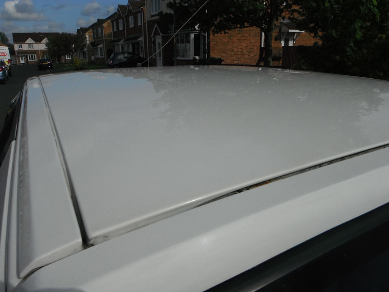

The roof was much dirtier than I expected especially since the car had mostly been under a cover. I couldn't do the whole car today, I didn't have time, so I just focused on the top half and the driver's side half and I'll do the rest over the weekend when I have more time.
Top of the doors were also surprisingly dirty.

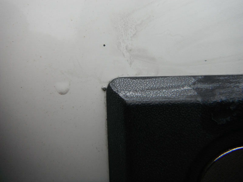

One great thing about the claybar is that it will, with persistance, get rid of that sort of dirt tidemark you get around badges. Before, during, and after shots. It takes a while, but it does eventually clean off all those stubborn marks.
The bonnet was much the same story as the roof. The bumper I treated to Cillit Bang degreaser and a scrubbing brush which got a lot of the oily dirty off, now I have to go at it with Cif bathroom cream cleaner to get the ingrained dirt out and bring the plastic back to its original colour.
Paint on the roof is reasonable. I know there's a section of repaint at the front from windscreen repairs before I got the car, it could do with some very fine wet and dry and a polish just to blend it out nicely. There was a lot of grinder spray across the roof where it hadn't been repainted and this seemed to be the bulk of the dirt. However, once cleaned back and given a coat of wax, the paint was looking and feeling much nicer. It's more obvious in person than on camera.

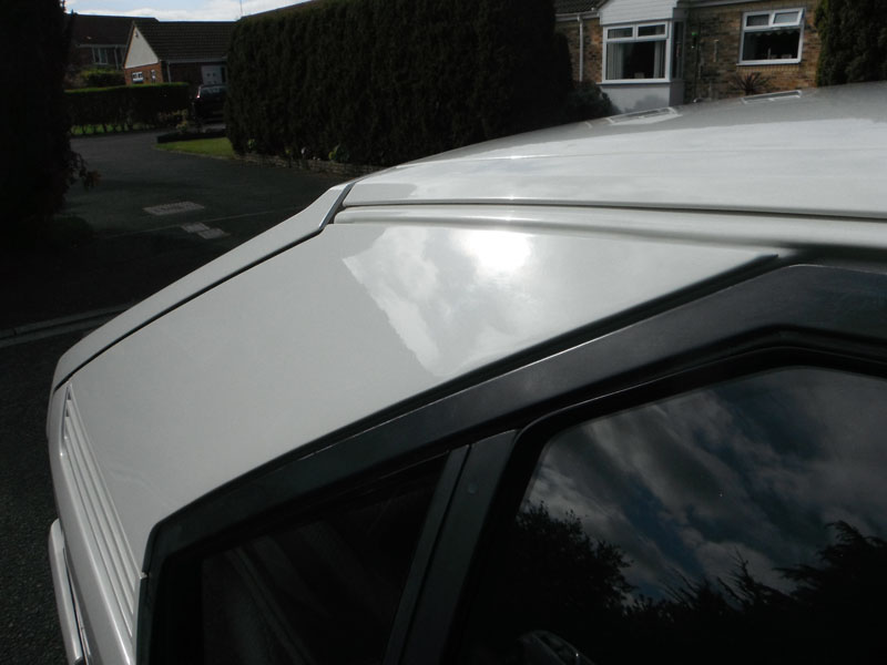

I got the other top half of the car clayed, which required a lot more work than I was expecting. Then I T-Cut everything I'd clayed which took the polishing down to the bodyline just above the door handles, and then waxed everywhere I'd T-Cut to protect the finish. T-Cut is ideal on the solid paint on the BX and dealt with some of the marks that the claybar couldn't remove, leaving the bodywork very smooth afterwards. I did it all by hand, there's no need to get into machine polishers until I've got everything cleaned right back and waxed so I can see what I'm dealing with.

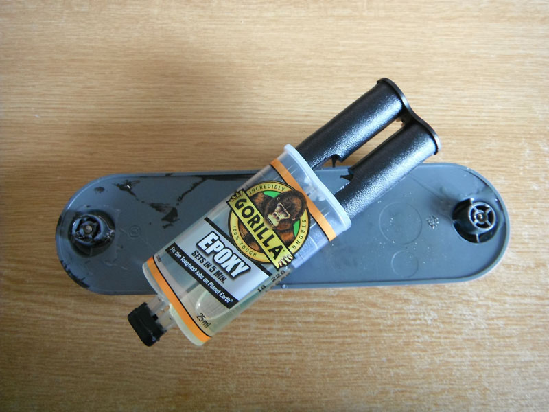

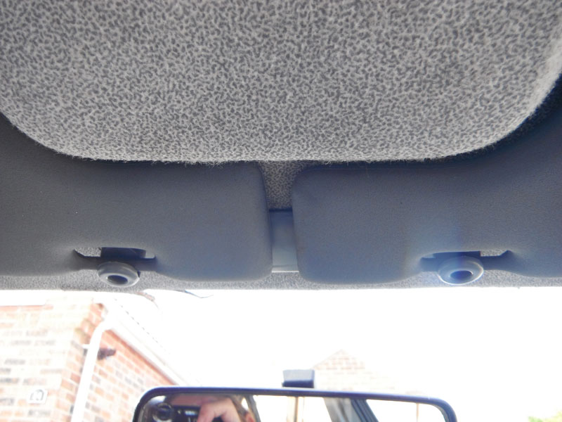

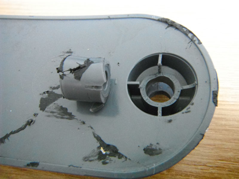

One thing that was bugging me on the way back home was the sunvisor clip jiggling a bit. I knew this was broken when I collected the car from Dean and hadn't investigated further. Fortunately, all that had broken was the spacer column and the break itself was clean. A black sealant of some sort had been used to attempt a repair which hadn't held but that meant it was really easy to clean back and repair more properly.
Once set, I put it back in the car and now the sunvisors aren't jiggly any more. It feels quite solid and I hope it lasts. I tacked the two pieces together with superglue first to get them located, and then filled the void in the back of the piece with the epoxy, since I had some epoxy left over I put it in the good side too since it wouldn't hurt for that to have a bit of extra strength as well.
