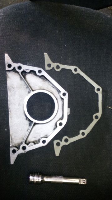

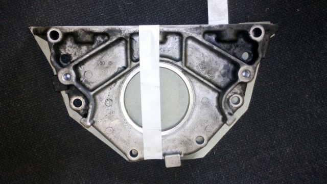

i had the sump gasket come through the post yesterday.. i am still waiting for the crank shaft seals and engine paint though guhh
i am also going to take in the jetwash again and jet the engine clean.

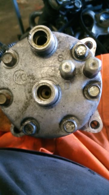

also just some pictures of the standard BX air conditioning compressor showing refrigerant, oil type and rear pipe and charge points.

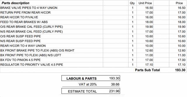

ordered 10 litres of LHM too.. i am expecting the hydraulic system to be a damn pain in the backside. (after all, why are there not may Citroens with hydraulic systems about now)
Ideally i would change ALL of the bad looking pipe, but i just cant justify paying £155 for a flare tool, then and extra £45 to £60 (times 3!) per length of the 3 pipe diameters i need then all the seals and unions. thats close to a months pay for me right there!
anyway at some point i will paint the block Red and maybe the head. i am on the lookout for another Bosch fuel pump as i have been told that the one i have (with it being half ECU) wont work. (too much save the planet stuff built into it.. though i must admit, AFC.. Auto Fuel Cutoff would be nice when coasting.) sadly these pumps are quite rare.. after loads of people coming back to me on the 306 D turbo group on facebook telling me that they are everywhere... i cant find one! and as soon as one comes up for sale, its instantly bought! sigh.. good thing i am not on a time limit for this.. but i would like it finished by the new year!
yeah not much has happened. amazon delivered my brake calipers along with.. something else i forgot what it was now.
the engine is still out, i jetwashed the replacement engine, took the gearbox off the original engine and jetwashed that too.

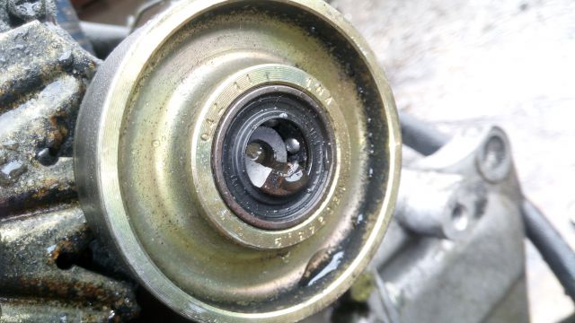

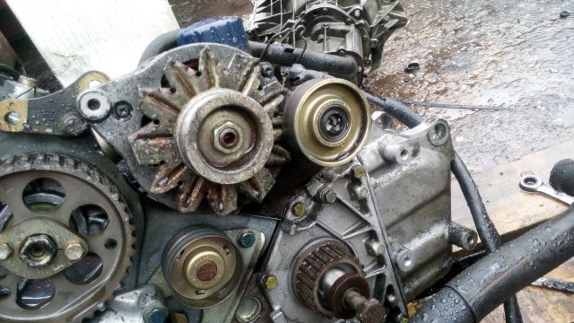

i had a bit of an issue sadly and broke of an auxiliary belt idler pulley.. i tried to get inside it to re-grease the bearing and sadly snapped off a chunk of the inner bearing race. naturally this part is now discontinued and being a BX with aircon it is going to be impossible to find.. but i think i can just make another one using a larger bearing and loads of washers cut to the right size to stop it moving around on a replacement bolt.
damn it..

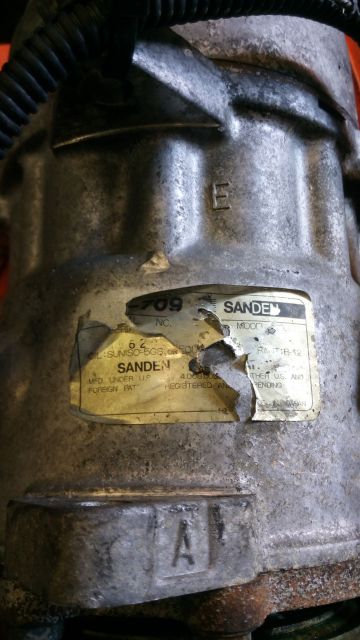

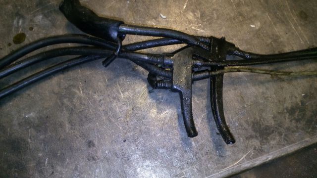

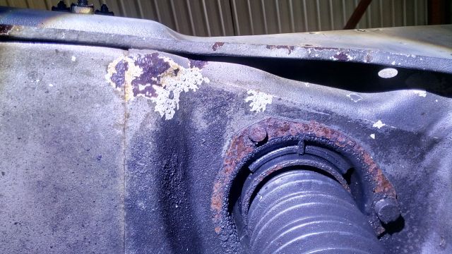

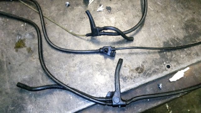

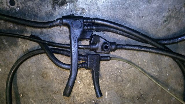

ahh so i have done a bit more work on the BX.

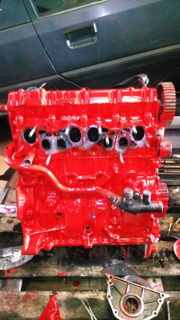

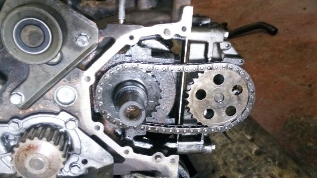

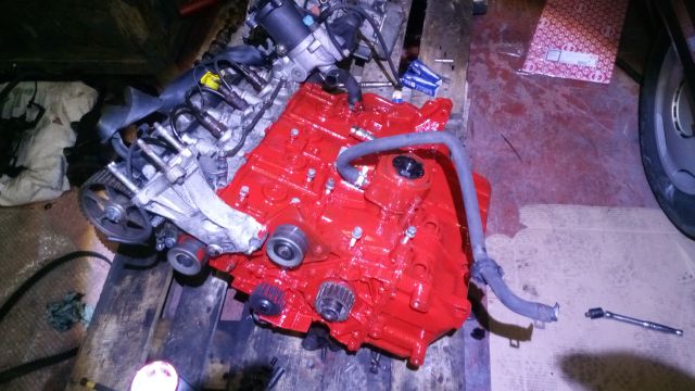

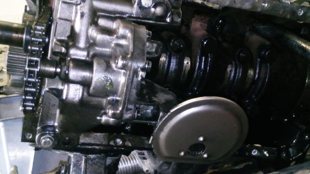

so the engine now has had the oil pump swapped over (for the slightly lower miles one). i am not sure if i should have, but i made a gasket for the oil pump chain cover too.
its a bit mucky inside with some oily buildup, i cleaned it out the best i could but when i have built it all up and running i will run some cheap oil through it with some engine flush.
anyway. the replacement BX cam shaft has been installed, the 4 shaft oil seals have been renewed (crank and cam), the oil sump from the original engine has been swapped over to the replacement engine, the cam cover oil seal and sump oil seals have been renewed, the water pump has been changed, new Bosch glow plugs installed, and the engine has had a bit of a quick lick of paint just to see how it's going to look.. and boy does it look nice!

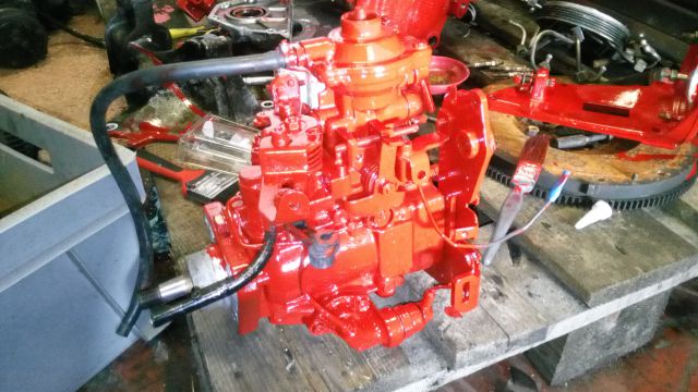

i will be painting the whole engine red plus the gearbox, pumps and alternator. agricultural/marine style.

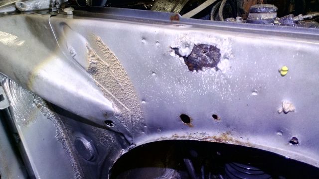

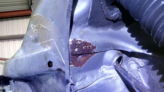

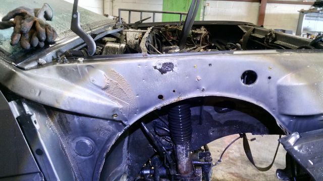

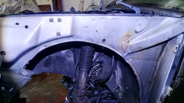

i then started to remove the drivers side wing, the wing skins (both sides) themselves are in fantastic condition. ok the paint has gone a little thin but dent and rust wise, there's none!

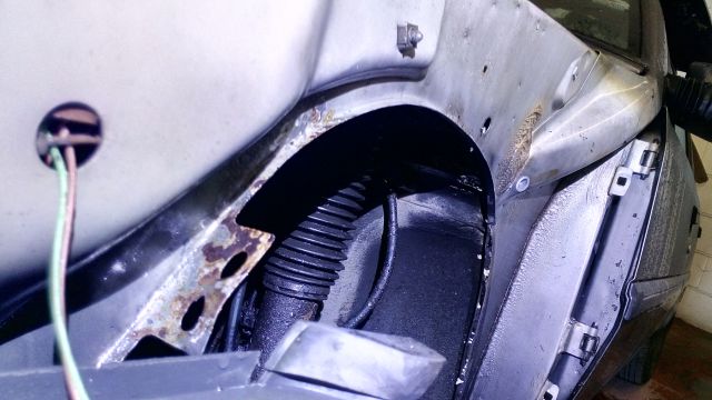

under the skins on the shell its another story. though not bad (given the age of the car) we do have a little rust. i knocked out as much as i could and even got the jet wash in there to clean it up a little more.
i also took all of the brakes apart too as i am replacing all of the brakes.. the fluid in the brake pipes.. did not look like LHM :/

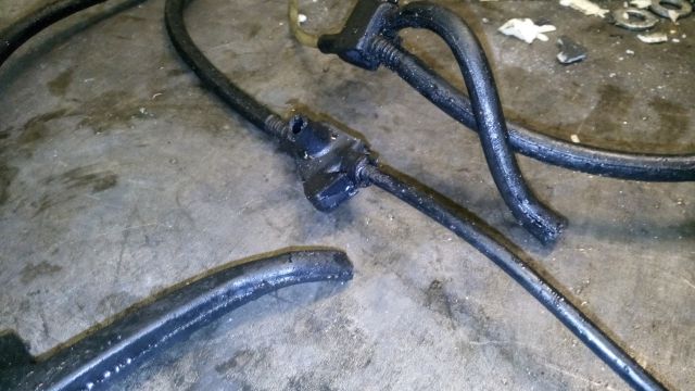

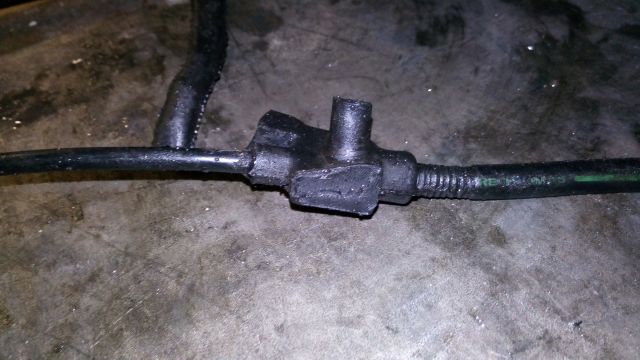

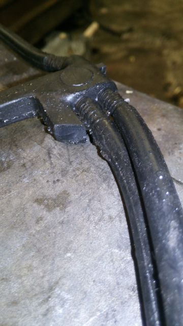

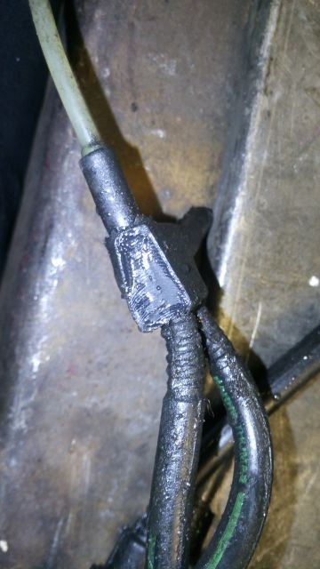

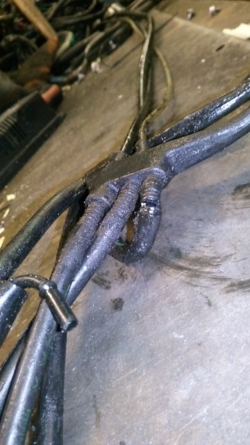

i also found this nice pipe with a few good splits in it, the one on the other side was completely split with a section of the 2 pipes missing!
now for the other side to be removed.. and.... oh my! it looks good in here!
just a little bit here..
... and a bit more..
but as it goes.. better than the other side. nothing i cant fix!

well for the price and peace of mind, i think its a good idea.. as you say, all of them are cut with unions and flares.. i am not sure if they come with seals but i can get them from somewhere.
thing is, if i replace them all with this new stuff they will last the life time of the car.. or longer! if something happens to the car, i can take them off it and use them on my next one (as i would buy another)
here is the price list of all the pipes (for a Citroen BX Diesel Estate with ABS) from Pleiades:

Re: John Dragon Man's Citroen BX Diesel Estate
righty ho!

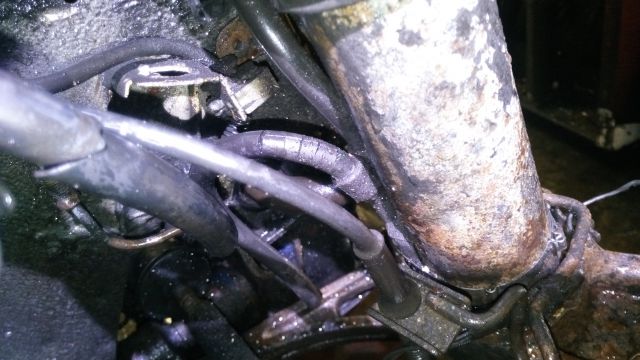

so today i have been pulling most of the returns out of the engine bay, they are a pretty sorry state with multiple splits laddering all the way up the pipes. needless to say i will be replacing the lot with nylon "air tubing" pipe. i have had great success with this stuff before using it to transfer oil on the waste oil burners i have built for my workshop (even used it as petrol fuel line on my old panda!).
so i have uncovered "The Octopus". i am not going to say how i feel about this thing other than wanting to nominate the designer for a great design award.
with most things broken i decided to take it apart.. as i will make my own haha.
so here we have it as i took it off the car.
splits n all
so i found out what all of the pipes do and what pipe connects to what... and i found out that the octopus is in 3 parts.
and where i have cut it, there are no internal pipes
as seen:
so that said, it looks like this thing would be quite easy to make out of simple T pieces and say 6mm push fit tubing (which is rated at a 10 bar connection! 16 bar for the other kind!)
so to be a little colourful i am going to buy a 30m reel of lime green 6mm air line, a load of push fit connectors and renew all of the return pipes. just wish you could do the same for the high pressure stuff.. sigh.
i will of course have to use some rubber (fuel line) pipe for connecting to metal returns, but that is stuff i can keep an eye on more easy than the whole lot!
while i was under the car i also changed the drivers side steering rack boot/gator. nice and easy on that side! the pass side looks a little more hard.. i take it that i have to unbolt the hydraulic actuator arm from the rack to fit the boot over it? i will have a go at it tomorrow!
before i put it all back together, i will replace the ball joint dust covers and give them a little more grease too. i am shocked that none have any play in them! then again, all the dust covers are in pretty good condition!
even the anti roll bar bushes do not seem to have any play or even ware in them! makes a nice change to be fair..
all of these pipes though.. its giving me a little bit of bewilderment.. i just hope i can figure out where they all go!
i did see a nice picture of the top of an LHM tank and it was labelled as to where all of the pipes came from. if i follow that, i should be OK. the best bit about using this air line is you can just cut a pipe anywhere and use a connector on it. really, if you have never used this stuff before, i recommend it! (i have even used it on model steam engines!)
i will report back tomorrow on the success/failure of fitting the pass side steering rack boot/gator.
splits n all
as seen:

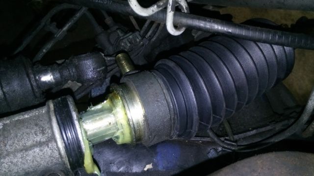

hmm guess i forgot to reply back to this.. anyway.. one week later.. ahem..
the gator has not been done yet.. heh i have some universal ones that i have used on the drivers side and was going to use on the pass side. however i find that they do not "fold" small enough. the gator gets sort of crushed when on full lock to the point where it actually folds in on its self!
it looks like it would happen on the hard side to replace them on too. so i went out and bought from ebay, a pretty expensive gator.. and found that it will do the same thing as the cheap universal one. sigh
i also painted the rest of the engine.. making sure i got the paint everywhere on all of the pulleys (not intentional). i am not too fussed about that as it will be under the plastic covers. i will scrape off the paint for the manifold gaskets.
i managed to get hold of a none ECU controlled bosh fuel pump! ... and painted that red too.. along with the bracket
the gearbox has also been painted red. this enamel paint has got to be the best paint i have ever used!
