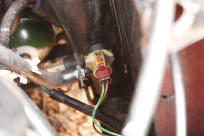

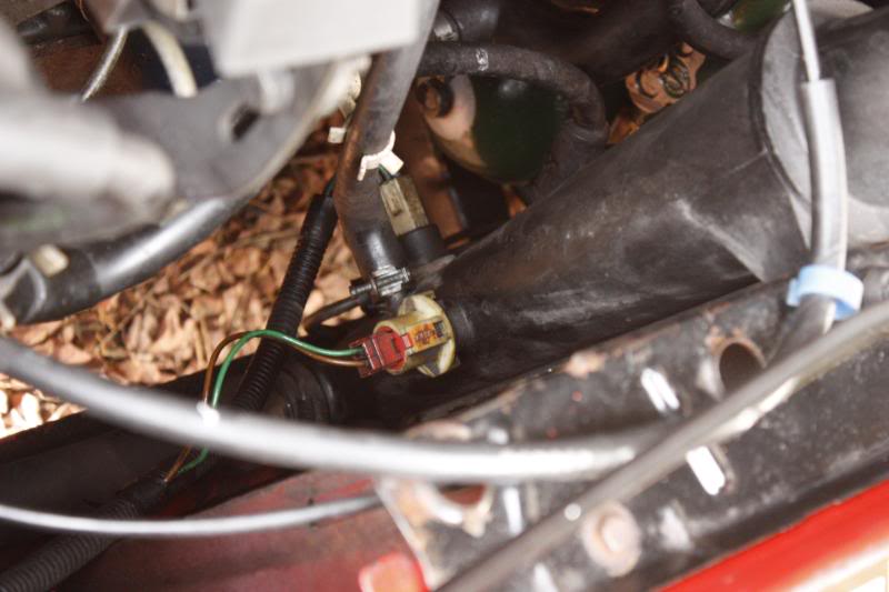

Ah, maybe I'm telling it unclearly! this thing is a 2 pin thing. looks like this:

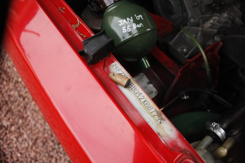

The thing in mine cetrainly does have a float and it is this float that has broken off. It now lives on top of the chassis number for some reason.

Thanks for getting back on this. Interesting that photo you've posted. It appears that it might just have the same fitting (a sort of bayonet type thing) but that the later type uses (looks like?) pair of contacts/probes that send a current thru the water that when it's too low no current is conducted?DLM wrote:If the coolant level light comes on when you remove the 2-pin, and the fitting matches up, one of these will do the job. Methinks the float is a red herring.
I think it might work on mine but when the plug is disconnected the light remains off - it will light up if you bridge the terminals of the plug and hence, I believe it works the opposite way.
Not certain why the float would be a red herring because it exists and additionally is referred to in the Haynes book as being prone to being fitted the wrong way up. So I think it's correct (for earlier BXs at least)

I'm sorry about the red herring bit, Graham - no offence meant, and hopefully none taken. I just thought that it couldn't be original as a float inside a radiator seemed like a Heath Robinson assembly - a step too far even for Citroen!
I haven't ever had need to consult that section of Haynes, as the way the Mk2 type works is so simple, and any fault normally is cured by cleaning the contacts. You're right about the way it works - the opposite way to yours.

the type Graeme has dose/did have a float, and all the float dose is whilst the float is floatting opperates a magneticly opperated switch, a bit like a house alarm system windom switch,
have a look what you have left were the float should attatch to the sendor, dose it drop off if it has been fitted upside down ???

Hi Malcolm, the float has fallen off but seems permanently broken as it cannot be reattached (I've tried!) so I'd need a whole new one.citronut wrote:the type Graeme has dose/did have a float, and all the float dose is whilst the float is floatting opperates a magneticly opperated switch, a bit like a house alarm system windom switch,
