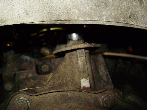

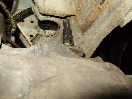

so im now at the point of removign the gear box from the car
only issue im having now is how the hell do i remove the gearchnage linkages
the work show shows where they have to be removed but down say how
so far its taken me about 7 hours to get every thing out of the way
but thats cause i was taking my time and was having a lazy sunday after noon
photos to come of the damage

i use an open ended spaner to prize of the links at the car ends not the box ends,
have you droped out the complete O/S drive shaft, if not it makes the job a lot easyer

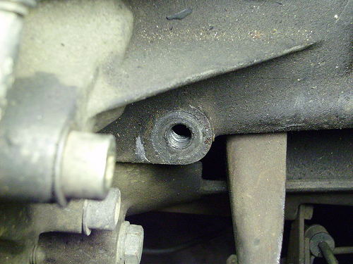

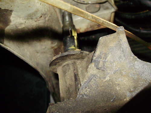

we have the issue that the gearbox/body mount bolt is getting in the way of pulling the gear box out
the left hand drive shaft has been removed but the drivrs side drive shaft has not been removed
do you think by removing the drivers side drive shaft this migth help with my bolt issue
does any one know if this is a press stud bolt or does it screw into the gear box
[/img]
[/img]-

you do need both shafts out, the O/S=right UK drivers side and the N/S=left uk kerb side, these are when sitting in a UK car,
i usualy remove the gear box hanger post/stud
