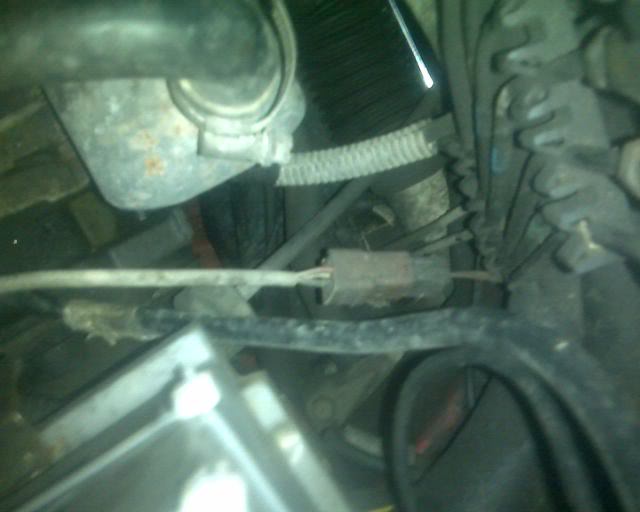

On mine it's a 3 core grey wire to a brown (I was right!) 3 way connector, I've just checked. Citroen seemed reluctant to use red wires in the loom (but they obviously had a vast surplus of green, blue and yellow) so it may be an aftermarket addition?
I have a photo which I'll try and post up tomorrow.
Here you go...the dirty grey thing in the middle of the photo!

no no, it's down the rear face of the block pointing in towards the flywheel from behind.
Get the car in the air, and attack it from underneath!
You can see it on this photo, follow the grey cable to the white sensor. (The lengths I go to to get a useful photo, guess I should put the engine back in now! :lol: )

EDIT: although the sensor itself is black, the white bit is the bracket for it.
