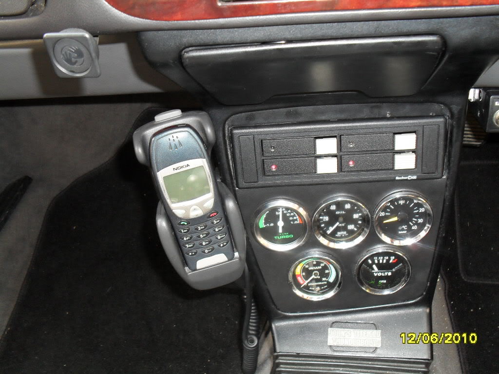

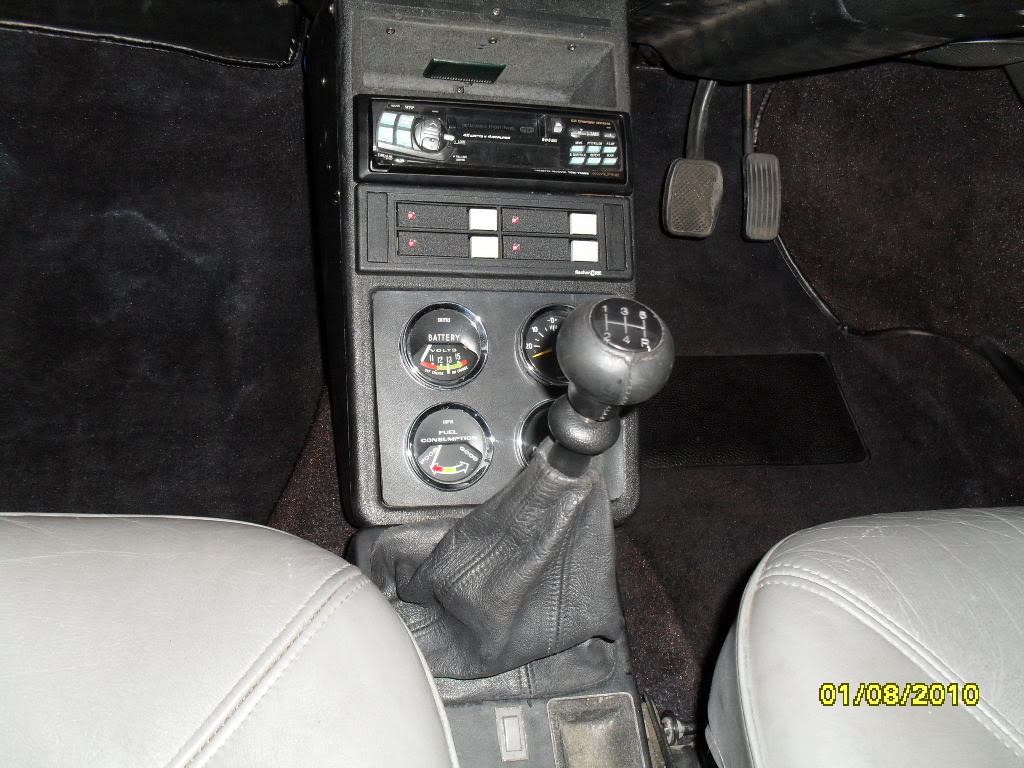

johnbird
- Posts: 185
- Joined: Thu Dec 30, 2010 9:35 pm
- Location: leicester
mr mulley that would be useful,thanks.i have a couple of a pillar mounts.the site for the temp sender is generally the trickiest part of the job.
when we were kids we used to put all sorts of gauges into our old cars,was a good lesson on car electrics. the pictures of the gti dash show an oil presure gauge too which would be smart. just fitted an old chrome dial smiths mechanical one into a custom made mount built into a centre console in the 99. nice gear lever!

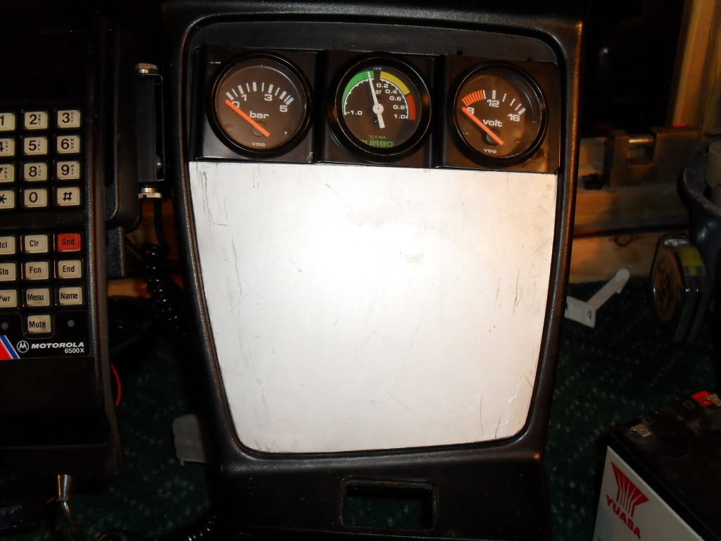

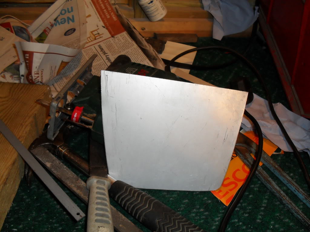

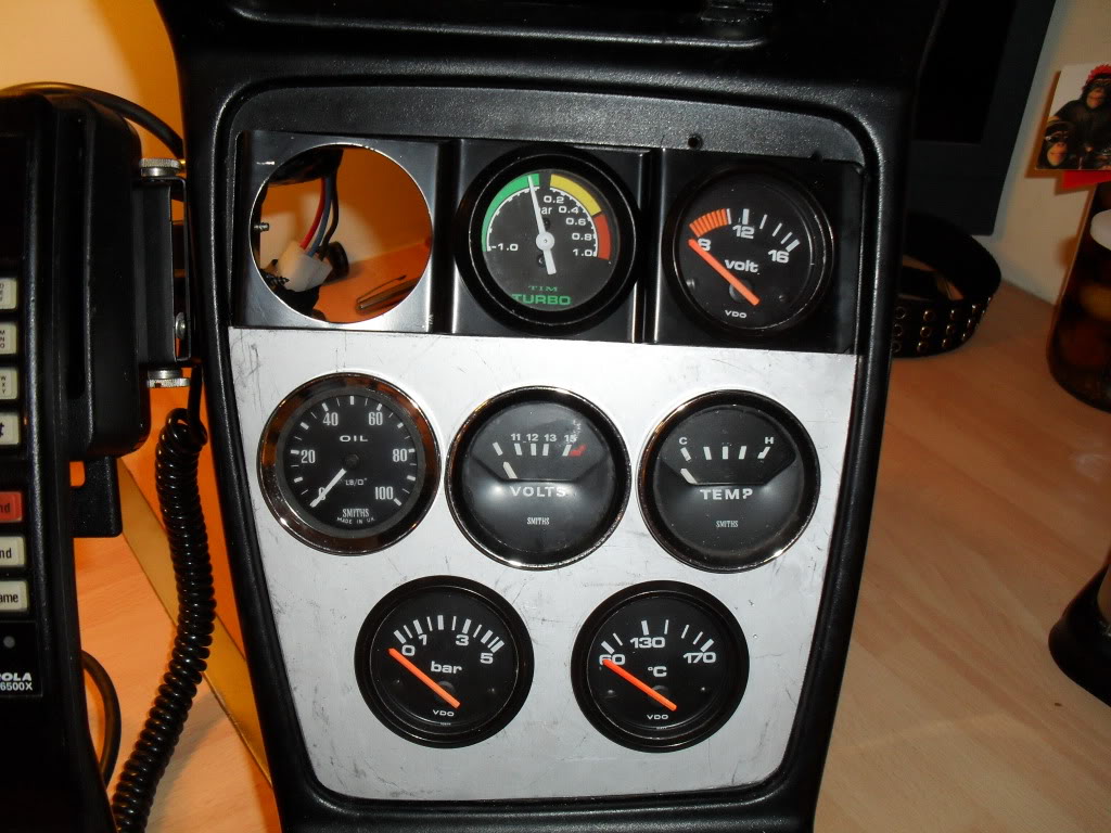

johnbird
- Posts: 185
sheet aluminium is great for making a custom panel.1 mm thick ish.i got an old sign years ago and still chipping away at it. wet and dry then solvol auto sol on a polishing wheel makes a good polished finish or cover it in vinyl like the 99 mount. its very forgiving.
from my old c900
from my old c900
