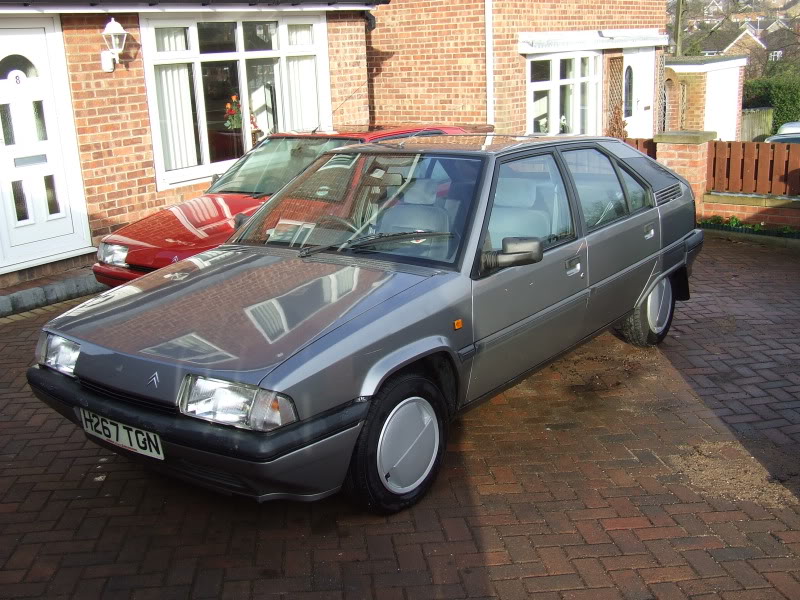

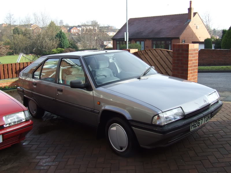

Keeping up the ebay tradition of taking pics of your car straight after it's had a bath, here's a couple of pics in the sunshine today.
The 3 scratch marks on this side can be clearly seen. These along with the cracked front bumper seem to be the only things that are leting this car down. The rest of the bodywork seems to be dent and scratch free.
and finally, here's the culprit. Changing pedal boxes on BX auto's is certainly much easier than the manual ones.
