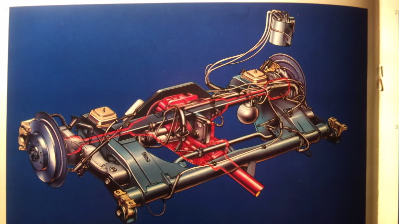

Interesting schematic, I didn't realise they only had one sphere!
Could be that it's died... it must work extremley hard!

Never seen a 4x4 405, so had no idea that it was hydraulic. Erm, does it have a hydraulic pump of sorts?

Unlike the suspension system you would see on a BX 4x4 this system is somewhat more complicated than exen the BX.How did you raise the ride height mate?
On the non 16V Peugeot 405 4x4 the ride height is controlled by the position of a variable resistor which is connected to the anti-roll bar, by a plastic link which is able to pivot. Somehow this resistance value is then transmitted to the dedicated 12V hydraulic pump mounted on the rear subframe, depending on the position of the antiroll bar. Only the Mi16v 4x4 version has an engine driven hydraulic pump.
From memory I believe the Peugeot 405 4x4 only has one suspension sphere, but it has no restrictor in it, making it look almost like an accumulator sphere from a BX.
