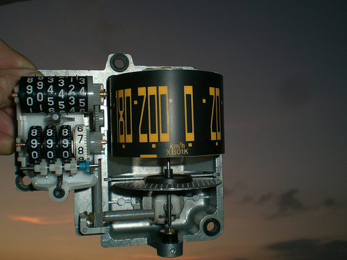

Secondly as the speedo ticks quite loudly, and the odometre doesnt work, is there a known part or cog that tends to fail. Its a mk1 speedo but am guessing its internals are the same as later models.

And the sound from the speedo - I would just open it up and take a look. It's not that daunting. I've had some strange sounds from the speedo drum which were rectified with some grease on the spindle.
If you do open it up and see anything obviously broken I have a few parts lying around as I replaced one of mine with a new unit.
