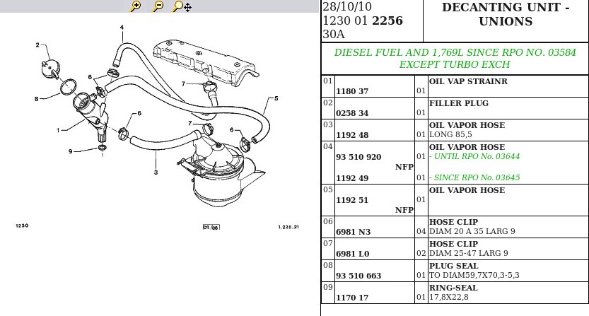

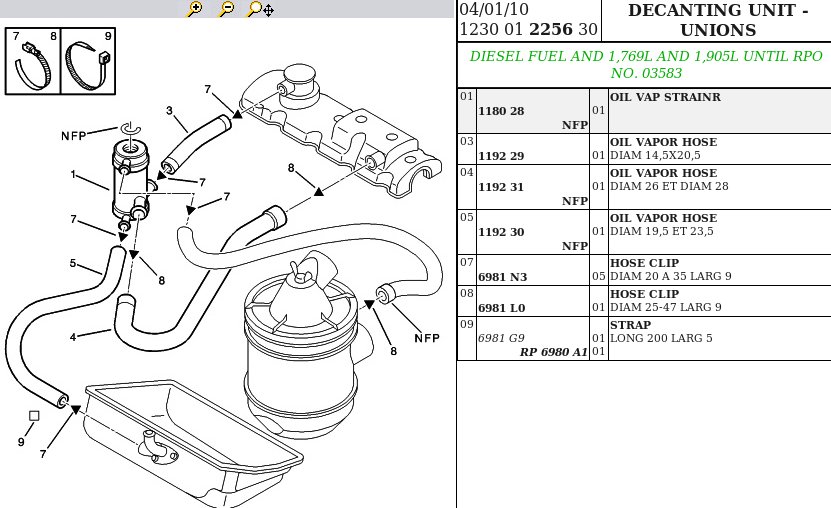

Right, this hose (number 1 on the first photo) has totally disintegrated at the end where it connects to the rocker cover. I've had to bodge it with tape and zip ties (not good!). So, I'm after a part number, or does anyone know if this is a standard hose size? (number 2 shows the delightful oil splatter and number 3 shows the seemingly ok new gasket).
The second photo shows another hose I've after, the small one which connects to the front of the intercooler.

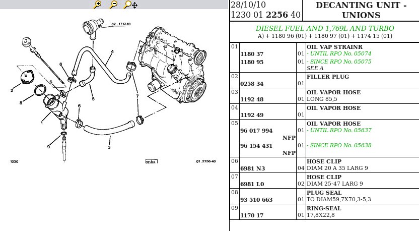

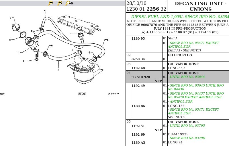

Would these help?
BX Van 1.9D -90 Gone.
BX Van 16S -90 For sale.

The first hose is a well-known bastard of a pipe to go hard and split. If you look in breakers yards on more modern XUD-equipped cars (306, 406 etc) you should find one in much better condition. Bit of a pain to remove though, as it's often easiest to remove the dipstick tube complete with this hose attached.
... and no, you can't just replace it with a length of standard hose... it's about 5/8" at the bottom and 1" at the top.
The second hose is a fair bit easier, as it's the turbo pressure line to the injection pump. That can be replaced with standard hose. 3/8" if I remember correctly.
