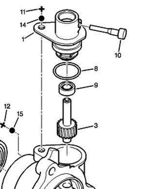

Not familiar with the GTI, but in all BX:s I've had the pleasure to encounter (diesels mostly), there has been a rubber pin (# 10 in the picture below) that must be pulled off by grabbing the thick end.

Riku's right (again).
My 1.9GT was secured with the rubber pin, removable with long nosed pliers.
You'll probably find the pin snaps off when you try and remove it - I've seen 4 do this trick.
Try wiggling the speedo cable as you tug on the pin - you might get lucky.
On my GT, I replaced the snapped rubber bung thing with a large steel split pin that I first sheathed in rubber pipe so that it was a snug fit in the original pin's hole in the gearbox housing. Once in position, I just opened up the protruding legs a fraction so it couldn't slide back out, but could still be pulled out later if required with pliers.
