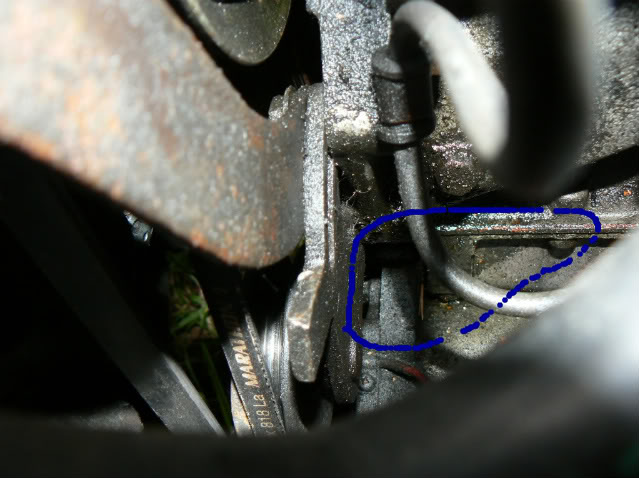

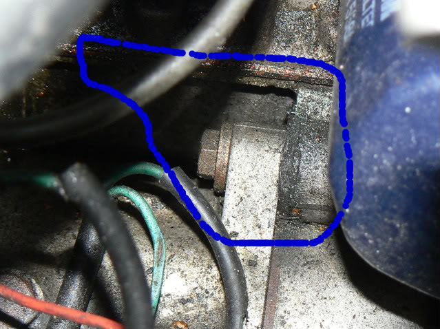

Also got a couple of pics of another BX A/C installation, where the compressor is fixed to a steel bar fitted under the bolts of a regular tin sump:
So this thing is slowly starting to make some sense after all.. :P
Noted what you said about leakage testing the system prior to installation - certainly worth considering. Have no idea of the design pressure though, but that should be easy to find out.
