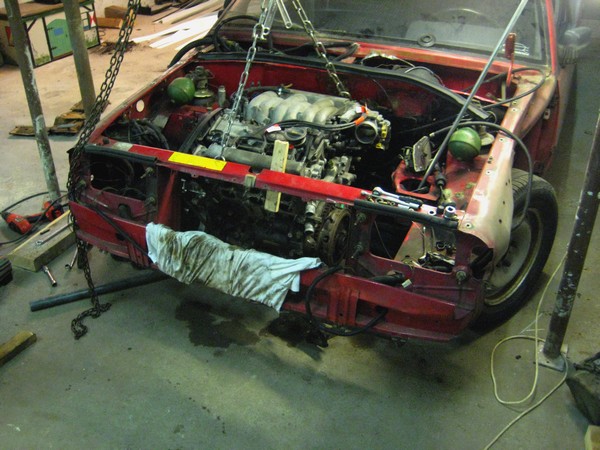

It just get's worse. (The Xantia thing that is)... having driven Jim's V6 I sort of know where I'm going to end up having to get. A 24v V6 Xantia. Well unless I find a V6 BX (has anybody been nuts enough to do that?) or an equally well appointed XM V6... There's something... well, intoxicating - about it.
