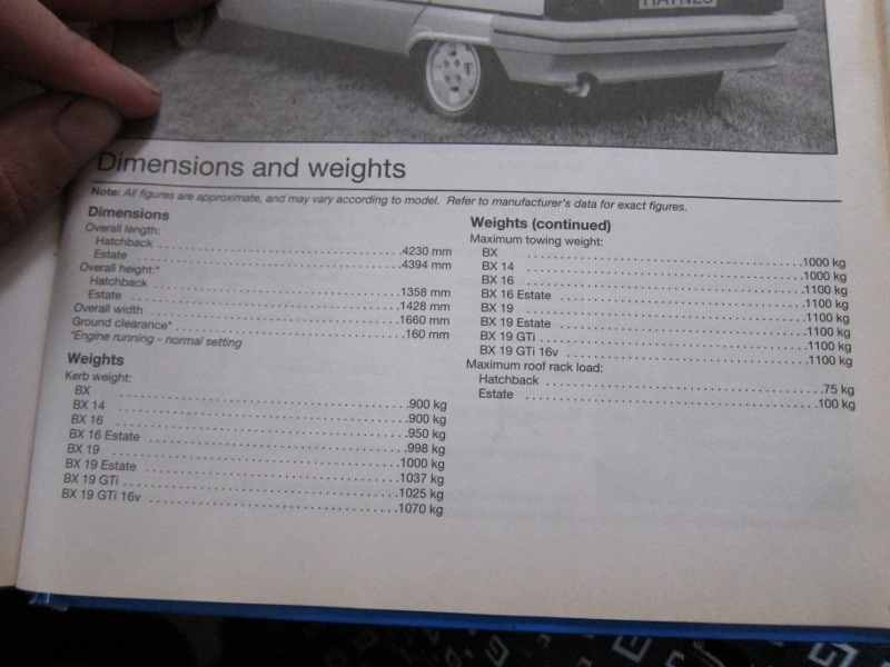

Been having house decorated and i can't locate my handbook. What is the max towing weight for a braked trl for the BX 16 valve. Looking at a caravan on ebay but unsure of weights. Thanks Mark.

OK thanks. Trouble is the Haynes manual is in the same box as the handbook which is err....

1100 kg here in Finland (495 if no brakes), but it may vary from country to country. (Usually it's lower here than in most other places, though.

Just bear in mind that those are DESIGN MAXIMUM.
In the UK the trailer can't exceed the kerbweight of the car and most BX's weigh less than that.
Fortunately the kerbweights are shown above too! (Excluding ALL diesels as they're not covered by that book but they're pretty close).
So, MAX tow weight for the 16V is 1070kg in the UK. Like i said further up, same as the kerbweight.
