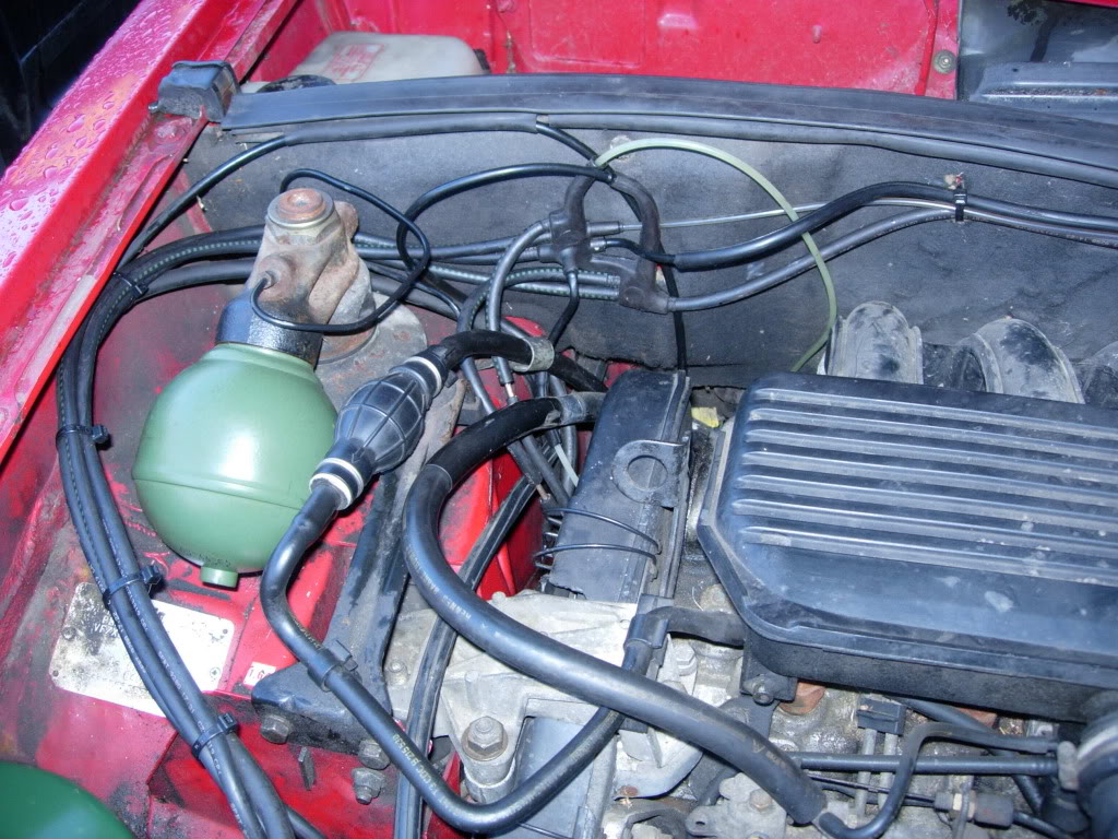

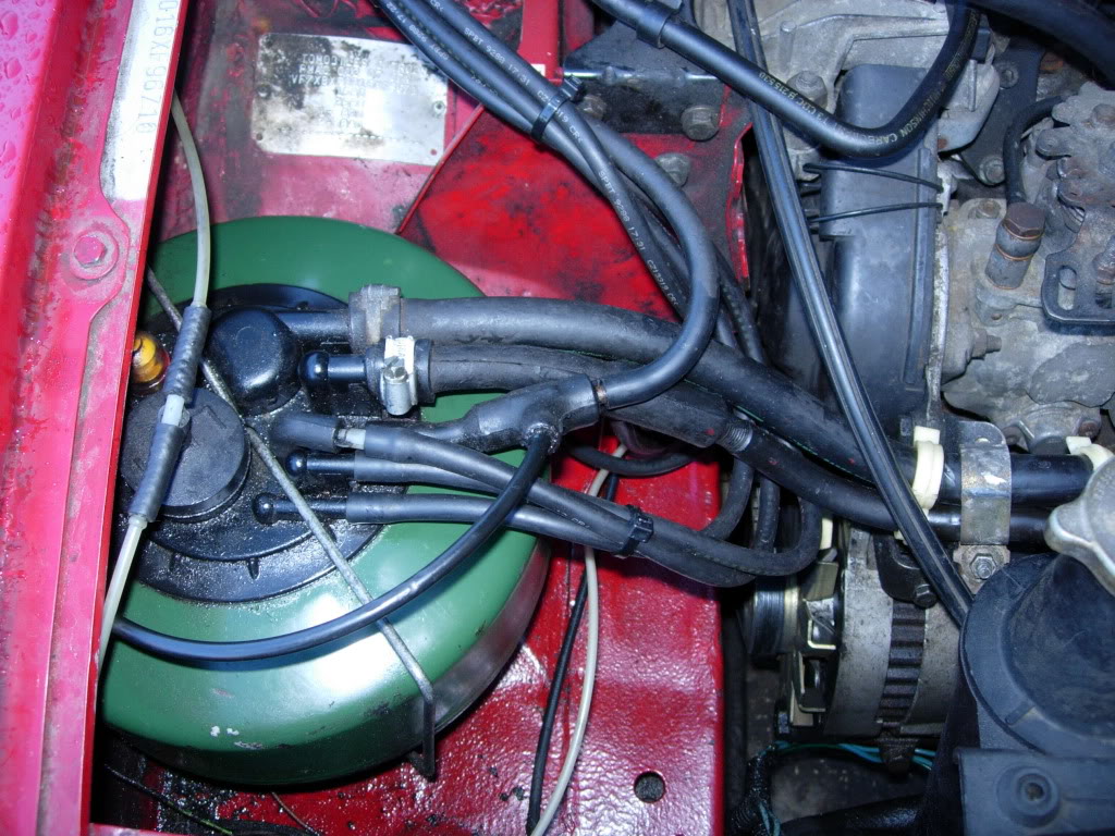

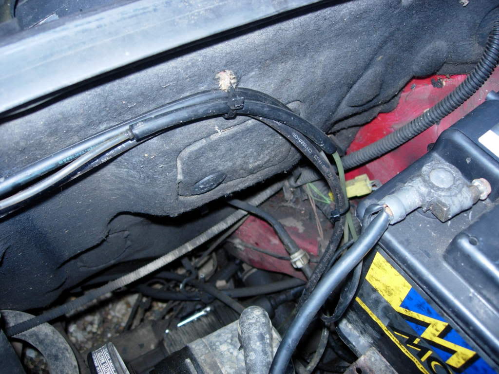

I originally wanted to bulkhead mount it (as someone did earlier this year) but veered between 'extra joints to leak' to 'accessability' etc., but in the end I thought it had to be worth it. I was surprised how many of you didn't seem to know what the pod was, where it was or what it looks like, so Andy has taken some pics which I daresay will appear with this thread as soon as he reads this. The thing is flat, all rubber, isn't bolted to anything and lies flat on the chassis crossmember. It is lodged under the front height corrector and the only way to withdraw it sensibly is forward and towards the wheel. Someone reckoned the driveshaft has to come out; it doesn't. As you need the car on ramps to get underneath you want yer wheels on. Getting the old one out was simply a question of pulling the little shit out bit by bit with pliers, after disconnecting the hoses as you go. This convinced me that never again would I go through that.....filthy job. The new octopus went on the bulkhead as you can see on the picture, and using about 3 metres of 3mm tubing from Pleiades (still going and nice helpful guys) I bridged the gaps using copper pipe offcuts which were a snug push fit to link the extra piping. The two sizes of plastic return piping needed to be extended of course and I robbed the scrappy again, but anything would do. Job done. Sounds simple but in fact I had the usual first-timer problems. Next time, with the suspension on 'high' I'll break the joints on the strut pipes before anything else, then they'll just pull off. I'll also have a much longer pair of long-nose pliers, at least a foot long; the shorter ones means you are gripping them just where the strut and axle gubbins get in the way.
The octopus is mounted on the bulkhead liner as it weighs nowt so no need to drill holes in metal. The copper bridges don't leak; if they did a smear of superglue when fitting would sort that. As far as 'where does everything go?' the colour diagram available on this forum is all I needed

Here is a pic of the bulkhead mounted octopus.

Another one

Job done.

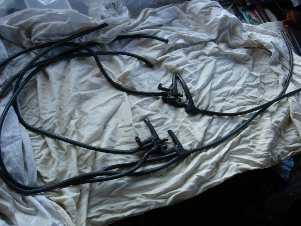

Here are a couple of 'used' octopi, the really horrible top one came from Tim's motor.
