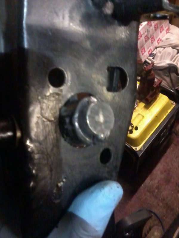

When I first asked about it I was told quite categorically that it was only Xantias which had it, although the 3 (late) BXs I've owned all had it. It's possible it was softer and hence more obvious on Xantias? It's beneath the plunger I've got my finger on it this picture:
To stop it compressing when I press the pedal I just put a couple of blobs of weld on it, as shown in this fuzzy photo.

obviously one of those senior moments again
as i didn't remember that device till seeing the picy's
