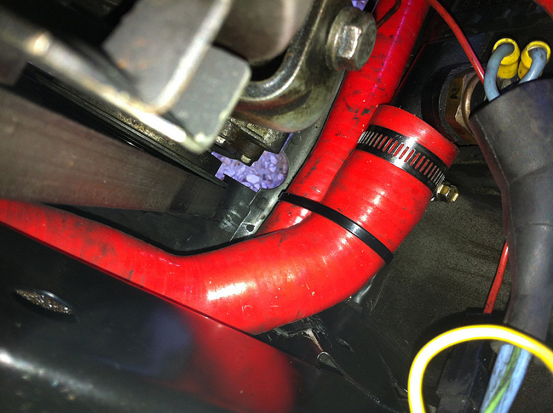

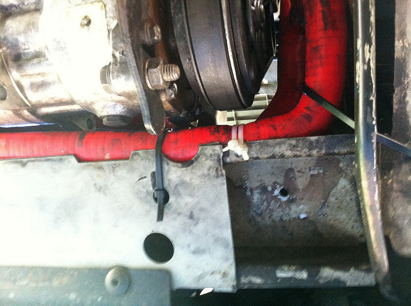

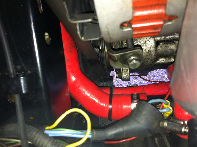

I had another look at this and decided to tie hose 14 to hose 6 near where 6 joins the radiator. This has moved hose 14 up and away from the pulley which should fix the problem I had.
Untitled by tyro.chris, on Flickr
This is how it was routed when it rubbed, sans the white ties. It now sits a bit higher and more in under the radiator.

That looks considerably like mine. The hose that is rubbing for you is sat on the metal cross rail under the radiator. Mine is only held there by the standard plastic tongue thing

i would add a length of split tube along the edge of the front cross rail as well, to stop that edge cutting into the hose
