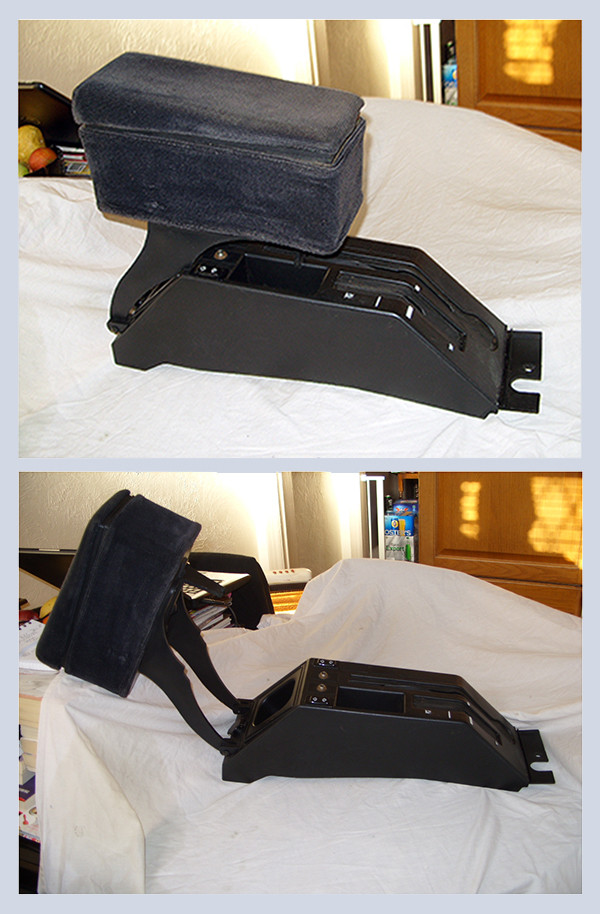

Take the headphone jacks out and it bolts into there. I can get a pic if you need.

Hello, A picture would help me as I'm completely lost on this also the hinges are on the left hand side. Alan

Hi Alan, Hope these might be of some use? I can take some more pics if there's another shot that would be more helpful.

Hello again, When I look at my console like your photo I have 2 studs or what ever and ear phone jack in the middle is that the same as yours have you got a photo showing fitting cheers. Alan
Re: citroen bx 16v center arm rest.
I think the jack in the middle is a DIN socket not a headphone jack, and you may just have blanks where the headphone sockets should be? I'll go and take another photo tomorrow.

Hello all, Big thanks to you all helping with center arm rest fitting decided to remove the two studs o n the console just undo and leave in there then fix arm rest . also where are the drain pipes from the roof getting a bit wet inside drivers side front sorry if don't make sence I'm new to this. thanks a lot . Alan
